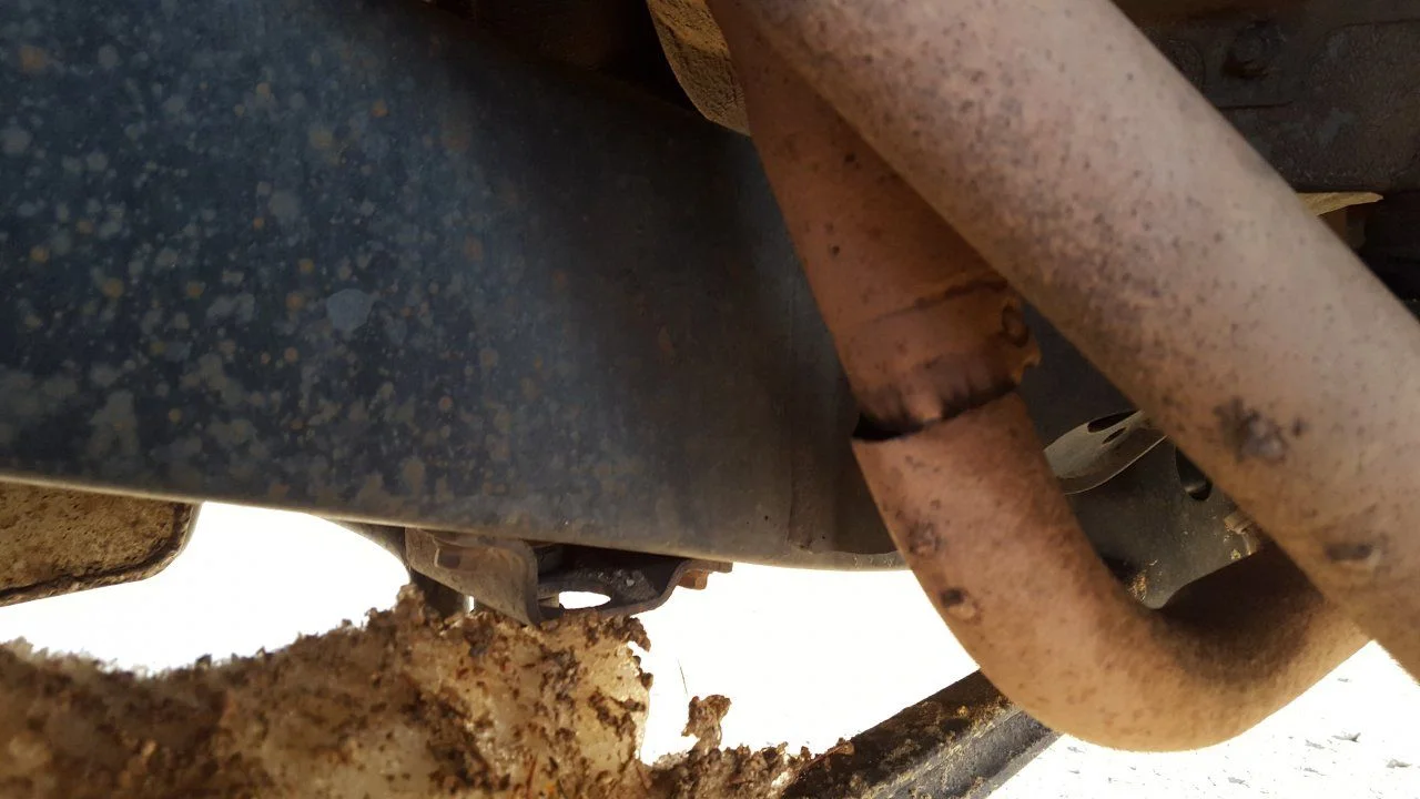

I had a blast yesterday. I took a bunch of video and I will try to edit/post up soon. Unfortunately, my exhaust took a beating from running hard and getting sprayed with a bunch of snow. I got to i25 and garden of the gods on the way home from the run and it let go...I'm thinking there is some flowmaster and lots of welding in my near future.

Wow. It was probably more from the motor torquing from side to side on the mounts. I'm pretty good at exhaust work if you need a hand. I installed the systems on both my Toyota and my Cherokee. I highly recommend the flowmaster 50 series. The 40 and 44 series are just obnoxious with the droning. I have a 50 series on my Cherokee, as well as every other 4x4 I've ever had. Love the way they sound.

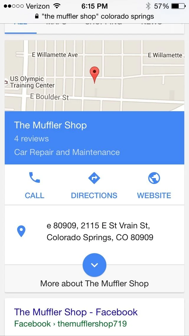

Rodney had his done at a place called the "muffler shop" on St Vrain. He got a generic magnaflows, a high flow cat, and all the pipe installed for $250. Really professional job. Have to weigh all the options. with how thorough you are, you'll make the right choice.
