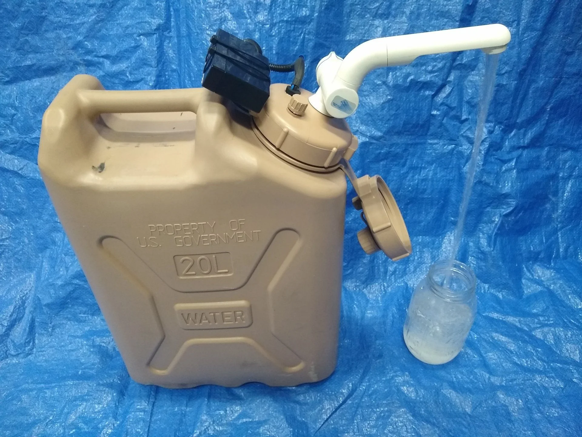

For many years I have been using a marine hand pump faucet on my Scepter military water container, but I decided to save myself some calories and go electric. This idea was stolen with pride from a similar setup as described here: 12-volt water system - Scepter installation. A video was later made describing the build:
My version makes use of a portable attached battery vs. being hard-wired into the truck or using a cigarette plug.

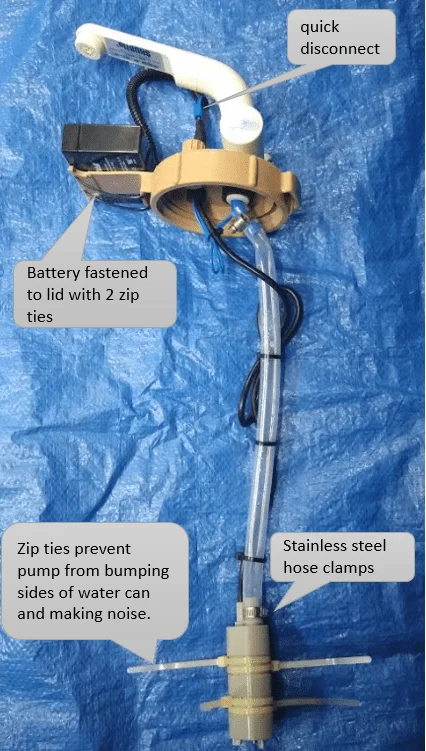

The battery is a 12V AGM lead acid, so it can be recharged with an ordinary automotive battery charger. Following the instructions from the above posted links, but adding a battery I came up with this.
And alas, a beautiful flowing stream!

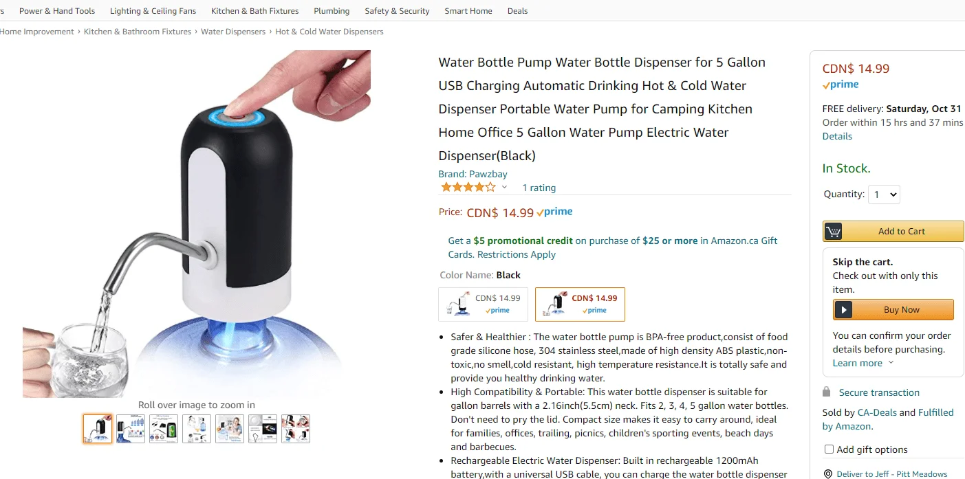

Saw one of these USB powered pumps on another forum, they work quite well.
edit: no idea wtf is going on but it wont paste in an amazon link for some reason, so screenshot it is
Have you had a chance to determine the run time or gallons on a charge?
The pump is rated for 10 liters/minute max. I am seeing about 3.8 liters per minute (which is 1 gallon per minute). As the battery drains the flow rate decreases. I pumped 10 gallons of water and the flow rate had slowed a bit (0.9 gallons/minute) but was acceptable. The battery voltage had dropped to a little over 12V, which is around 50% charge for an AGM battery. You really don't want it to get lower than this if you want to maximize battery life. So I would say you can pump 10 gallons before needing to recharge or swap batteries. Note that the battery referenced in my first post for $18 came as a 2-pack.
