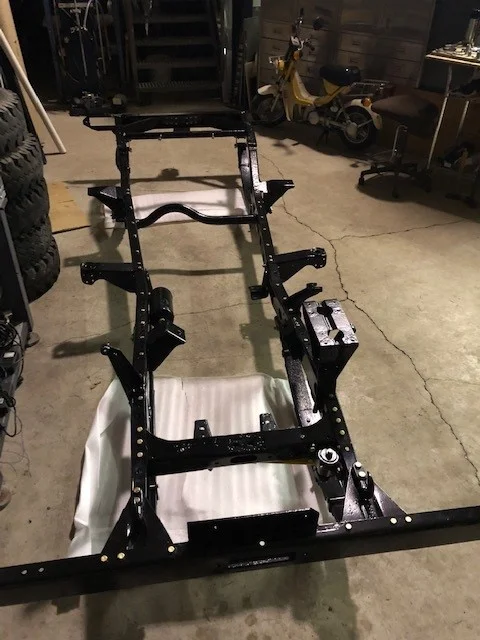

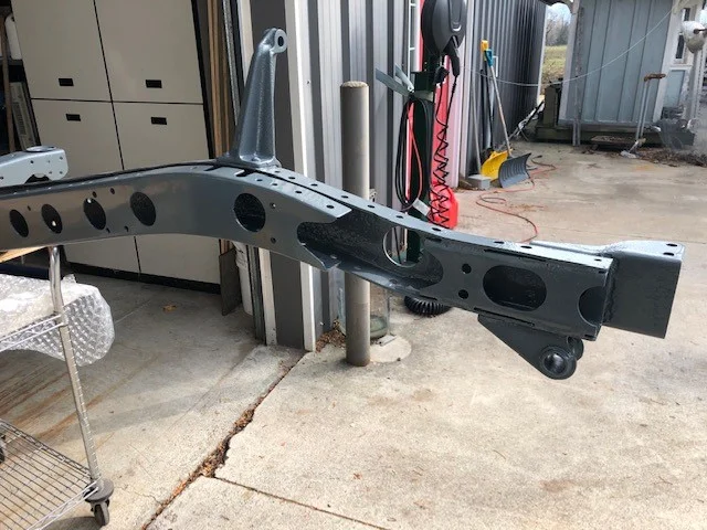

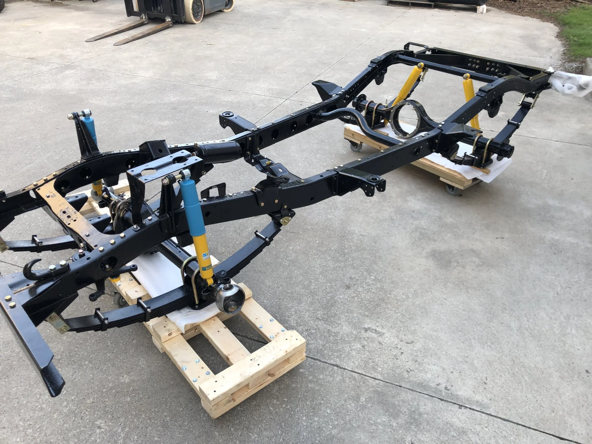

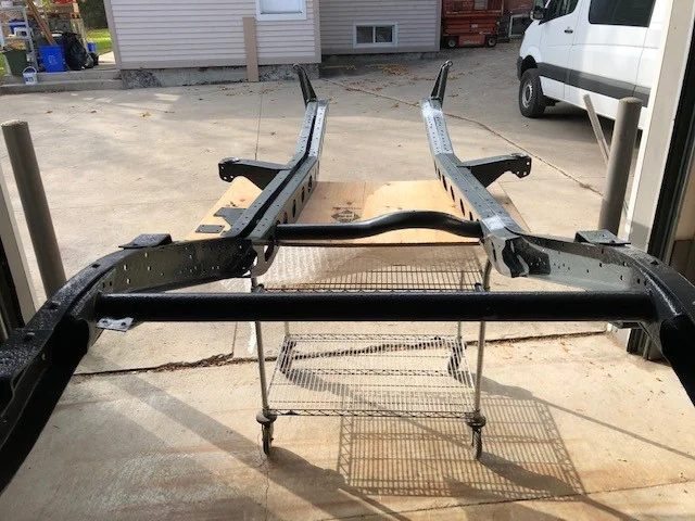

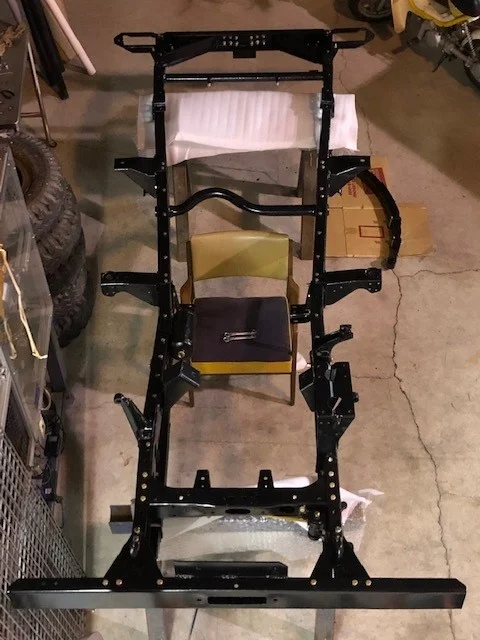

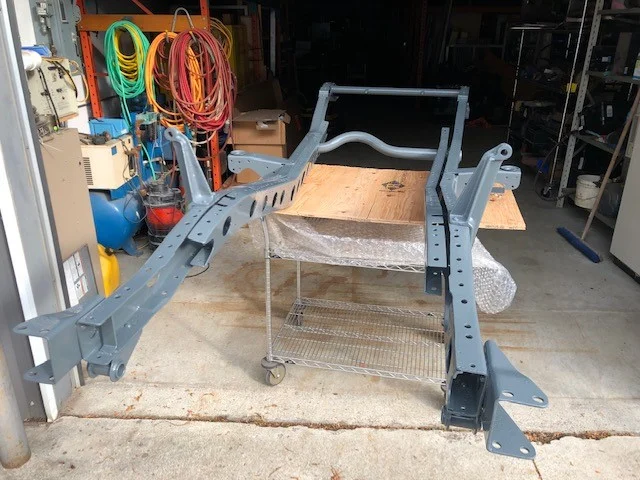

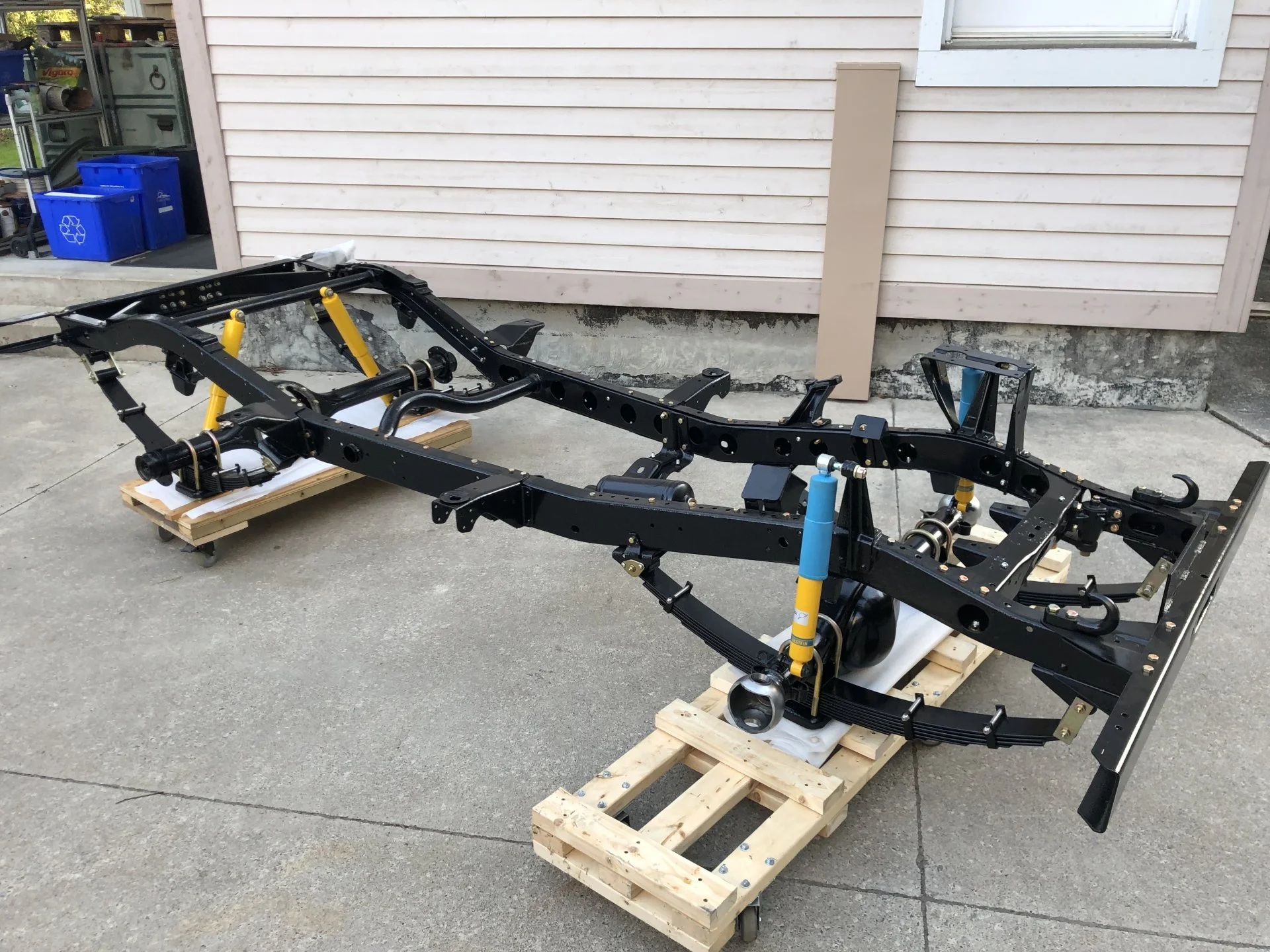

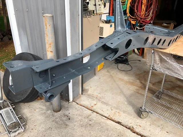

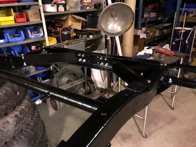

To those interested in following my build, I haven't updated in a long time and have been meaning to post pictures. I've gotten far since the last update and wanted to show it off! Since posting last, I've fitted my fabricated frame rails and bolted the frame back together. A good 3B + H55 has been purchased with the mounts all put into the right place (lots of test fitting).

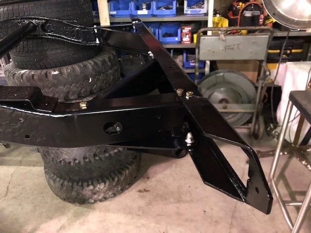

Almost all of the rivets in the frame have been replaced with new grade 8 hardware because I had to take it all apart for repairs.
The whole frame is dual-coated powder coat with primer in the frame rails before fitting! A bit obsessive, but I am avoiding rust as much as humanly possible.

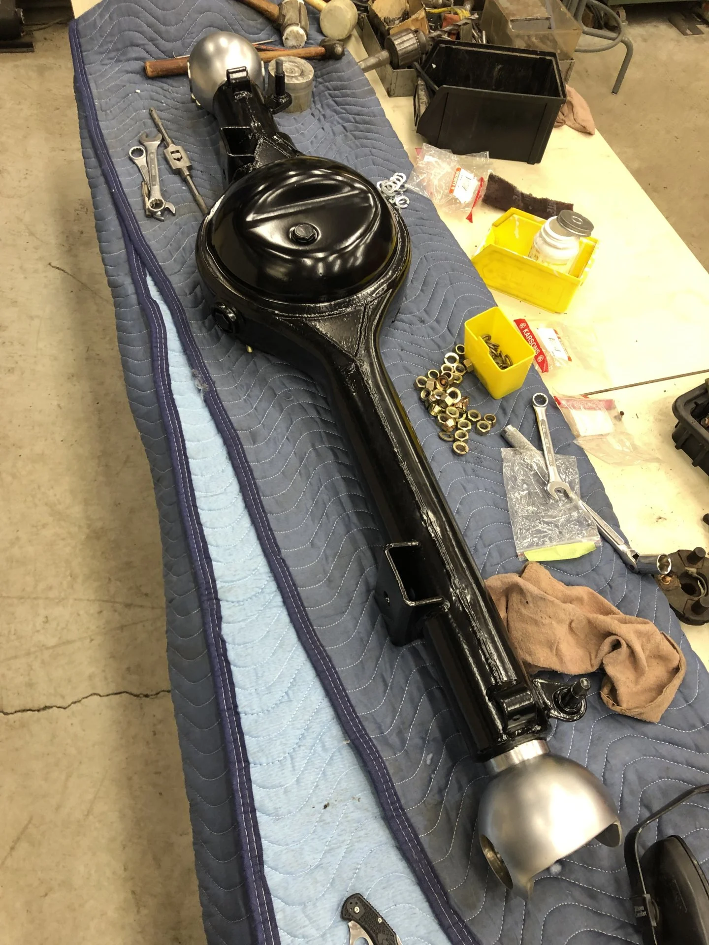

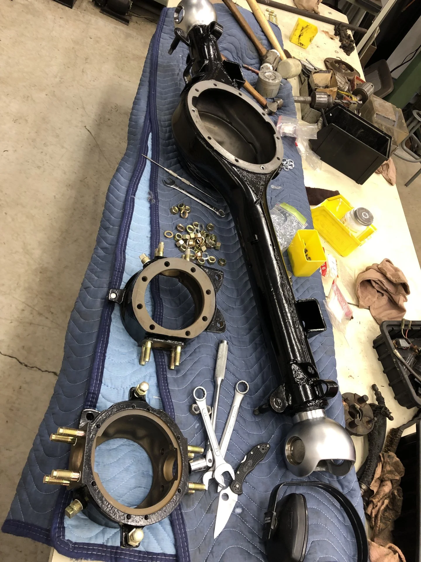

I've powder coated the rear axle and am getting a new axle housing for the front with shiny chrome ball joints. Will update again when the axles are on and engine is in.

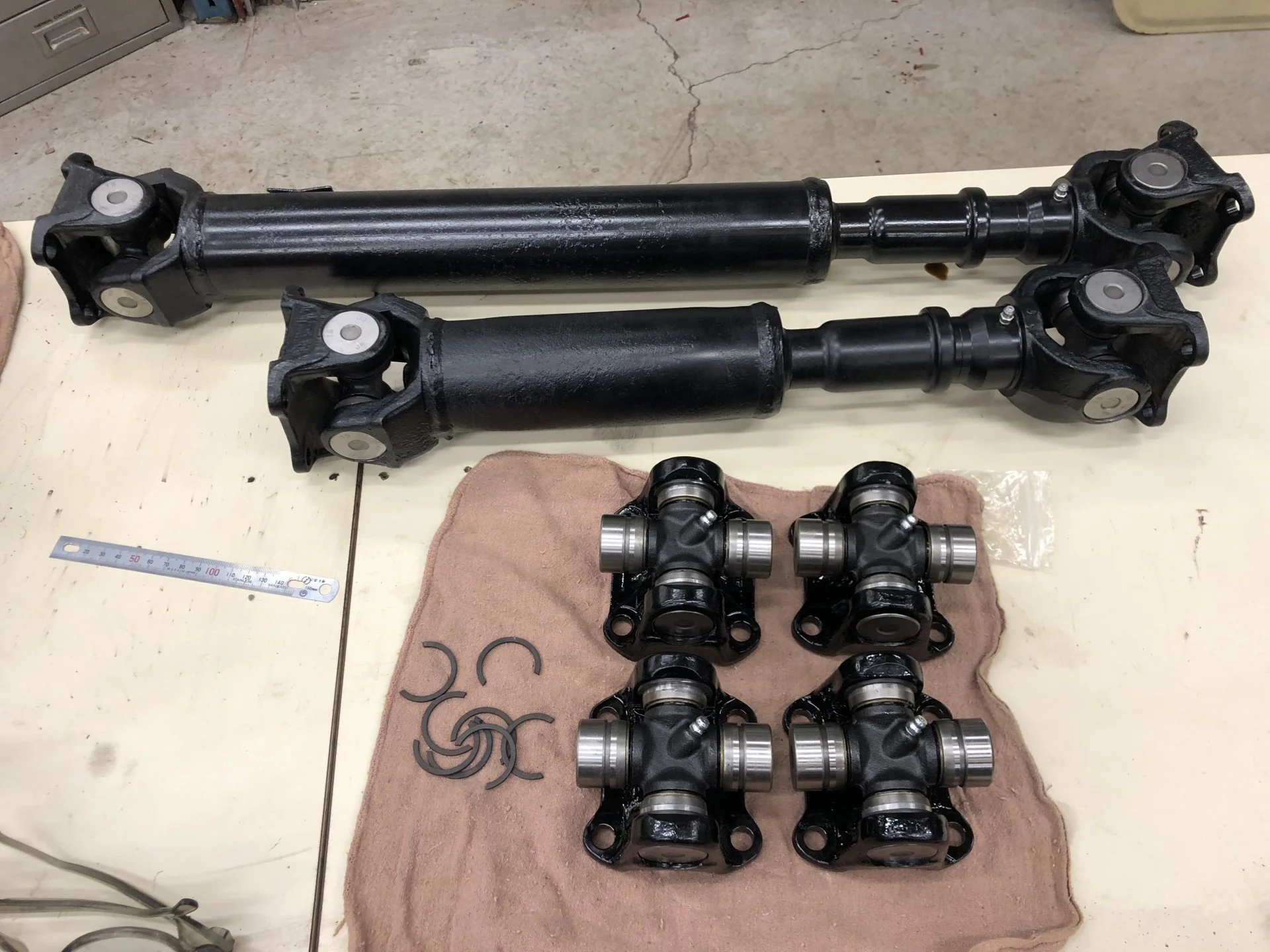

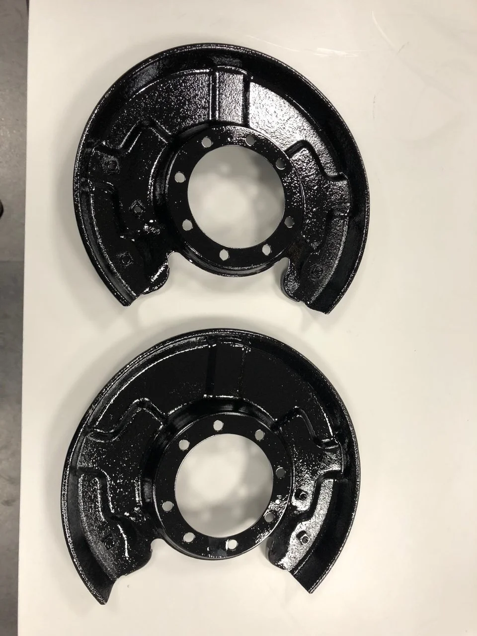

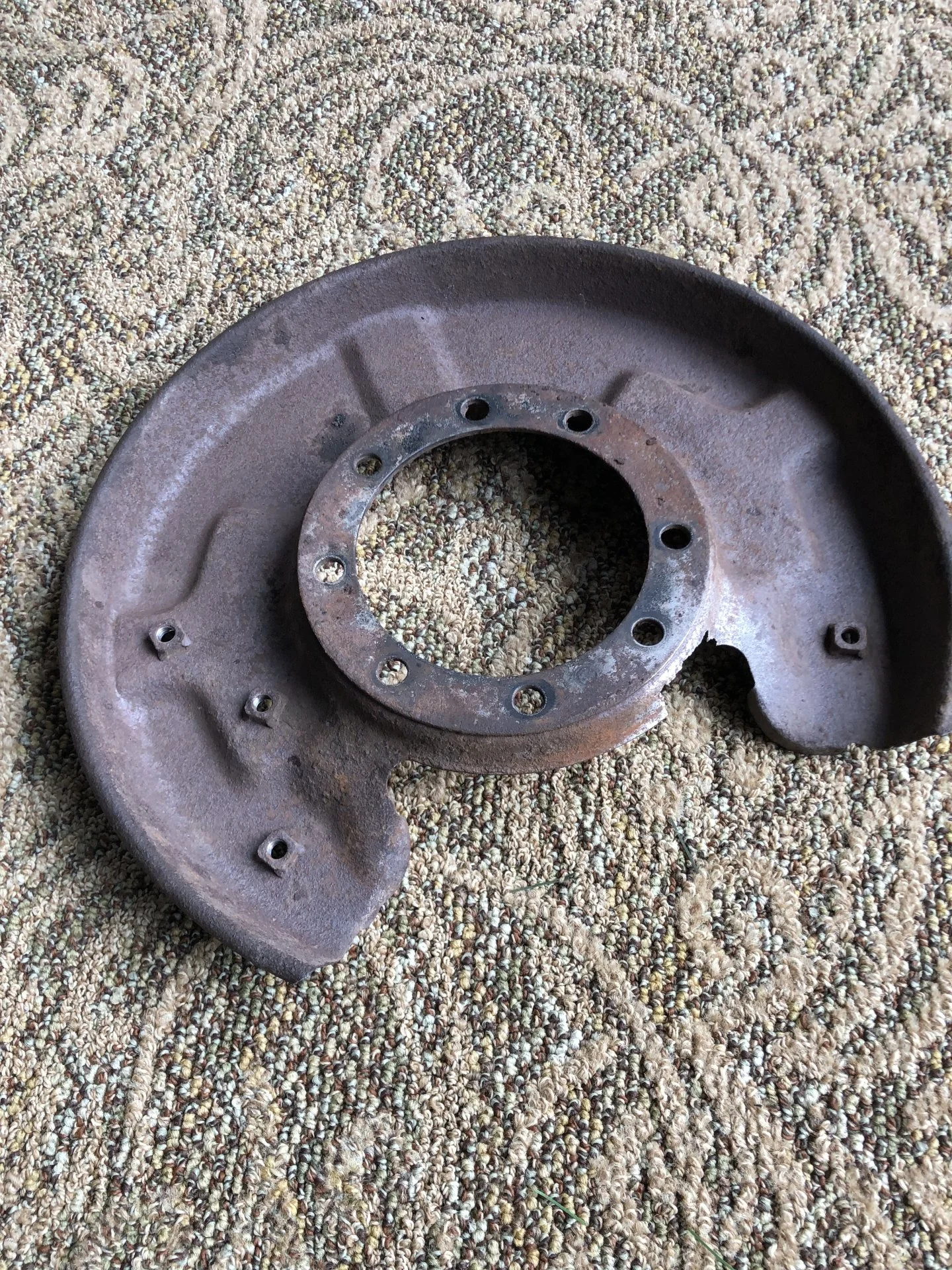

At this point, I've been sending lots our for yellow zinc plating and working on the front axle complete rebuild. Body panel purchasing will be soon so I can eliminate any rust in the seams. Thanks again for the support from everyone! If you're an Ontario cruiser owner, please reach out. I'm always looking to meet others with the same obsession and any advice is very welcome along with trading for / buying parts. Especially welcome is advice on how to do my rear disk brake conversion with parking brake. Cheers!

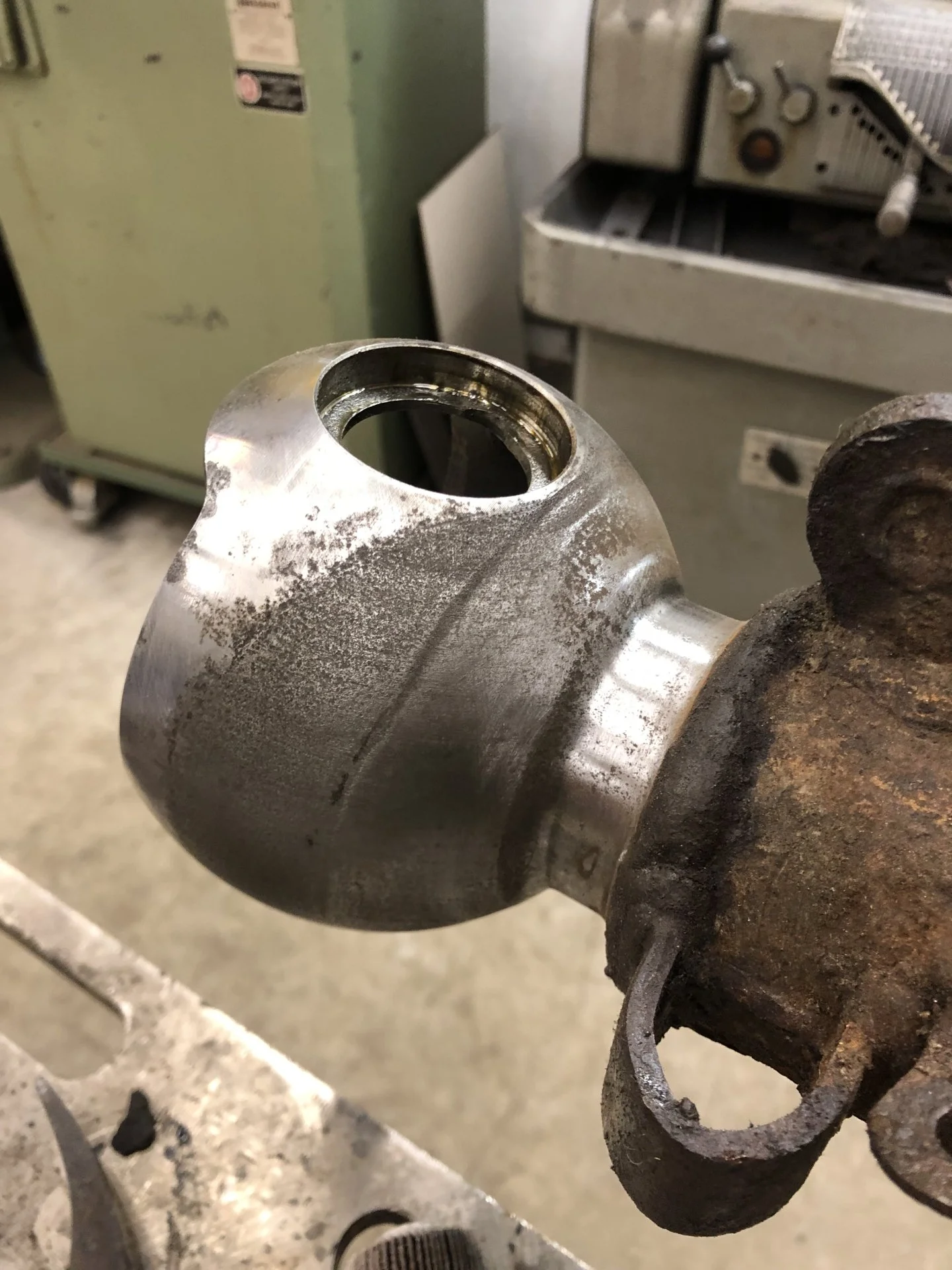

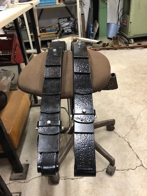

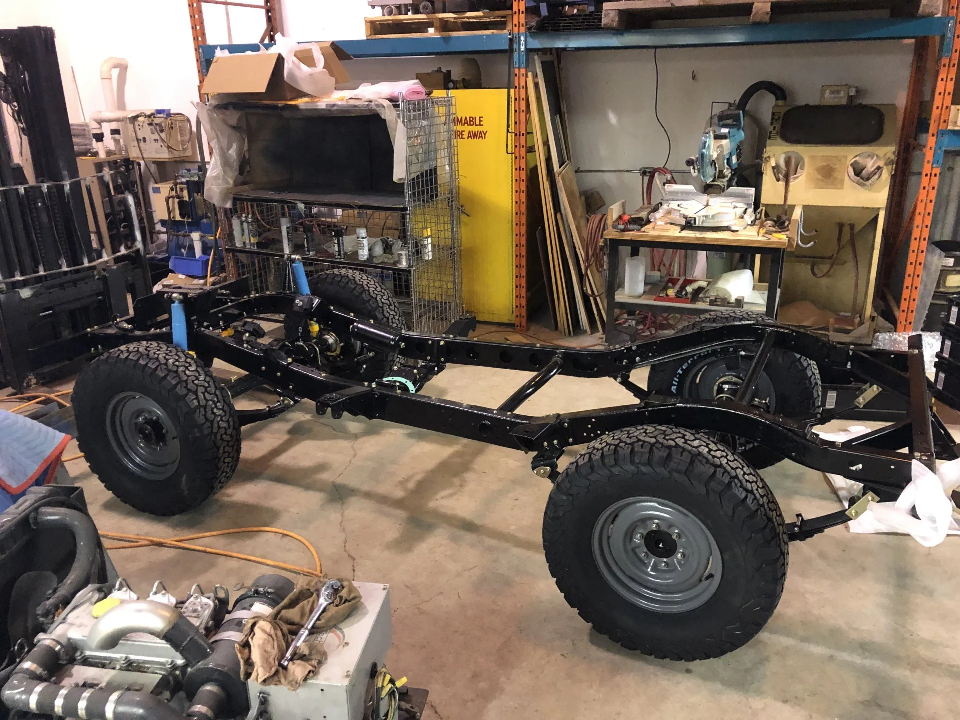

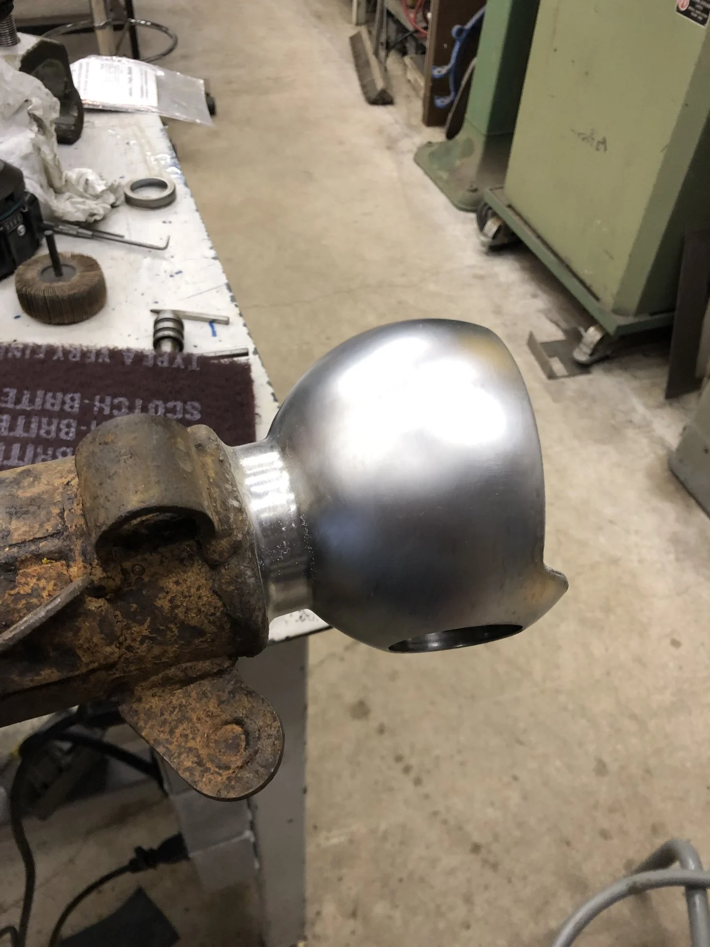

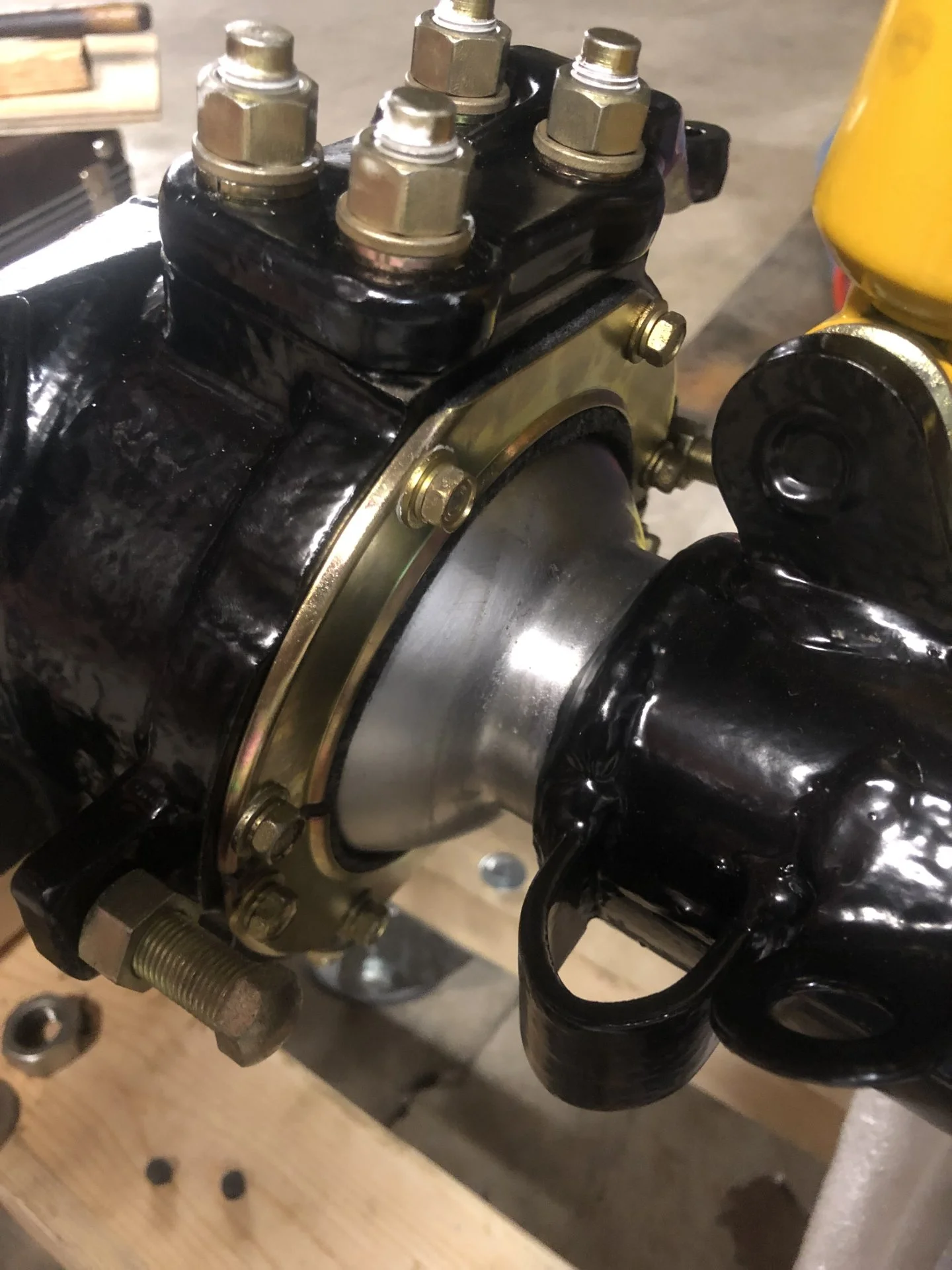

Update on the build! Hand finished knuckles and resurfaced them with sandpaper. Hard chromed to keep dirt & debris out of the birfields for long life. I have set the knuckles with an alignment tool and the differentials are in with backlash and mesh patterns set. New shocks finished it up nicely too :) We're finally getting to a point where I will fit the wheel rotating assemblies and get it rolling!

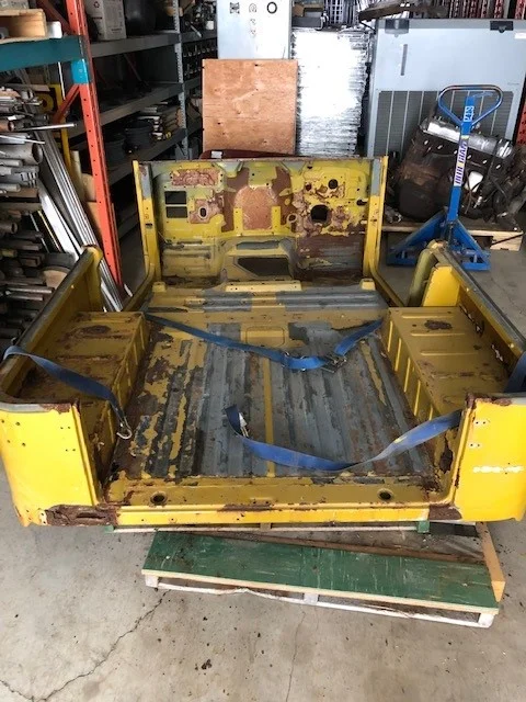

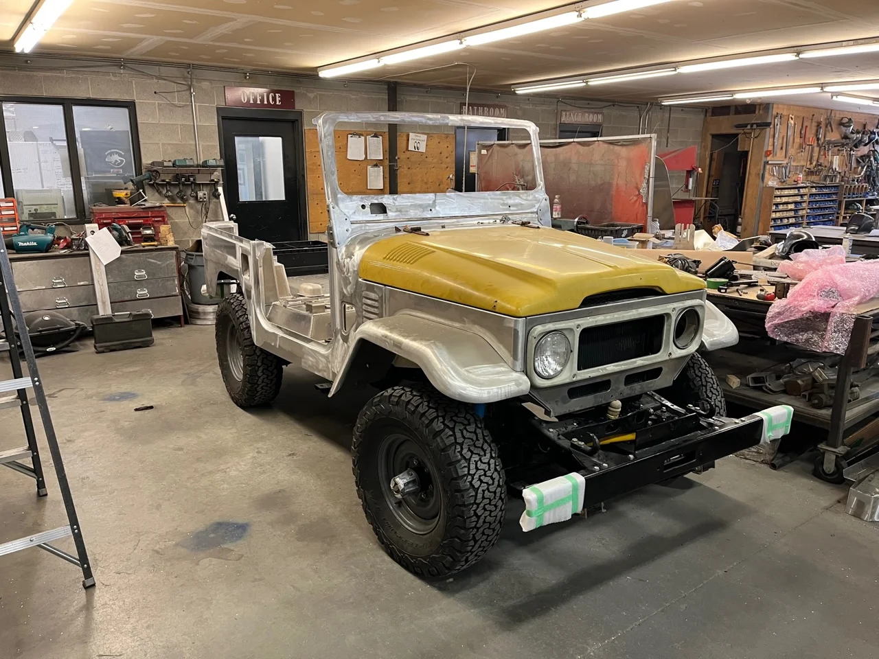

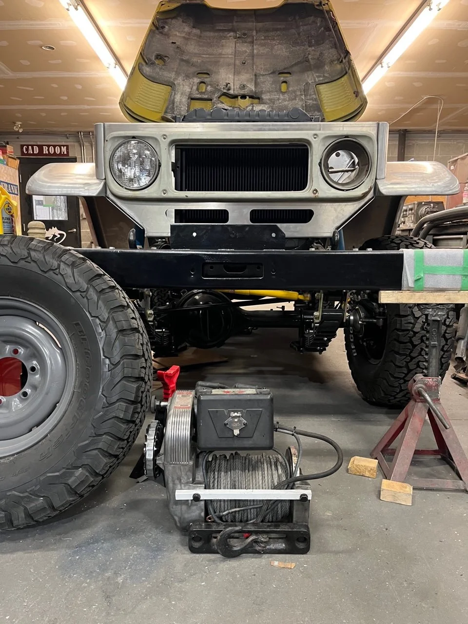

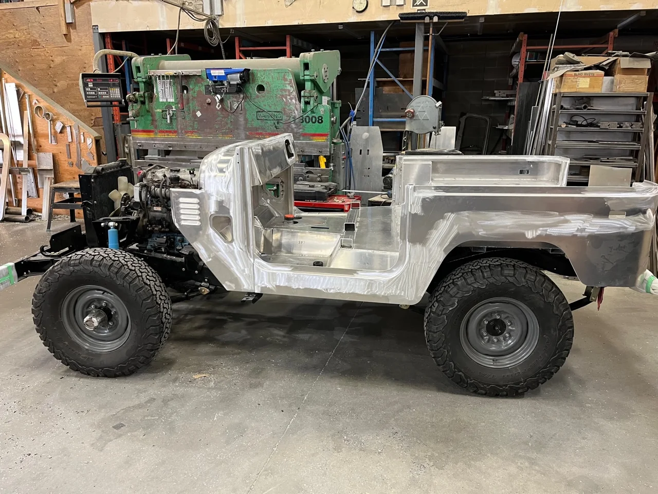

To anybody wondering if my project is still happening, yes it is! Since posting last, I've had an interesting chapter in my life start. I went to visit Aqualu in Kelowna, BC and ended up getting a job doing design work with Todd. I've since moved to Kelowna and brought my cruiser with me! It was a long trip with a lot of nailbiting moments, but proved to be all worth it when I got here. I am proud to say I will be fitting an Aqualu body kit on the cruiser in our shop. I'm using my obsession with detail and my want to keep everything very close to stock to improve the aluminum tub design and build.

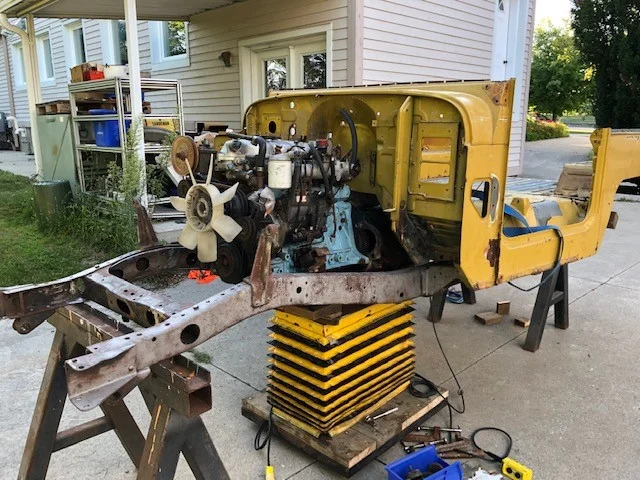

Since getting here, I've removed the old body and have fitted the new tub with bib, fenders and aprons. I'm scrutinizing it while it's fitted, and I will be making one of my own design with some revisions and alterations to bring it as close as I can to capturing the original details of the landcruiser.
And the awesome new (to me) 1979 Warn 8274 fitted. And believe it or not, it was made only one month before the truck came off the assembly line.
And once again, showing off the knuckles. I'm very proud of these as they took so much time and effort to get right.
Stay tuned for more updates in the next couple months as I build the tub I will be fitting. There is a list of improvements I'm making and details I'm ironing out. I am thinking I'll start a new thread going into lots of details on the Aqualu tubs. I'll point out the things that I have changed and will be looking for comments from others with experience putting Aqualu product on their rigs. Feel free to send me a PM if you have experience with this and some improvements you would like made to the tubs!
