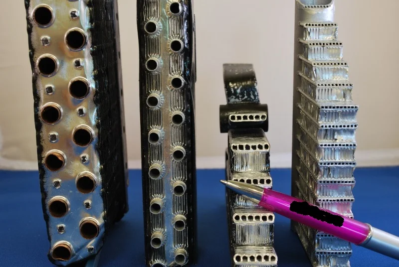

How does a condenser typically fail? I'm assuming plugging from debris. Learning as I go here. My compressor didn't fail internally. My clutch bearing was going bad. Hopefully its just the valve. I'm going to replace the expansion valve and try again.
Correct. Depending on Condenser construction....the 'tube' openings can be quite small and easily clogged. Stop leak products come to mind first.

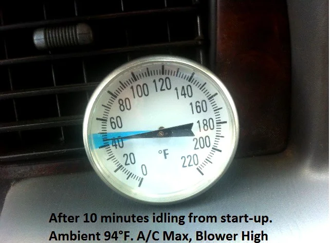

Your high side pressure does sound normal. But to expand on High and Low side pressures:
1. The main purpose for using a manifold gauge set is as a diagnostic tool to determine the relative health/function of the system.
2. High and low side pressures give us an 'idea' of where we should be within (windows) with respect to the refrigerant charge since we know the temperature/pressure relationship of a given refrigerant.
3. High and low side pressure readings are most beneficial when you are charging a partially filled system since we do not know the exact amount of refrigerant (by weight) the system contains.
4. Ideally....we would want to start with a completely evacuated system and then WEIGH in the refrigerant amount.
This will always be the most accurate method to fill the system.
5. The FSM will suggest certain pressures but can't account for every local condition the vehicle is under. Further....it asks you to look for the presence (or lack of) bubbles in the sight glass. I would completely dispense with the latter method unless you are way out in BFE and have no tools of any type.

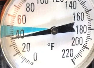

6. My goal when doing my own A/C work is to achieve the best 'Vent Temps' the system is capable of under given ambient temps. To that end....I will take the time to add or subtract the refrigerant charge by small amounts while monitoring the vent temps. As long as the high and low side pressures remain within safe limits....I give them no further thought. There simply isn't an 'ideal' number you should be at. Only 'windows' that are considered normal and safe.
In summary...I am not saying ignore manifold pressures. I am just saying they are not the final word with respect to best system performance. Too many variables to be considered. If you have the luxury of starting a with an empty system, then 'weigh' in the initial charge. IF this gives you satisfactory vent temps, you're done. IF you want to fine tune the system, add or subtract small amounts and you'll find the spot of diminishing returns.

Good info. Thanks. I added 860g yesterday. It seems to be cooling fine. I will get some vent temps soon. Hopefully, this new expansion valve won't stick like the old one. I do think the old one was the original. It was a denso part, and I didn't see any evidence of someone being in there. I also replaced all of the foam gaskets on the evap box. They were falling apart. I could not feel any leaks around it once reinstalled.
