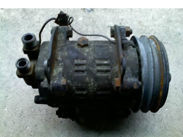

The one I have is a "sanden style" piston compressor with a york mfg plate on it and has an oiler. I'll post a pic when I get a chance. They look like modern coolant pumps that still use oil instead of refrigerant to lubricate.
They use them in Aus. and such so I know they work it is just gonna be a hastle to make the mount.
This is it. Couldn't get the tag with the camera phone.
It says, York Automotive, Div. of Borg-Warner Corp, Diesel kiki Co. ltd, Japan, MFD 644, Part # 488-22027.
I couldn't find any info on it, it any of you could I would appreciate it.

I have this same pump and want to use it as onboard air also. The link to the other forum does not work for me. So did you guys find out if this pump works as an air compressor? do you have to modify the compressor at all?
Thanks
