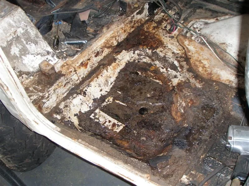

Pulled my tank to get the transmission hump out, and to try and fix the stinkin gas smell.
Found the entire area underneath the tank cover packed with wet mud, and as a result the sheetmetal around the tank has the worst rust on the truck by far.
A sandblaster would make short work of this rust, but I don't have one or the funds to buy one. I do have a compressor big enough to run one.
Does anyone have a sandblaster they would lend or rent to a member so I could get this one-time repair done?

Note:The worst rust is under the mud in the picture that has now been removed.

What is your timing and location? I am out of media for my blaster and have not had a chance to restock, but it is portable. My compressor is 16CFM (@165 psi), but I only run the blaster at 95psi so even a smaller compressor can get by for a small project.

You know you can get a cheap one from Lowes for about $40 when we go one. Basically you hook up the air and stick the feeder hose into a bucket of sand and there ya go. Not the best of things but I did sandblast many things with it.

A 4" knotted wire brush on a grinder would take care of that faster & better w/ less mess. That's a small area I wouldn't fool w/ a blaster for the trouble. Now, if you were doing a body, frame etc. that's different. Did you read my offer on the other thread you started about the seat cradle?

I tried a wire brush and composite rust stripping wheel on some of the rust, wasn't working too hot. I thought about a knotted brush, but didn't have any handy. I'll try one before I bother Larry.
