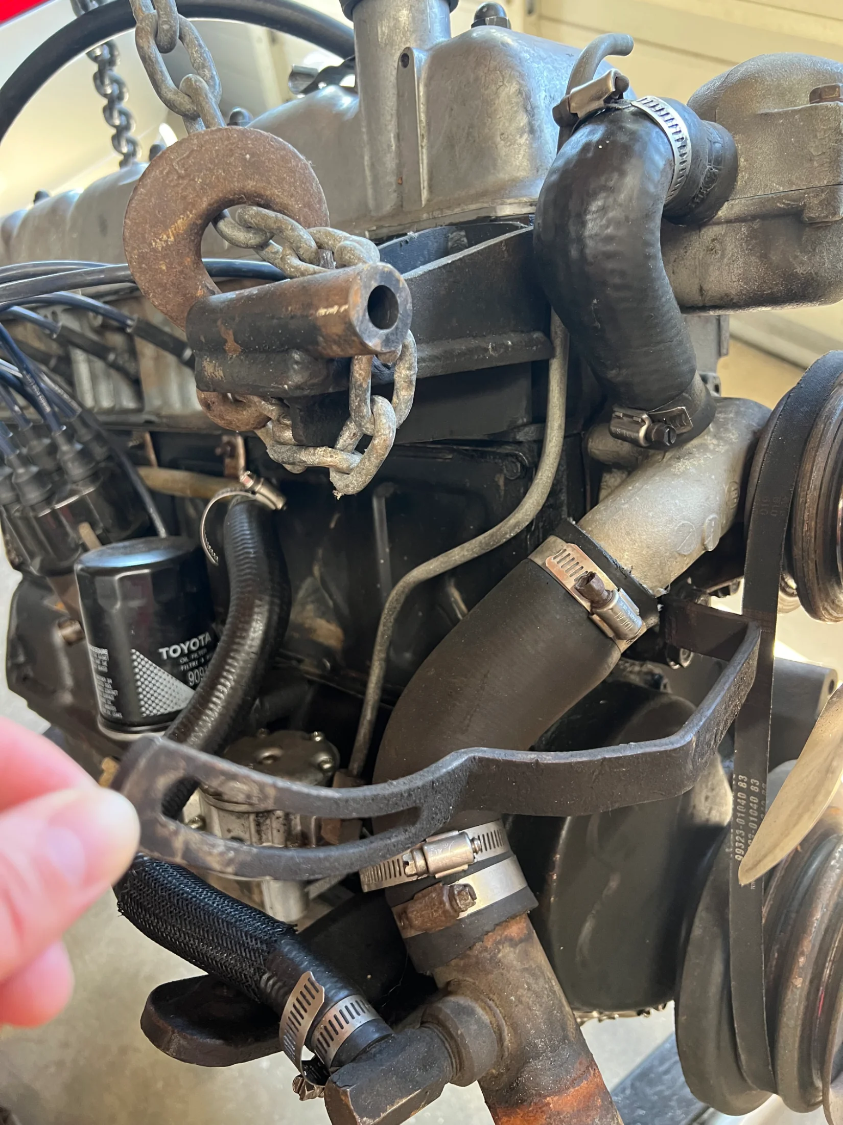

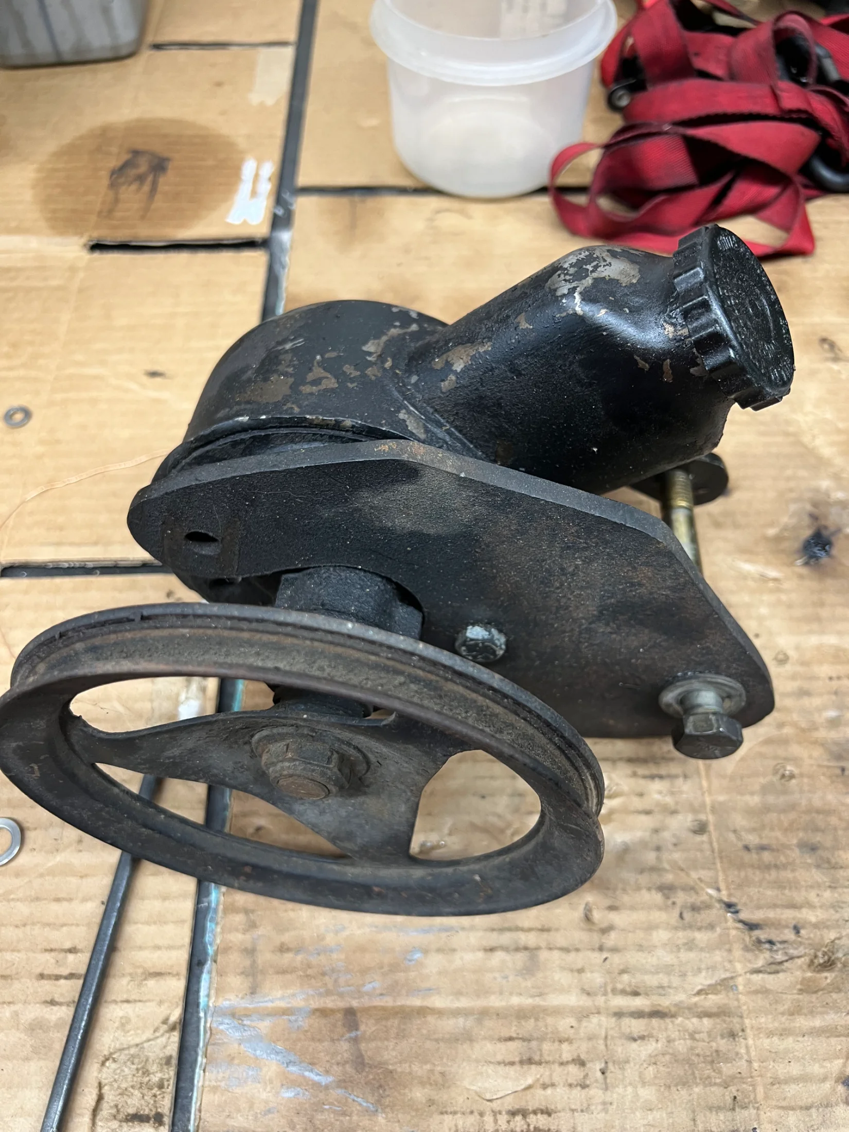

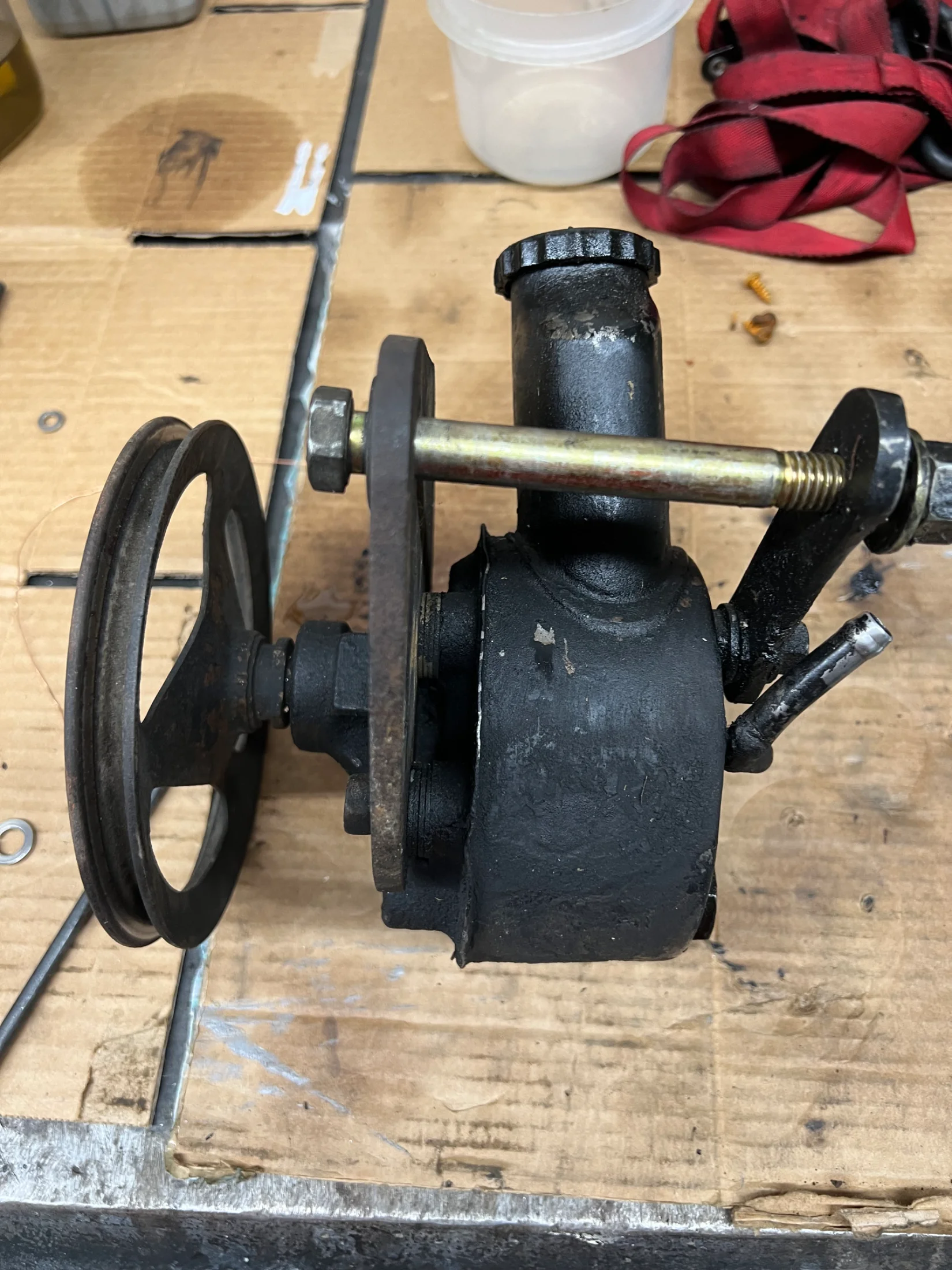

I came upon this thread because I picked up a 2F that has some sort of aftermarket pump kit mounted on the passengers side high up like the one you posted and I'm trying to find more information on aftermarket kits.
There are no markings that I can find, maybe there is something under the gunk, I'll find out. Also the pump is something I cannot identify - def not the standard GM pump. I have seen my fair share of different styles - it looks older, 60s or something., IDK.
So it seems there are some kits out there. Let us know what you find out. Also this engine came out of a PIG but should still be valid.

I think I remember seeing that pump in a ‘66 Cadillac.

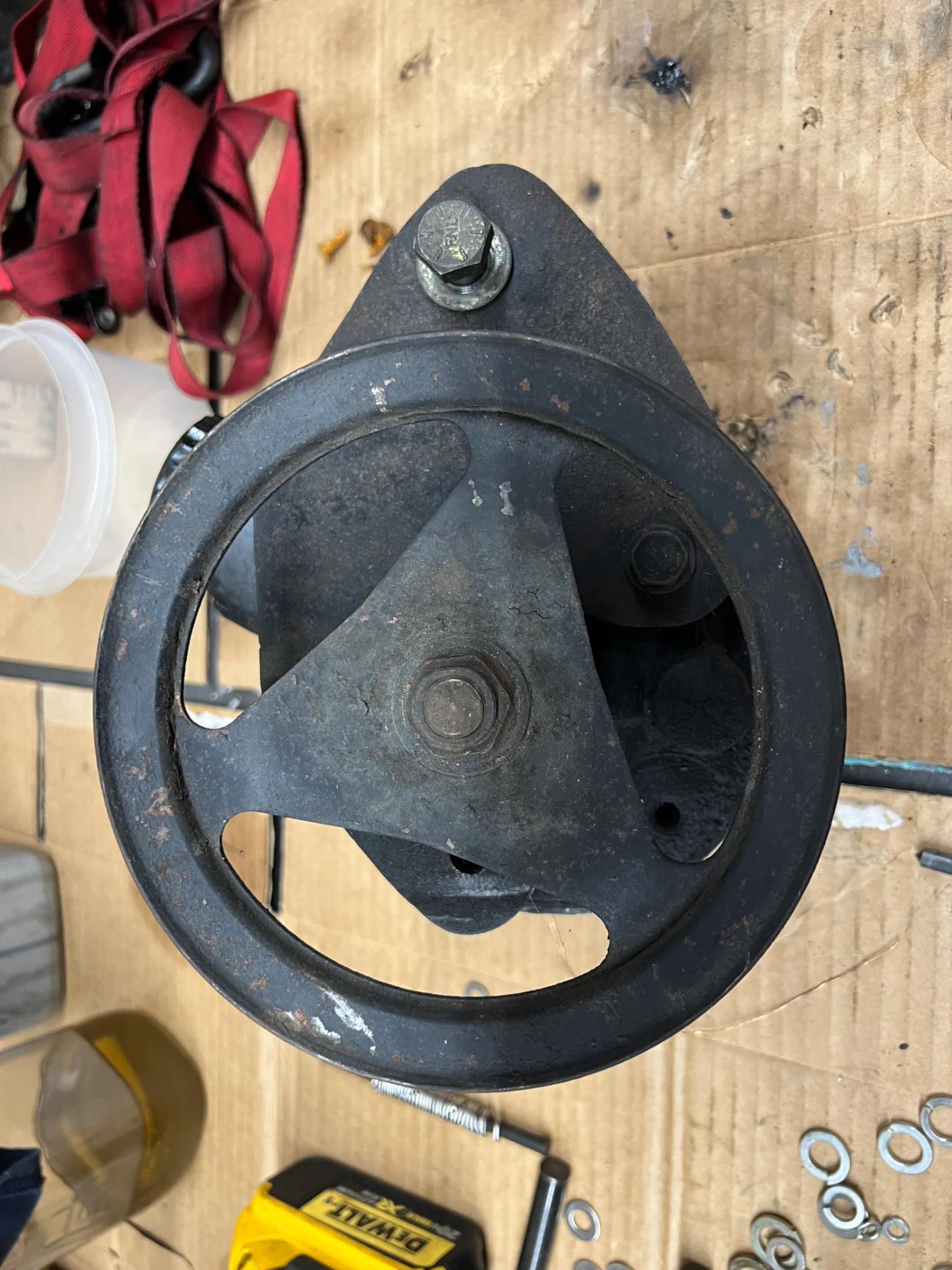

View attachment 3975856View attachment 3975857
Actually it is a GM pump. Seen on mid to late. MONTE Carlos and like mid size cars.
