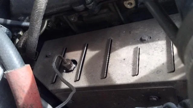

Yoda-G3 are you saying someone has drilled a hole in the Safari manifold and has the EGT sensor mounted in it at the #6 exhaust port?
By someone you are referring to me. I did the install myself. Hopefully that wasn't a bonehead move. :eek: But yes is just a few inches away from the exhaust port.
I did hours and hours of research a few years ago trying to figure out the best spot on a gasser and I decided that the temps on the hottest cylinder coming out was the most important. Looking back I wouldn't have bothered. Seemed like a neat way to use my dual gauge pod, but an engine temp of AFR would've been more practical.
It's been there about 30k without issues.
Here's a pic of it. Luckily my buddy had just picked up a nice plasma cutter for the heat shield.
