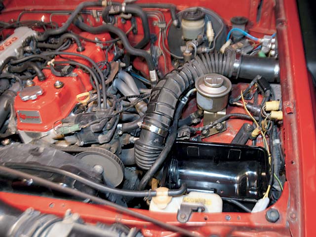

Basically, you start off by moving the igniter coil out of the way and taking the air box assembly out.

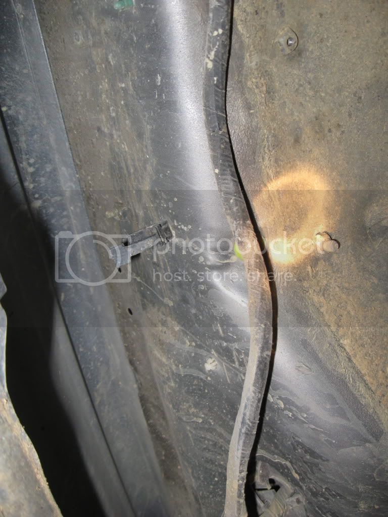

You must also take the plastic inner fender out of the fenderwell and you need to move the wiring loom under there as well.

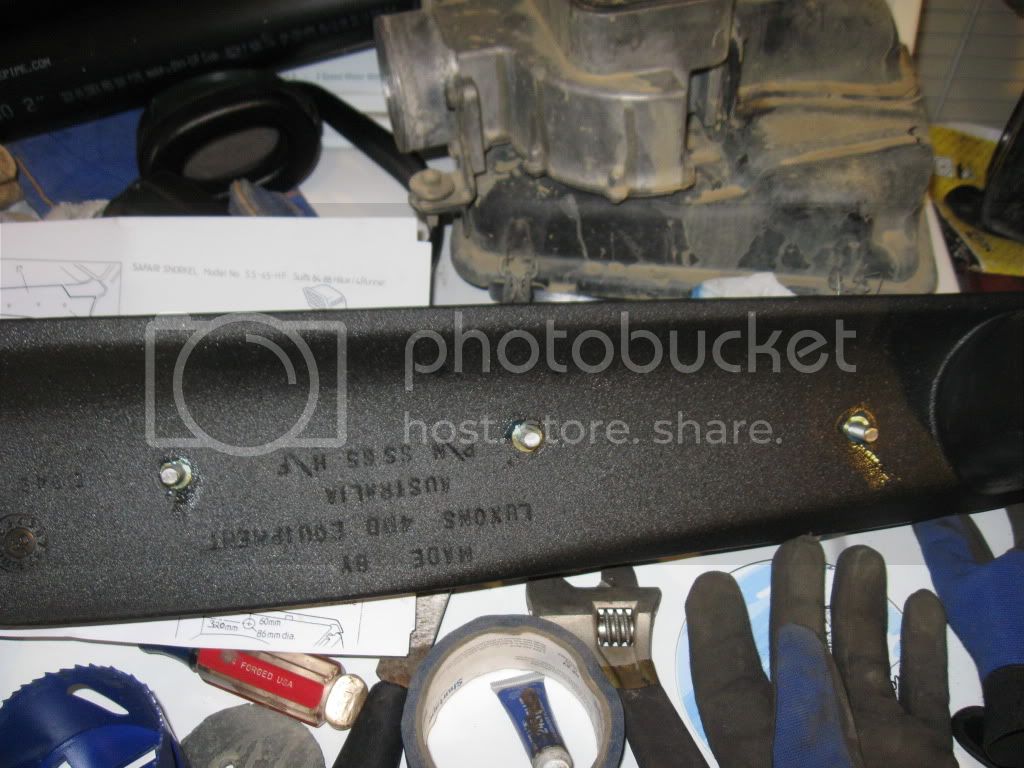

Then you need to put the studs into the snorkel, I just used my fingers to get them as tight as possible. I also put Loctite to them.

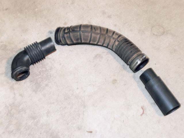

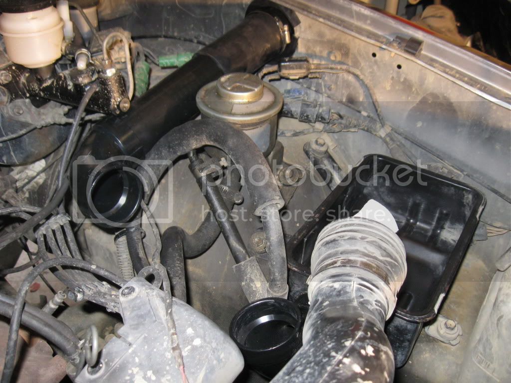

Once everything is bolted down, you've got to start under the hood.
