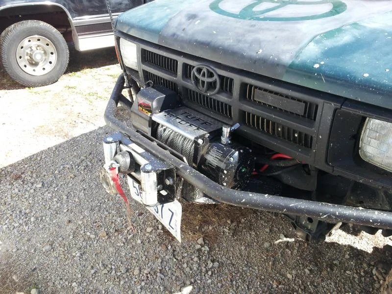

So my new winch came in on Friday, but I needed to go help my dad on the farm after work. I start working on mounting it around 10pm. The fairlead was bigger than I expected (I designed the bumper for a hawse style) so I had to using 1.5" square tubing to space out the fairlead from the front plate. Also, kept breaking bits when trying to drill the holes, so I ended up using the plasma cutter and chasing that with a bit to clean it up. It turned out pretty descent and I finished mounting it around 2:30 Saturday morning. I was up at 6am go to wheeling at the Midwest Toyota Jamboree. No one got stuck so I didn't get to use the winch. The only damage in the group was minor body damage on a couple of rigs. EXCEPT FOR ME. I broke another driveshaft at the playground and didn't have a spare this time. I ended up leaving earlier than I wanted and drove home with locked front wheel drive, which is no fun at all.
Anyway, here's a picture of the finished product.

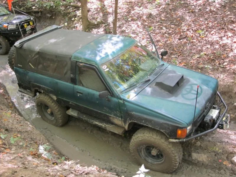

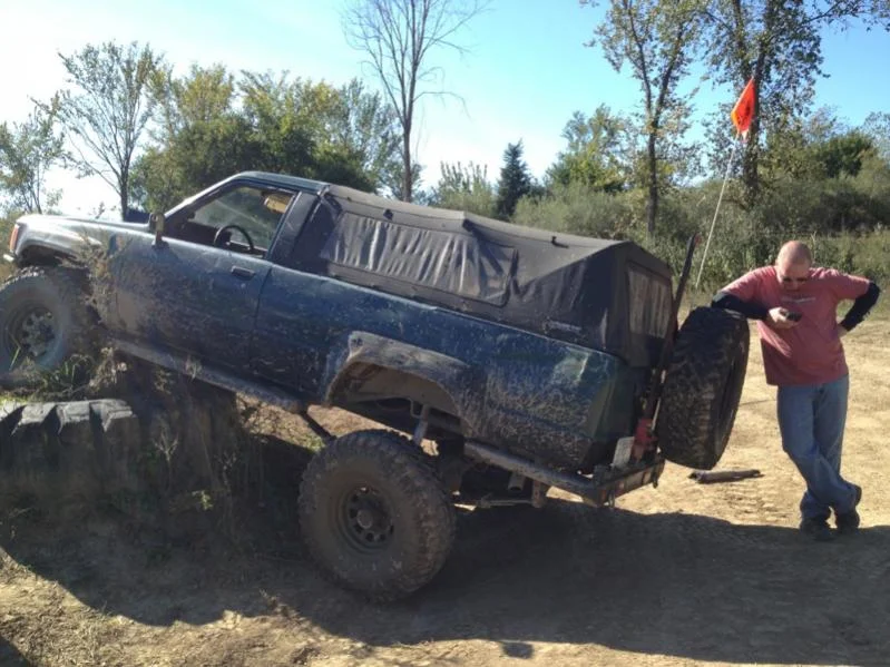

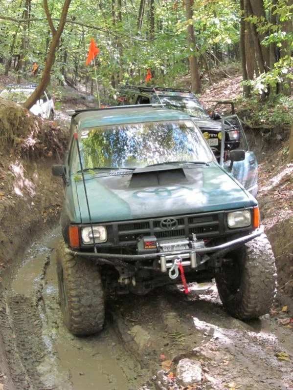

Good pics bud looked like a great weekend to be on the trails and the Runner looked at home :) added a few of the pics for your thread.

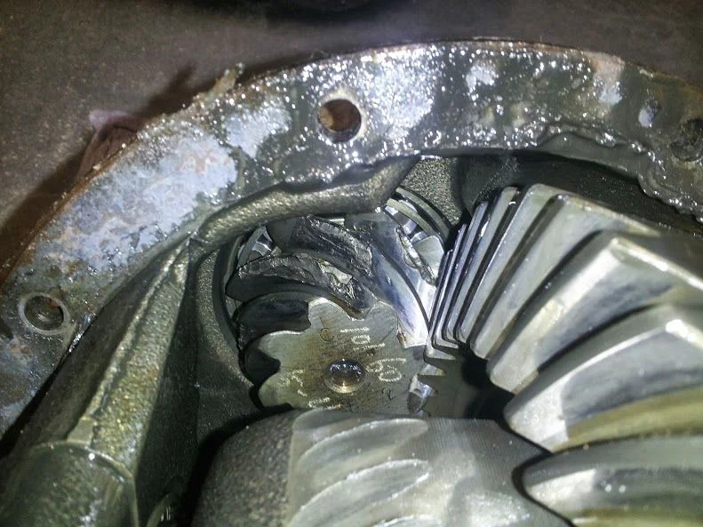

Well, I finally found time to start working on the runner again. The results weren't good. I think I've found where the noise is coming from. I think I'll swap the front and rear diffs until I get some elocker housings to build up. It acted fine, just noisy. Hopefully I can replace it soon.

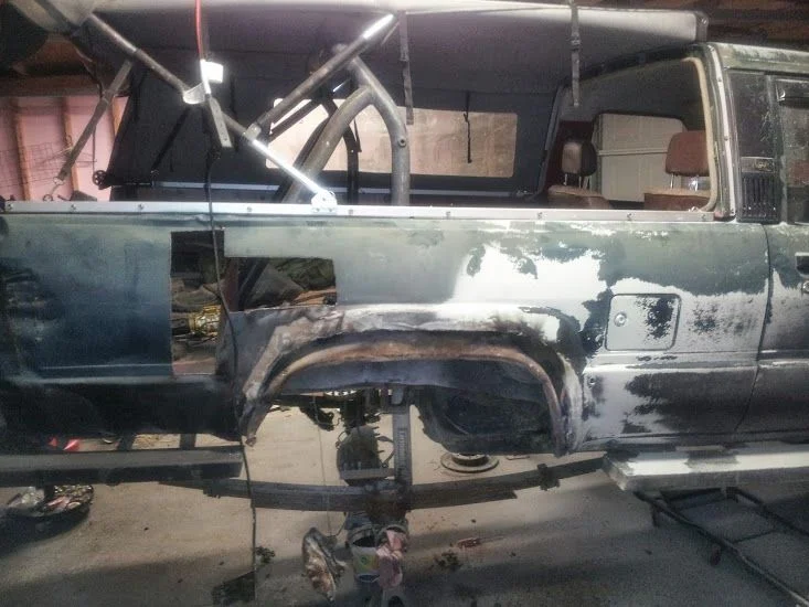

I also start on some bod work that I have been wanting to do.
Well, I finally found time to start working on the runner again. The results weren't good. I think I've found where the noise is coming from. I think I'll swap the front and rear diffs until I get some elocker housings to build up. It acted fine, just noisy. Hopefully I can replace it soon. I also start on some bod work that I have been wanting to do.
Good to see you at it again bud. That pinion doesn't look happy I can definitely see it being noisy. As always look forward to seeing the progress with it an how your body repairs come out :)
