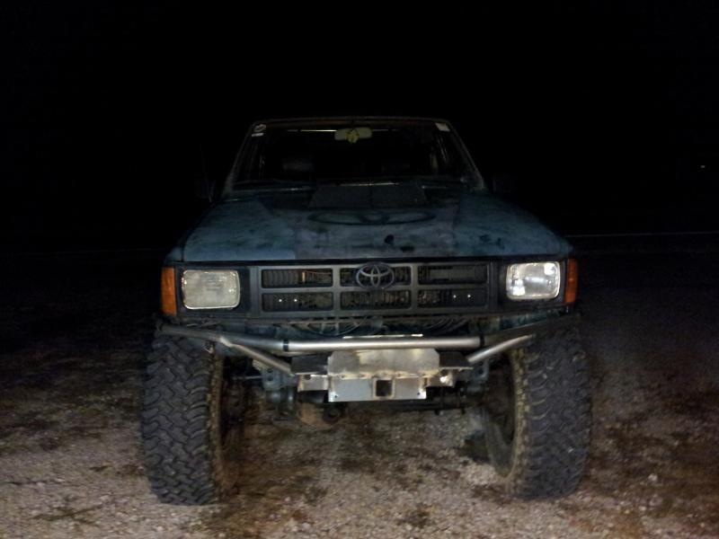

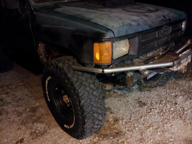

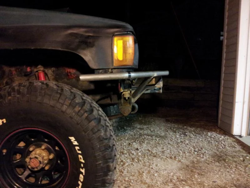

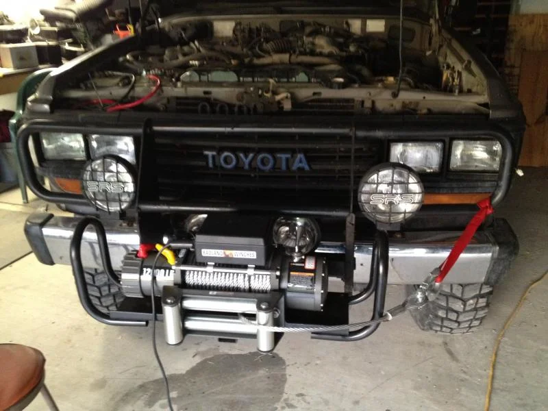

Finished most of the design tonight. I'll weld, trim, and grind this weekend. Should get it painted too.
Total cost will be around $100 and I have 8 enjoyable hours invested so far. I'm worried about how far it sticks out, but I can always modify it later. The approach angle will still be 11"better than departure.

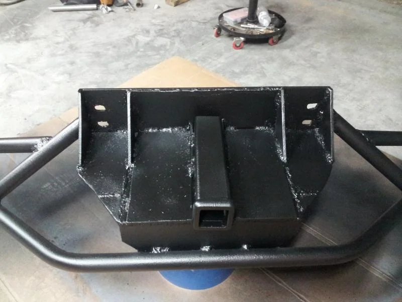

i assume its standard. I got some measurements from various websites and added some space for comfort. The plate is about 22"w by 10"deep with 1" being under the grill. I'll drill it after i get a winch.

The more I look at it, the better it looks. I think it will be fine. I just need to get a winch and see for sure.
I can't wait to get her finished up. The local Toyota jamboree is next weekend and I'm hoping to put it through some test...without a winch that is.

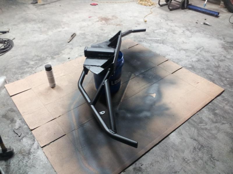

Painted the bumper tonight after adding two more support tubes. Was going to install it, but the paint was taking forever to dry. Here's some upside down pictures of it drying.
I need to find a way to mount my license plate. I think I will make something that fits in hitch receiver that I can remove when leaving the pavement.
Ugly welds but I was able to jack the front of my truck up off the bumper (actually, just the little tab I welded on for the cb antenna, I was trying to bend it a little and the truck was too light). I think it will hold fine and I can always fix anything that doesn't look right after I put it through some rigors.
My skills are one notch above someone with none and 99 below someone that knows what they're doing. I'm just putting what i have together however it makes sense at the moment.
