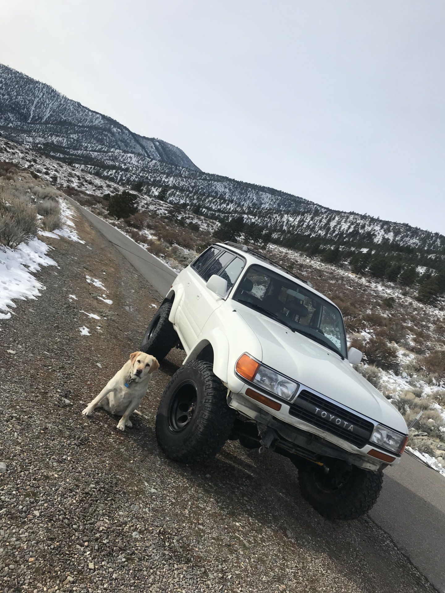

Hahah!! Here she is nothing special looking yet! Figured you guys seen plenty of em that look like this so never bothered posting a picture. I will post a lot more as the parts start showing up and being installed.

You did good!! White 93's are where it's at. ;) Leather or clothe? I have the same kind of dog except mine is brown. haha
It has the leather but it’s all cracked and in bad shape and the seat motors don’t work so I can’t move the seats back n forth.. that’s on the list to figure out a fix. I love the white!
Chuck those seats and install some clothe seats. The factory clothe seats fit me well but I'm not a big dude. WRX seats go in nicely but don't really fit large people to well either. How many miles on the 80?

She looks like mine. I recently got the leather kit but haven't had time to do em yet. If you try to keep em reasonably dry they will last a long time. I prefer leather.... just my .02 cents

Do the motors work? The seats are easy to take out. Two bolts front and two back. Be sure to unplug the motor harness and you are free. The plastic end caps are known for stripping and are replaced with an aftermarket piece that I found on this forum. Google search will get you there too. Both of mine had broken inside and the new replacements have been great. I did the replacements about three years ago. Also, could just be crap in the rails that has it in a bind.... coin, screw, sand etc. Where was your pic taken? Looks like Nevada.
That dog has seen some sh!t...

The picture was taken in Genoa, Nevada
