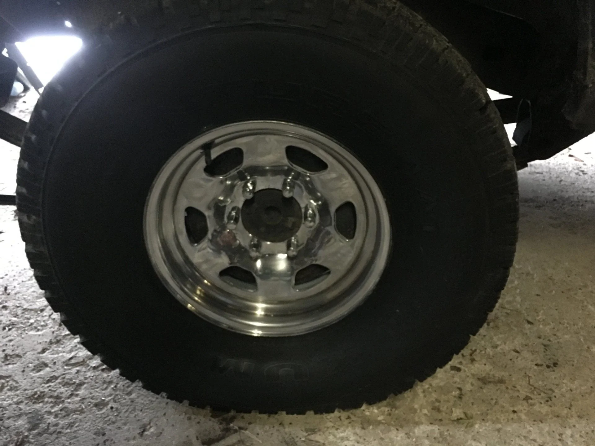

The wheels were a faded and chipped rattlecan job.
I’m undecided on wheels and tires, so figured I’d strip the paint off and see what was beneath.
Not bad. All 4 have some minor pitting, but they cleaned up well enough.
!Yes those are 33x12.50 on stock rims!

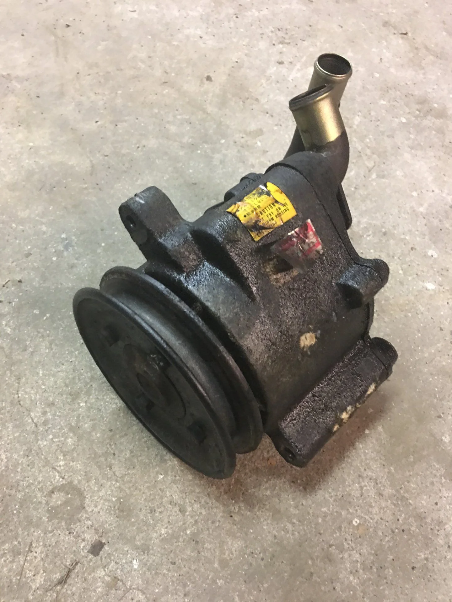

One issue I immediately noticed was leaking power steering fluid. Pour it in - it comes right back out of the interface between where the pump and reservoir join. Easy fix. Not really. The pulley has to come off the pump. Might as well take the pump out...
Pull the pump apart, find the o-ring between the reservoir and pump is only doing 80% if it’s job

Do you happen to know the size of the o ring between the power steering pump body and reservoir? My pump has a similar affliction.
@DrRock
Sorry I don’t. I have a big kit of o rings I keep around for hydraulics. I just pulled one out of there that looked close and it worked. I’m sure there is a Toyota P/N for some metric o-ring...this isn’t that, and the repair was a few years ago and is still holding.
@DrRock
No worries, thanks for letting me know! I'm actually in the process of de-smogging and noticed a leak on my PS pump which looks to be coming from this junction. I'll pull the reservoir tonight and get the o-ring out so I can replace it. If it solves the issue then I've saved myself from replacing the whole pump, yay!
