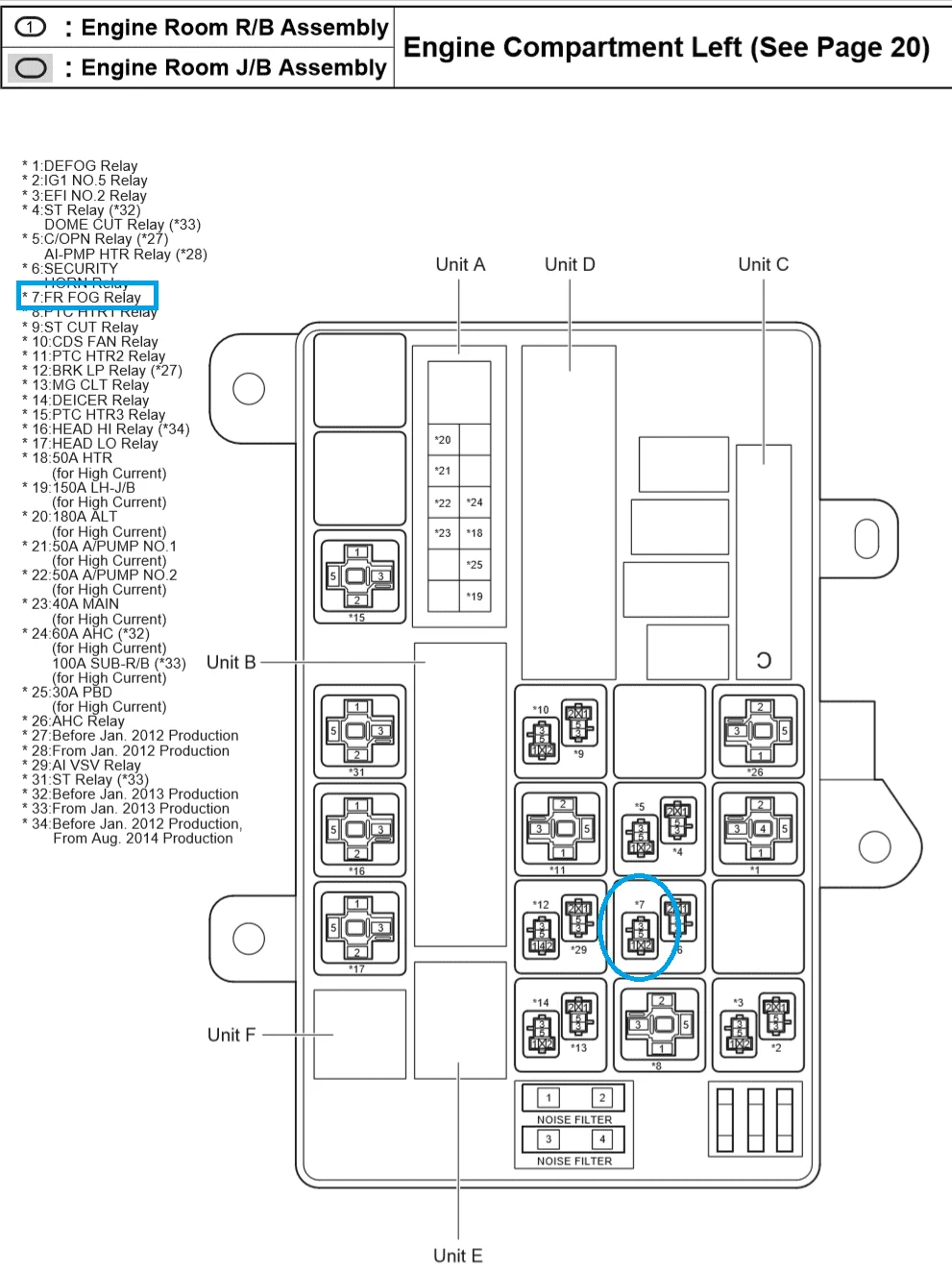

I may very well just add a relay and switch outside of this so I can turn on/off the fogs and avoid additional complexity here.
That's what I would recommend. Remove the FR FOG relay and plug in some spade terminals to the sockets at pins 3 and 5 and connect to your own external relay and switch it however you would like. That way you will have full independent control, no factory wiring is cut or modified, and can easily go back to stock just by plugging the factory relay back in.
