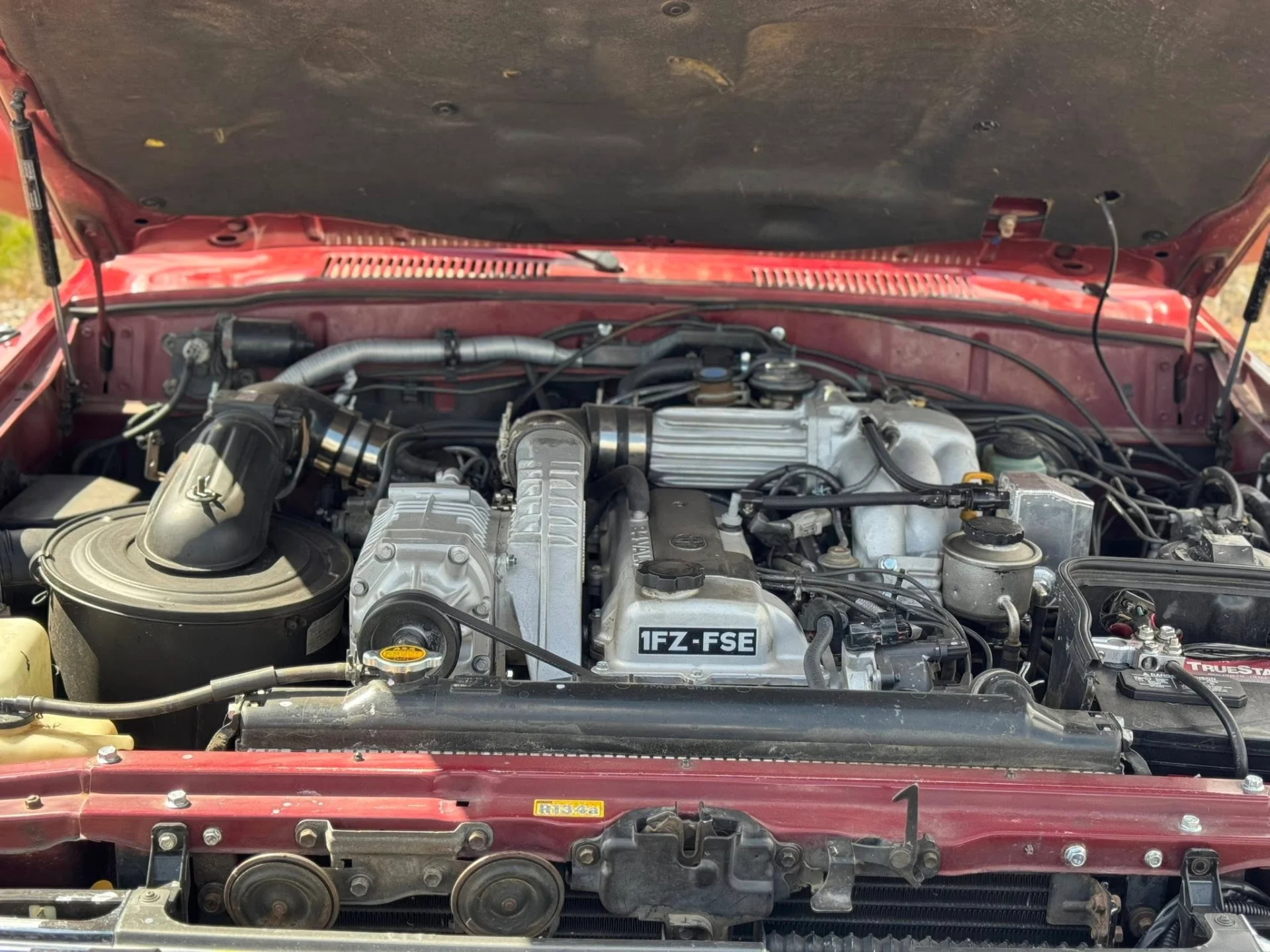

We got a little excited with our shop rig build. Idea was just use a lot of the take off parts we have collected over the years. Bumpers, tires .stereos etc. She ended up getting a body on chassis restore. Ruby was an east coast rig that the rust man almost got. My bolt buster got a work out restoring the chassis. The rust did not comprise the integrity of the frame but boy it was ugly. Covered in undercoating from someone trying to hide the damage . This rig tested my resolve and passion for land cruisers Between the rust and the shoddy work of owners past.. It was one of those projects were you fixed something and break 6 other things in the process. And just general frustration . Example Blew a head gasket while parked. Dies in the middle of the road after a new head with arp studs and comt head gasket. No codes nothing . PO did a fuel pump and didn't put the clamp on the fuel hose to the pump. So when the fuel got hot it expanded enough to blow the fuel pressure into the tank But yet had just enough to idle and kinda run . They say they harder they fight they better they are !! my plan was just make something to beat on so I don't have a bunch of pre pictures .. I didn't expect it to turn out this good. I will add photos to the thread through out the week
Here are some of the axles . rebuild and restore everything pretty much looked like the rear axle. We found two spots on the frame that had a little rot that we fixed . Under the steering box at had ate some of the metal out which our frame kit resolved and the frt body mount behind the down pipe we replaced. EDIT........... I have had a few ask why I hate DeltaVS anyone who does business with them knows Dave sends out these silly stickers with orders. We stuck it one there to see if he would see it at Cruise Moab . Delta is prob 1 of the best vendors we use.

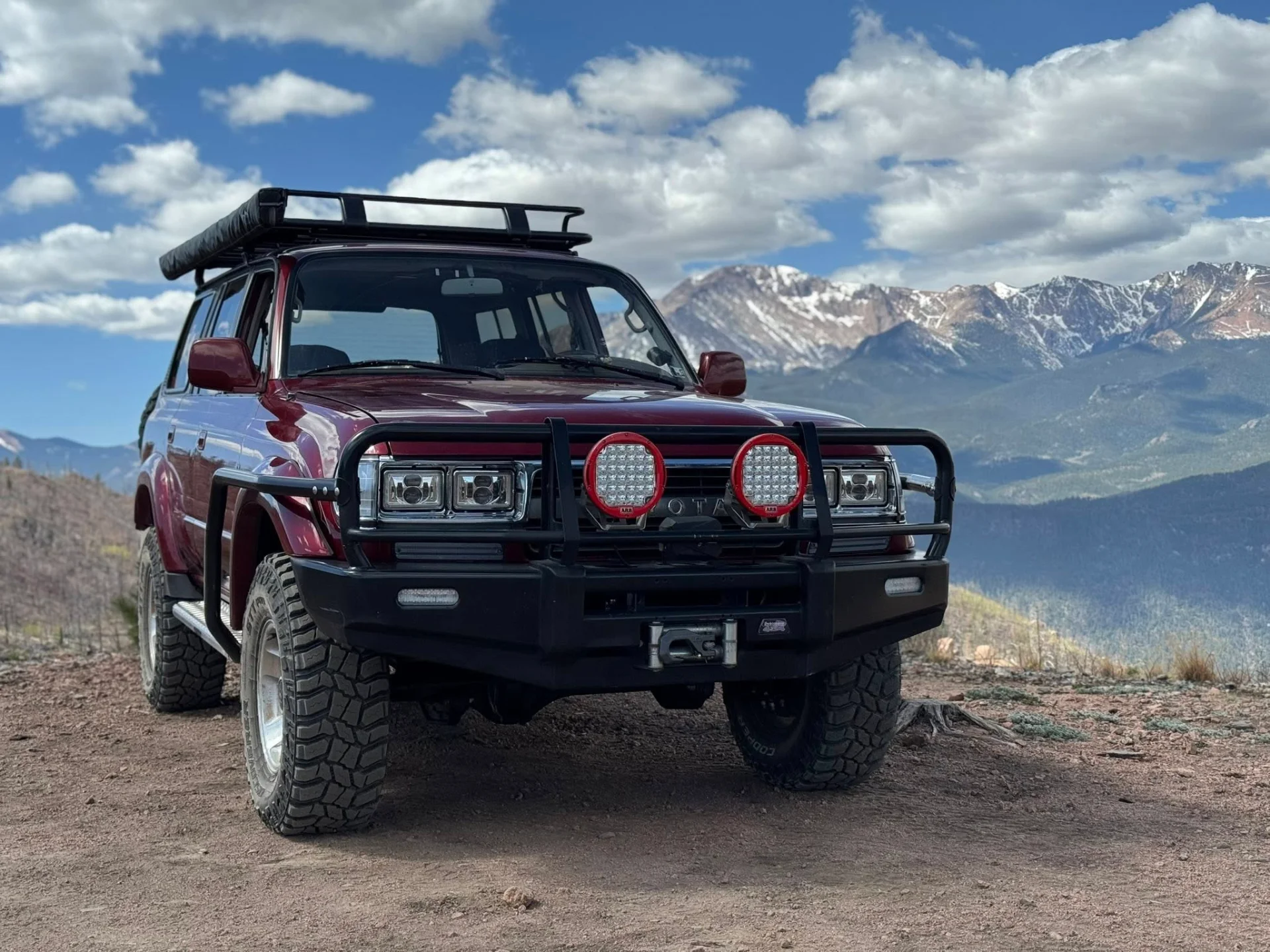

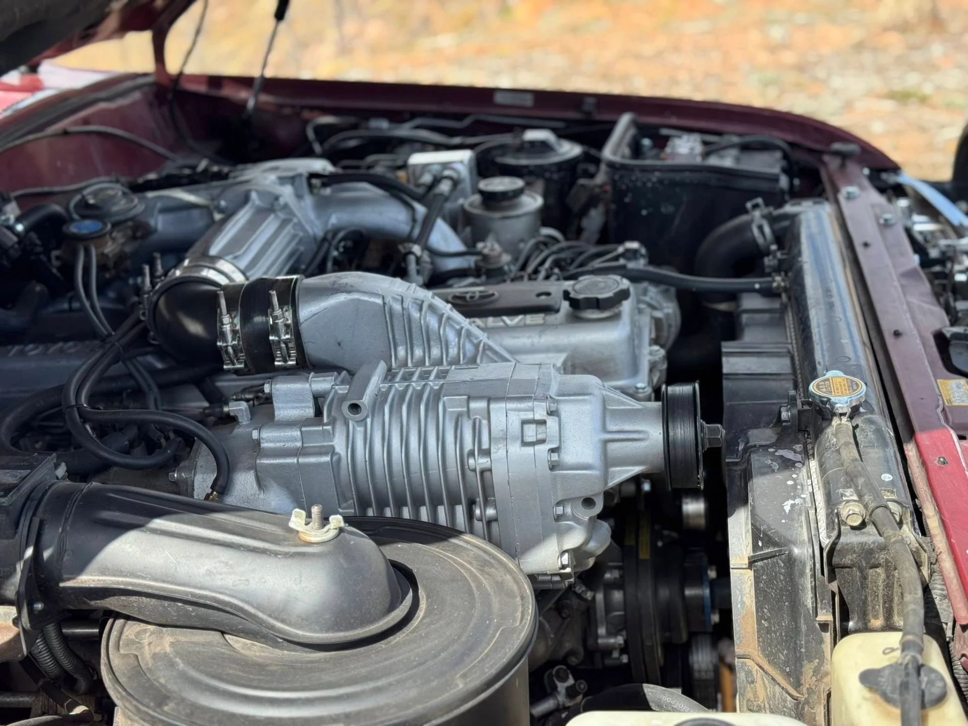

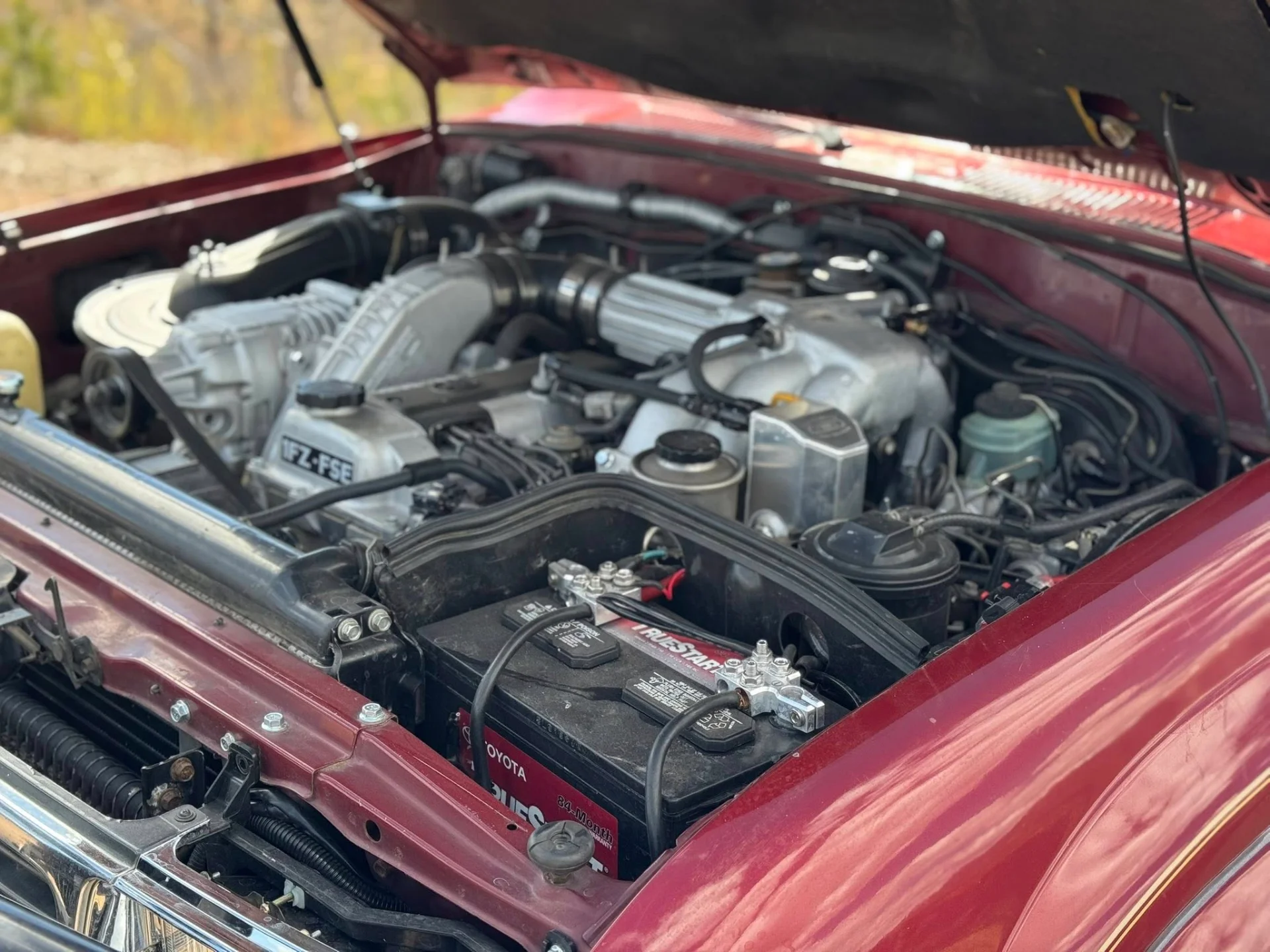

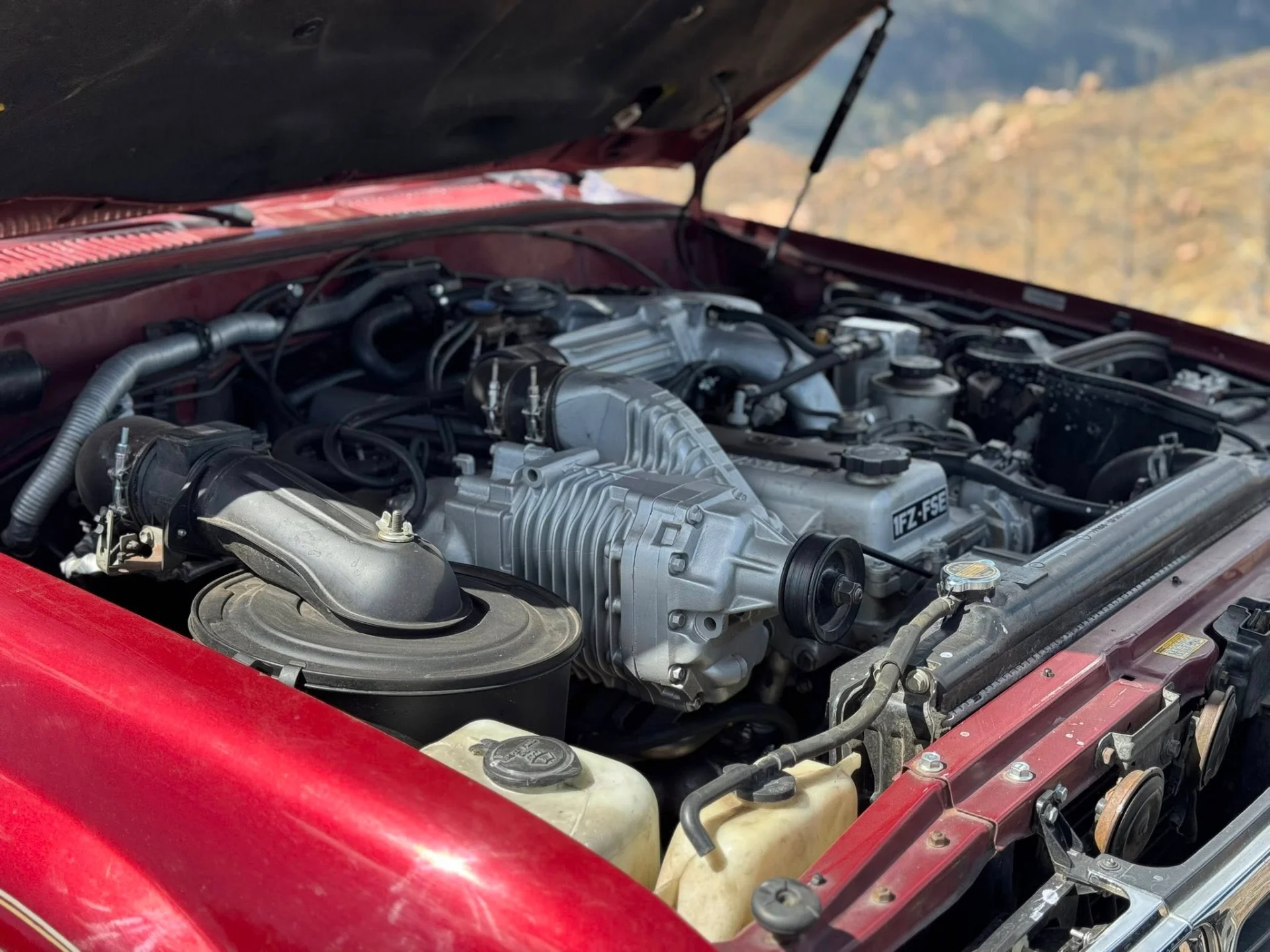

Of course How could it be a Precision Land Cruisers shop rig without 1 of our OEM quad headlight kits and old school grill (it's a 1995 with a non us turbo grill) and a Gen1 TRD supercharger!!
We didn't do anything to the outside other than some wax . there are a few rust bubbles on the bottom of the rear doors and the rear bottom of the 1/4 panels are wasted. we cut out the rust and sealed it . Because the bummer side wings cover it we may never fix it . More pics to come
