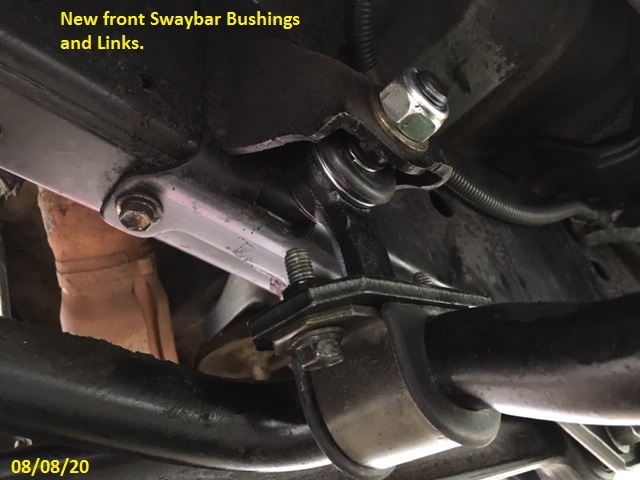

Hi all, there is a rubber U-shaped piece that is held in by a bracket with two bolts on each side. Mine broke this weekend. I was able to cut off the top parts and fit it back in and tighten it up to get me by for now. Anyone know what the rubber part is called, so I can order a replacement? Yeah, I know all about the leaks going on under there LOL. Thanks!

Or you could pop down to your local Toyota dealer and hand over $8 for 48815-60070. Probably worth getting 2 of them. Also might be worth getting the rears when you are at it.
D'oh. 8 bucks kinda beats 110 bucks. Yeah I think I will do the rears too while I am at it. Thanks!
That is the rear part number.
Rear x 2: 48815-26020
Front x 2: 48815-60070
Or, consider Energy Suspension Polyurethane bushings, don't have the part numbers in front of me, but they have universal fit bushings that work.
I went with Siberian Polyurethane bushings, so hopefully they work out fine. Will install them this weekend. Thanks!
You are actually incorrect. @Irish Reiver is correct.
-60070 is front.
-26020 is rear.
That’s on FZJ80 trucks.
Hmmm, I went with these and gave them my VIN when ordering. The descriptions says front/rear. I am replacing the front ones. Should I be fine with them?
