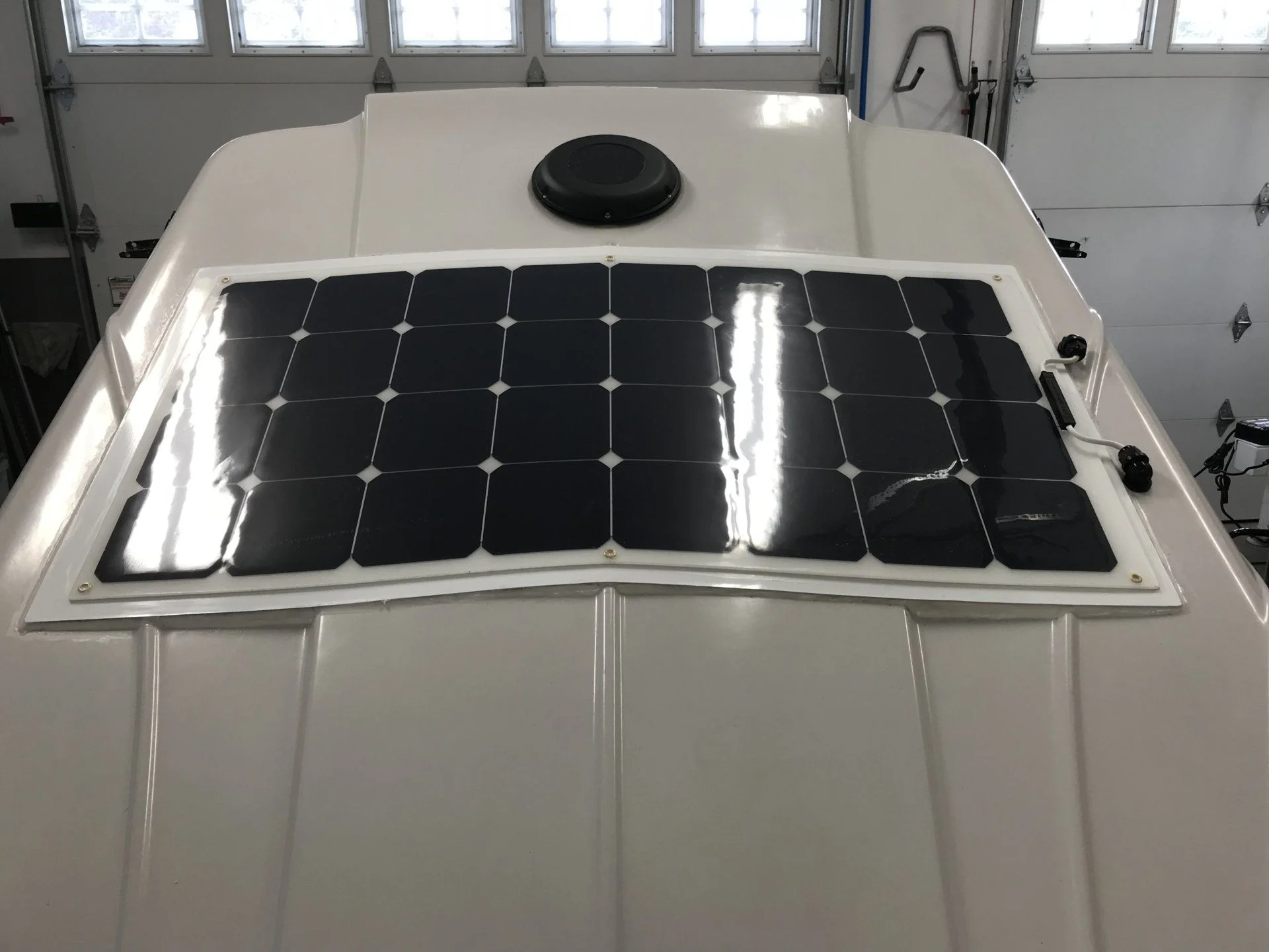

100 watt thin film solar panel attached to a James Baroud RTT (not easy).

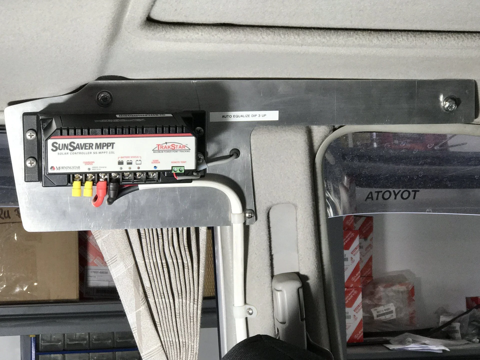

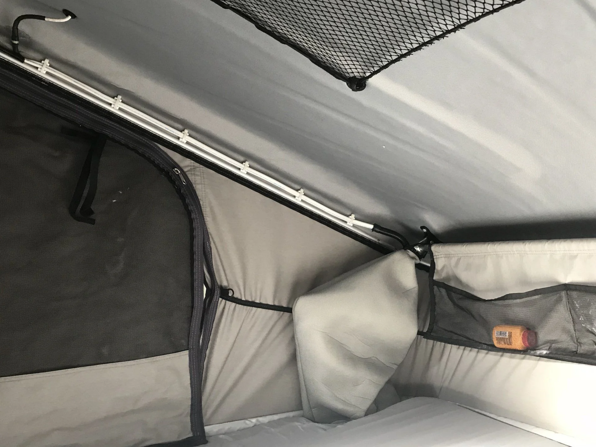

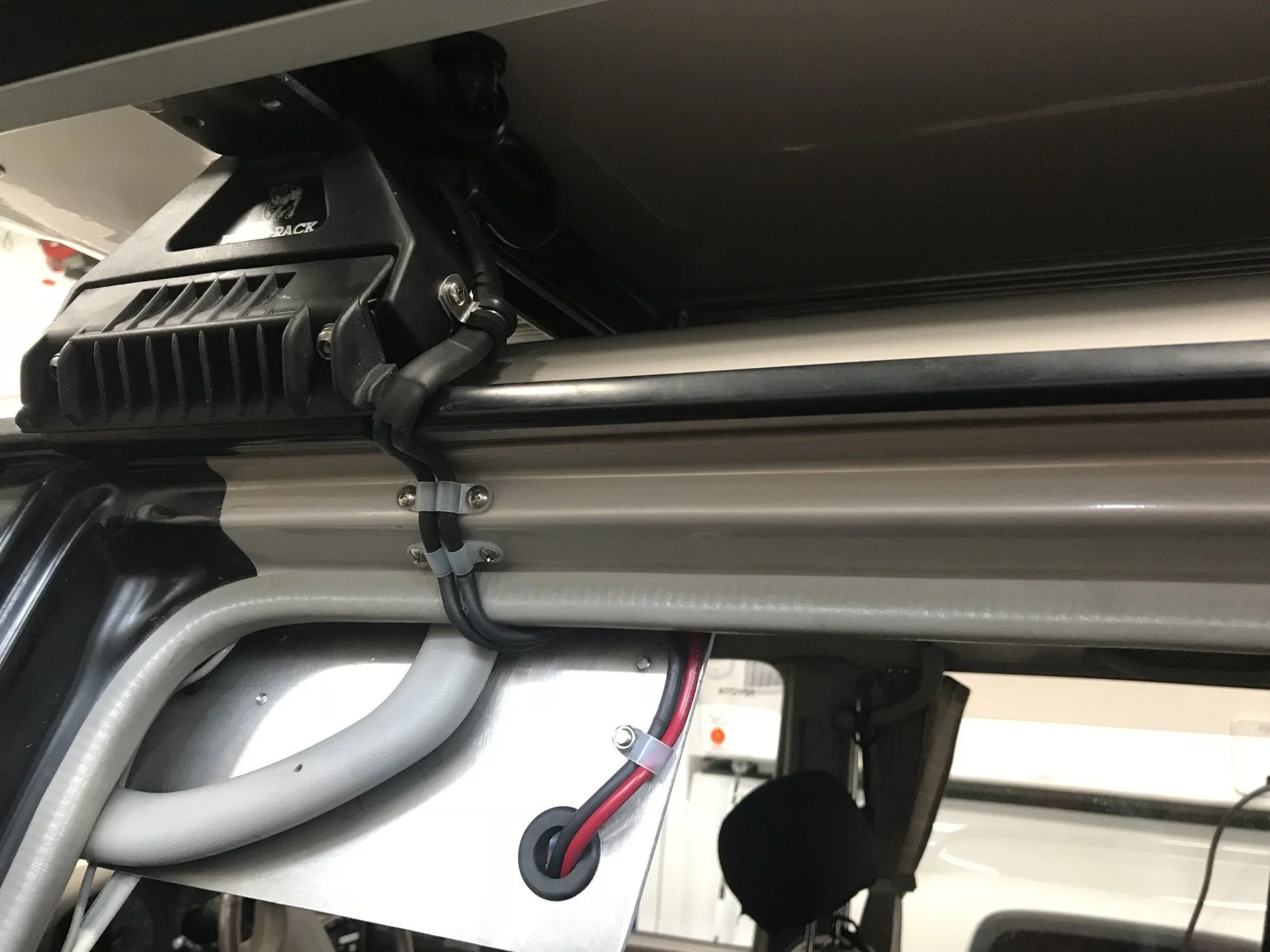

Marine 10 gauge through the RTT shell with IP68 cable glands and out the bottom and in the cab through rear left window to the Morningstar MPPT charge controller, and onto the left battery fused at 15 amp.

Working fine, even though slightly derated because it gets a little warmer than a conventional panel.

the wiring down through door dosent cause issue with sealing of door or crimping of wires?
No. The trick I cut the two pair conduit to get them flatter (still good single wire insulation) and ran them over several curves. Did this before no leaks- door weatherseal fits tight around the wires.
The wiring pictured above or something else. Im with RFB on sealing.
