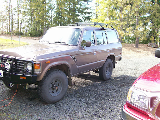

MrLocksmith's 1985 Toyota FJ60 "Leaky"
I stumbled upon this 1985 FJ60 on Craigslist while looking for a capable four wheel drive for my metal detecting trips. Little did I know, owning a classic 4x4 like this can be really satisfying for someone who enjoys fixing and tinkering with things. You also tend to meet some very cool “Cruiserheads” that are just as eager to help you work on your rig as their own. So thanks to all you MUDDERS for your help as I have only owned this rig since Sept of 2007, and I have not turned a wrench on a vehicle for almost 20 years.
Below you will find some photos and modifications that I have made to my Landcruiser. Please let me know if they are of any help to you in modifying your own rig as I have done most all the work myself including putting in a H55F and T-case rebuild.
SPECS: 1985 Toyota FJ60 Expedition Rig
Here is a quick list of the mods and additions I have added to the rig. Otherwise it is mostly stock.
  1. Nickname: Leaky (Cause I’m always fixing some type of fluid leak)

REAR CARGO CABINETS
Anyone who has gone car camping with a respectable amount of gear can sympathize that an unorganized mess can quickly make your trip a struggle to keep things where you can find them. I wanted to be able to keep a base level of water, food, spare parts, tools and recovery gear at hand and organized at all times. Hence I build this set of cabinets that are mainly designed around the larger cases that needed to fit in to shelves and cubbies. I then made smaller sub shelves to hold smaller items. The build was simple and took the most of a weekend.
I first made a cardboard mock-up and then cut ant test fit each piece on my table saw and made adjustments as necessary. Outdoor carpet was then glued to the top surfaces and aluminum angle were used to trim the edges. Please do not ask me for dimensions as they were made for my needs. I drilled holes in the bottom of the floor and used 5/16 x 18 carriage bolts to bolt the bottom of the cabinet to the frame. Pocket Holes were used instead of DADO cuts to mount the shelves. Hold downs were morticed in the top to strap larger items to the top deck.
The large compartment behind the seats hold some of the larger, bulky recovery gear and spare parts.
SLEEPING PLATFORM
I removed the back seat and installed a cargo box that is braced to the rest of the cabinets with 2x4's and uses the seatbelt and seat latch holes for mounting to the body. The box fits in between the wheel wells and blitz can holders were mounted over the wheel wells to hold water cans. On the drivers side there is room for my sleeping bag between the door and the cabinet while the passenger side holds my CO2 tank. The front of the cabinet has my MaxAxe and Pull Pal Mounted to it. All this was done to save on weight and my OasisII tent is now off. I will try this for a while and see how comfortable it is VS sleeping in my RTT.
For sleeping, the front seats slide forward and the rear cabinet cover bolts to the front of the cabinet addition to form a platform.
This project was not hard and can be done with a skill saw and a drill. I found that things are not always square and many of the pieces had to be custom cut on non standard angles for a close/custom fit to the side of the inner quarter panels.
