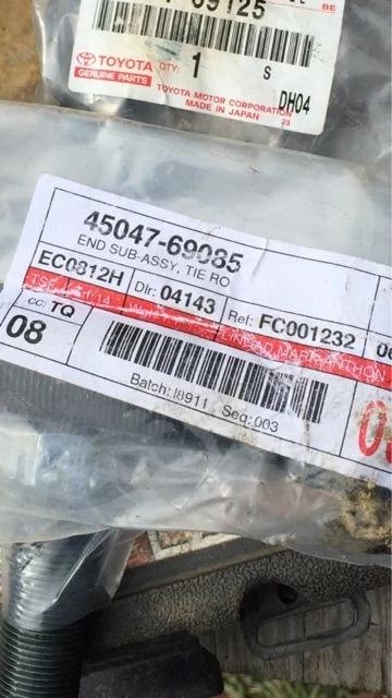

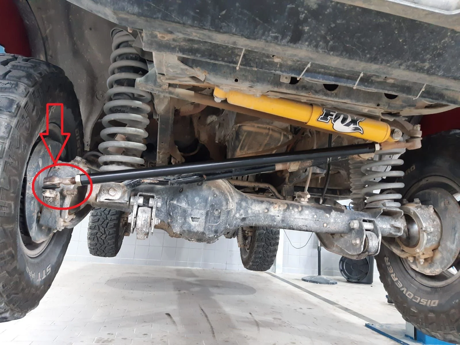

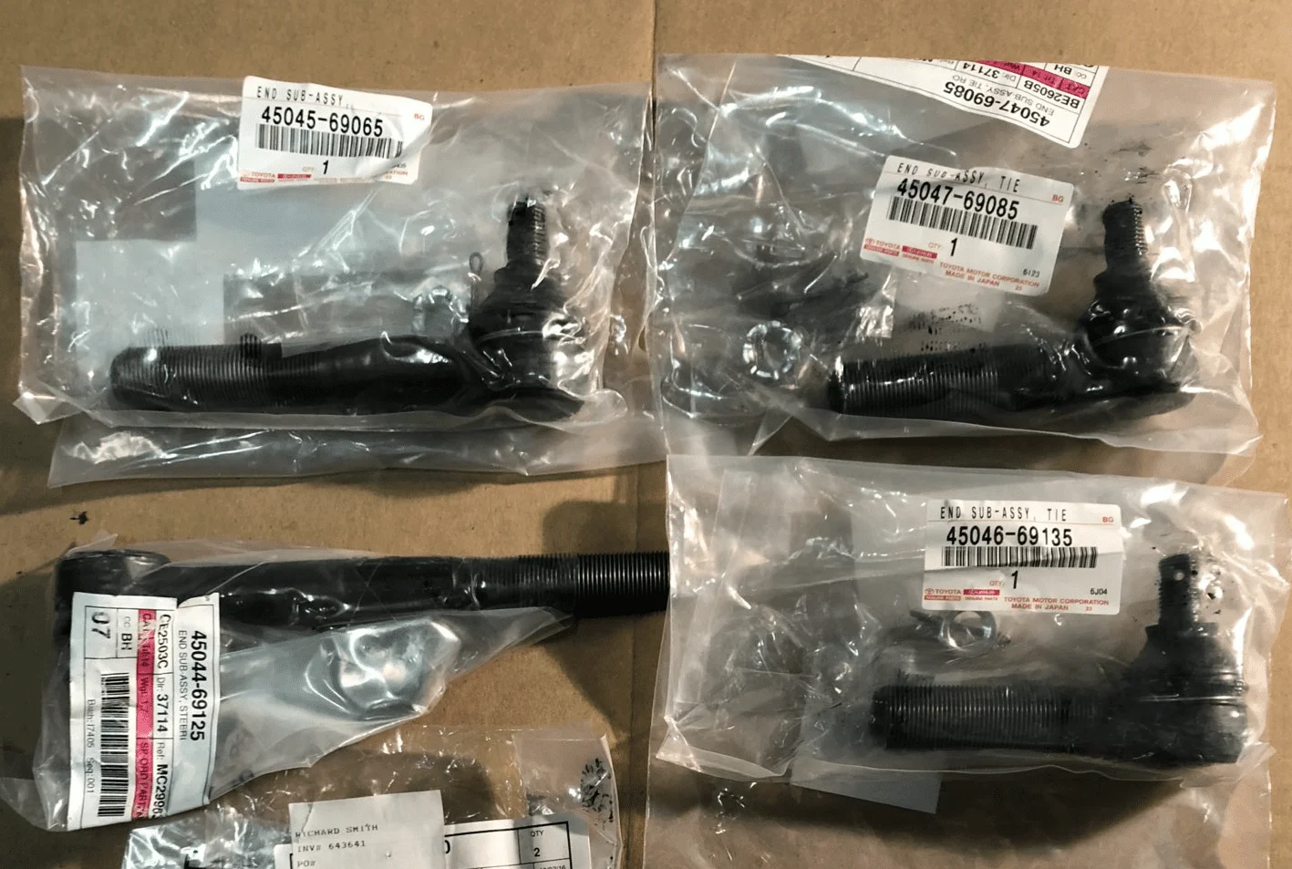

When I installed the Slee steering and drag rods I found that one of the TE had too much freedom all the rest of the of the TE were OK, they are 2 years old I got a set of 555 Japanese from @cruiseroutfit it is maybe a coincidence but when I bought the rig the same position TE was bad, so I have the 3 old ones for the trail back up.
I have FZJ80 USA SPEC LHD. The TE I need is this one

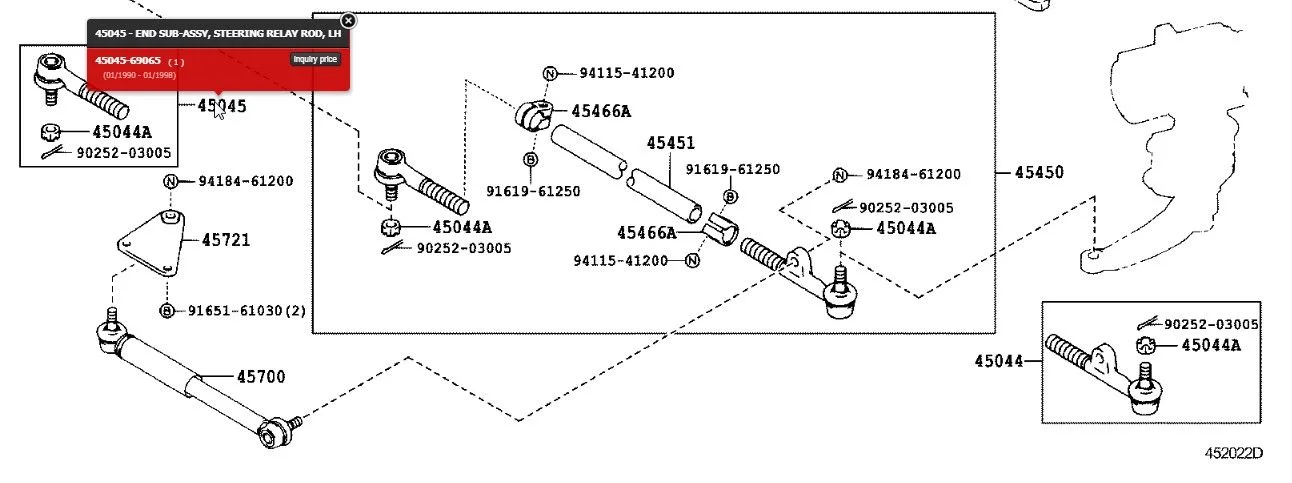

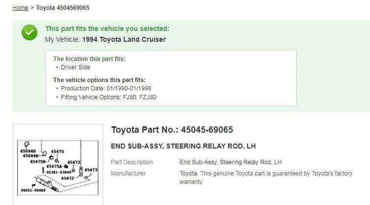

So I opened Toyota catalog punched in my VIN number and got this part number, the drawing is correct, but the wording says this part is LH?
