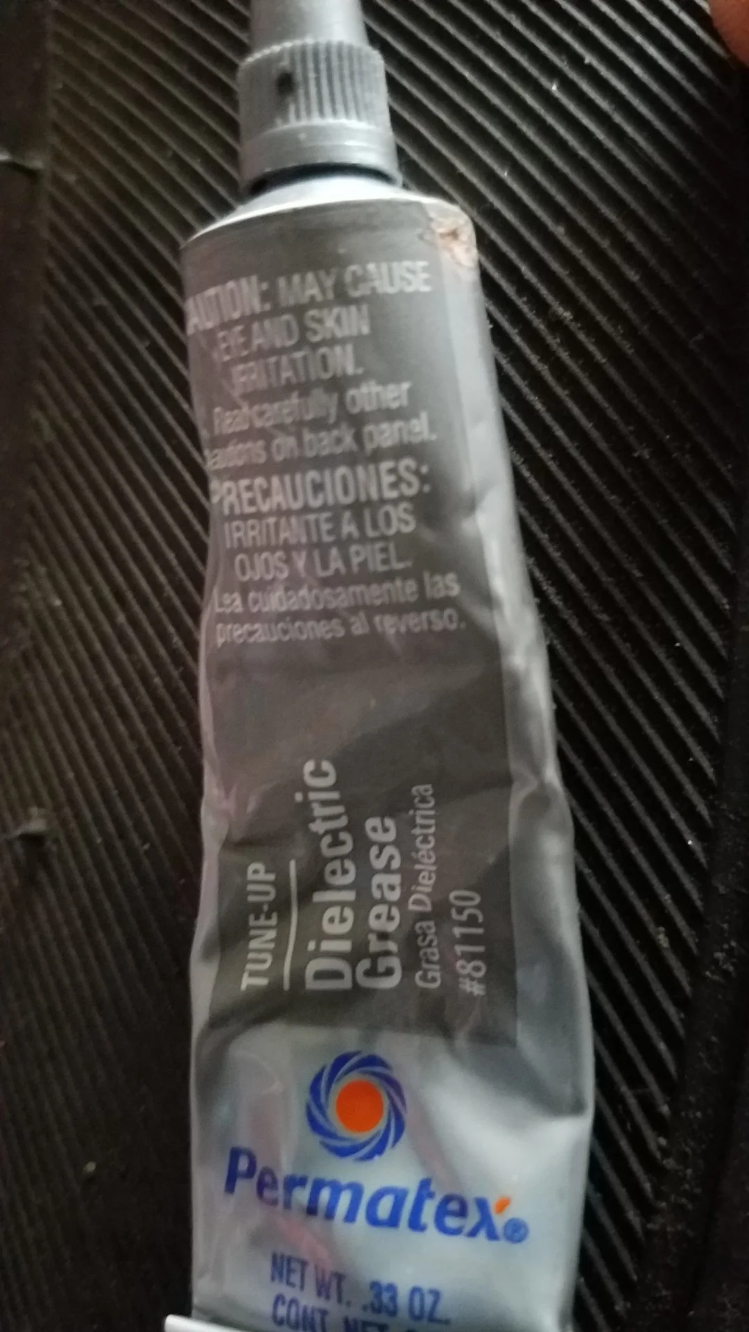

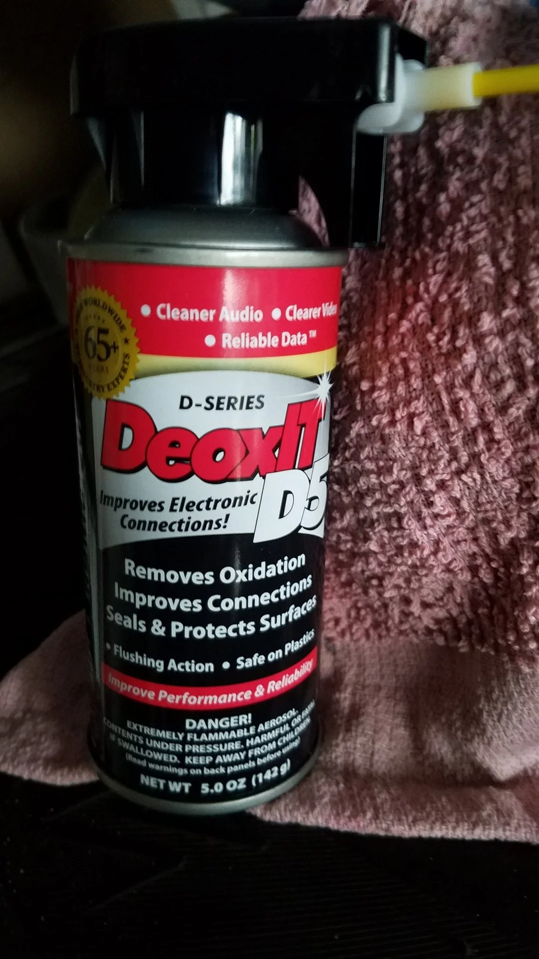

silverhorse 10 Year 15 Year Joined Feb 7, 2009 Threads 192 Messages 1,546 Location Pensacola, Fl. Jun 30, 2021 Thread starter #22 So just to update this for everybody's reference. I dried everything out with compressed air, cleaned all the contacts with deoxit D5, coated the terminals with Dielectric grease.. Then ran weed eater line down the sunroof drains... So far so good
