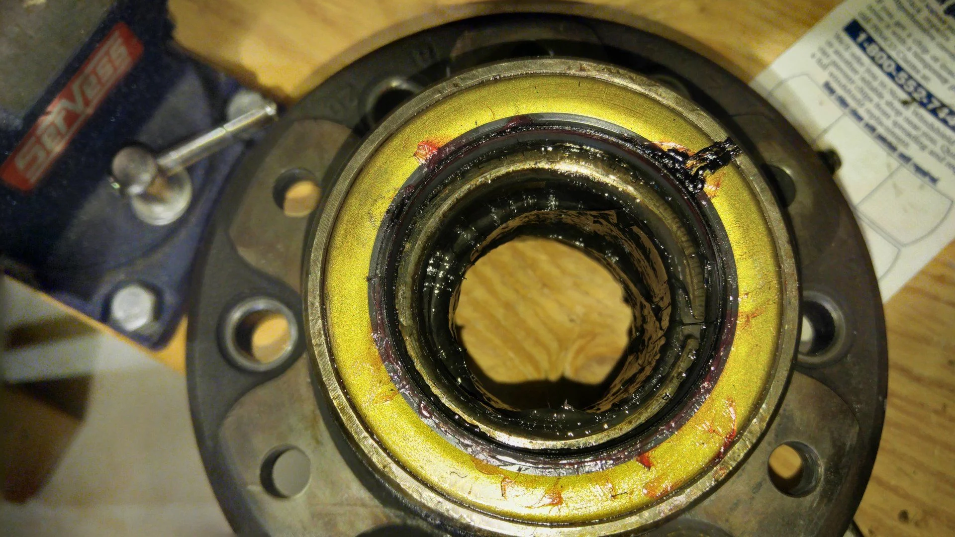

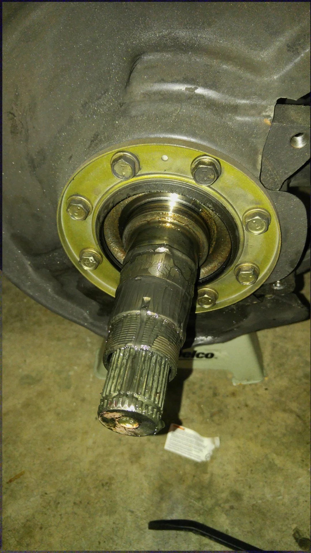

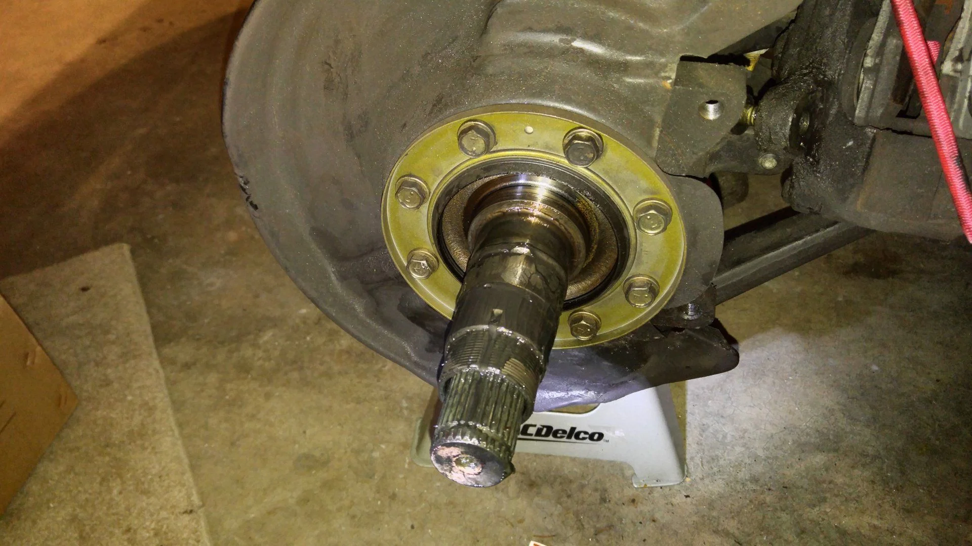

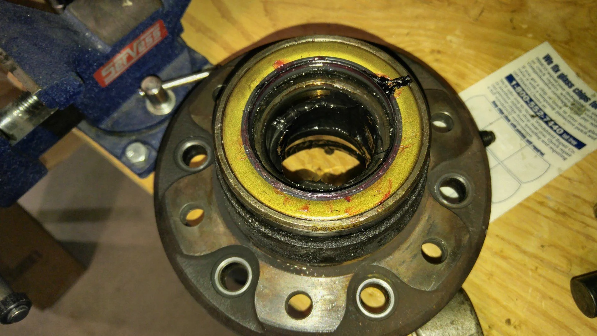

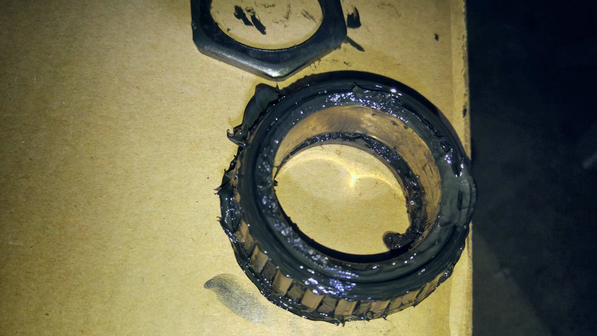

Finally do you all mind taking a look at the pictures below? I am at best a one :banana: mechanic and I think the bearings look find and the wheel had no play in it but you all would know better than I.
Thanks in advance!

3. I dinged up the inside part of my hub a bit when removing some of the studs, is this okay?
What part, how bad are the dings. Probably is fine.
Looks fine but its hard to see anything with all the grease on the spindle.

1. I'm guessing that your referring to the hub gasket and if its not torn you should be able to reuse it, if it is than red fipg can be used as well.
2. yes, to help reinstall the caplier you may want to press in the pads a little bit to get some room between the pads and rotor
3. the pics arnt really showing any damage to the hub, if you nicked the hub seal in the metal area itll be fine. if the seal area (the black rubber area) I would replace it and repack your wheel bearings at the same time.
