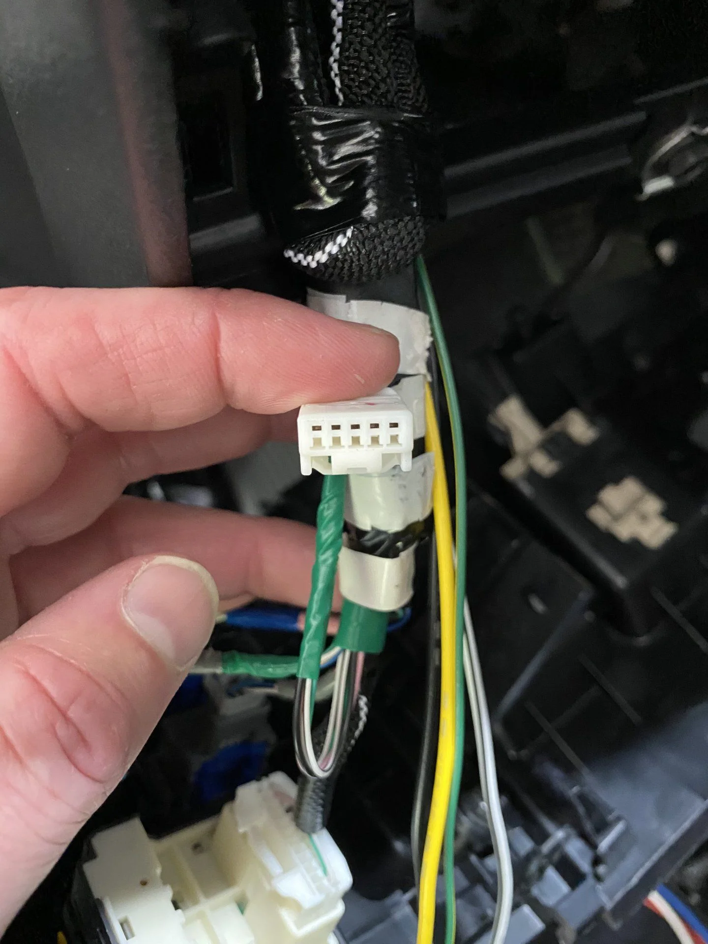

So hate to bring this back from the dead..... but while installing my trailer brake controller I saw this harness taped up behind all the switches. Is this the right harness for the RSCA Off switch? Could it be possible to order the switch and simply plug it in? Kinda how I plugged in the multi terrain select module on my GX460 and it just worked?
Or does someone know what this plug is for then? Thanks again
See if the dash indicator lights up if you connect pin 3 and 4.

So after finally getting some time to look at this and even my own picture I realized that mine has 5 wires pinned out not 4. Do you think it could still be this switch and different years have more wires? Or maybe this is not that switch? What else could this plug before? There are no other options in the USA correct? I am at a loss of what it could be. I am also not good at looking at electrical diagrams.

The Airbag Control Module is different on 18+ LC/LX, which omits the option to turn off RSCA. I tried to add RSCA OFF switch back but replacing SRS module requires Front A/C unit removed.

Damn....well thanks for the info.
I guess what they get overseas is different. Since they still have the RSCA off switch on newer 200s. :( Well hope my airbags dont blow sometime I am off road then.
