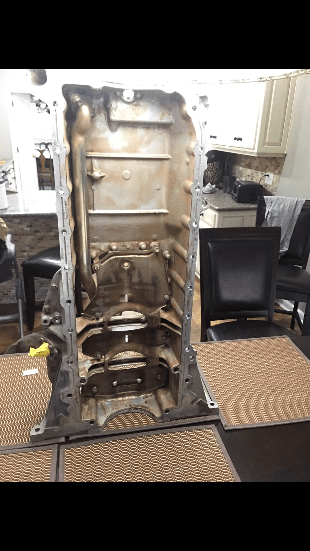

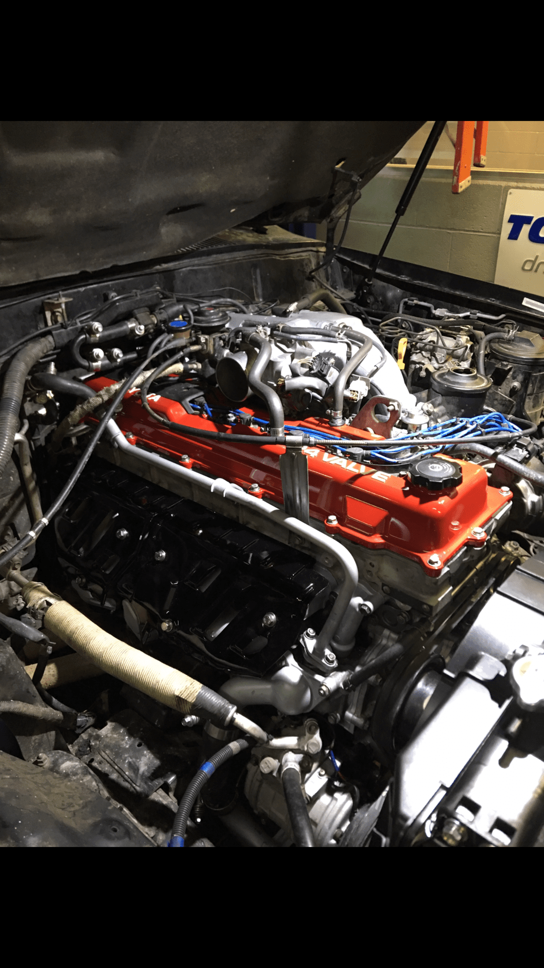

I just replaced my head gasket and replaced everything else I could. Replaced every gasket/o-ring seal from the block up. I replaced all steering hoses and all cooler hoses to each cooler. Replaced the oil cooler gaskets, timing chain ,dampener,tensioner, timing cover o rings. All vacuum lines and hoses. Vcv, vsv, fuel pressure regulator all injectors serviced flow tested, head was completely gone through and so on and so on. All OEM everything and I can’t figure out why it still does this. I steam cleaned everything and the entire egr system is like new clean.

My head gasket blew and that started me down the rabbit hole. I did every “while your in there” thing I could find because the labor to get back inside down the road for a leaking gasket or o-ring would be a ton of work. I thought that replacing all motor and tranny mounts would take care of it but nope. Maybe it’s in the compressor who knows!
