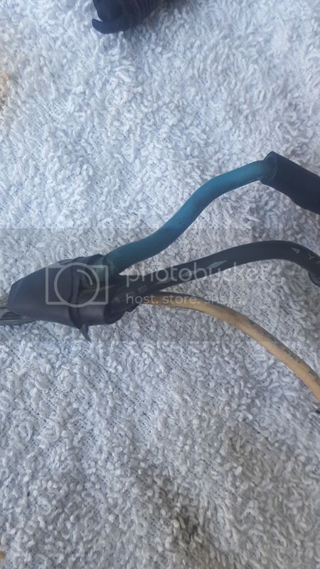

Went out she started right up today, forgot to mention there was a lot of moisture in the morning yesterday as well as rain the day before, not sure if that has anything to do w it. Also looked for and cracks and did not find anything. Decided to look at fusible link since I already bought a spare and noticed a split in the blue wire.
Could this have anything to do w the rough start, moisture getting in there?
