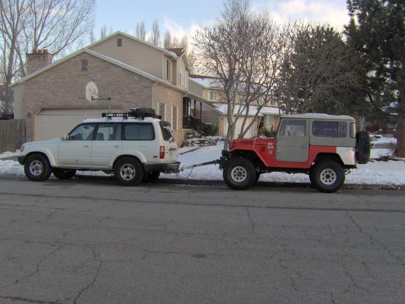

In March ’06, we headed out to Moab with the Cruiser club. I was driving the 80, flat towing the 40. Somewhere between Price, UT and Moab, the rear driveshaft fell off, and put the rear pinion through the diff housing. I never felt a thing, but when we arrived in Moab, the 40 was not drivable. We stayed and enjoyed the trip, and towed the 40 home unused on its maiden voyage to Moab.
