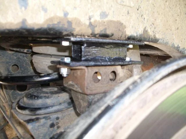

MAF- 3” front drop brackets – Yes, they are lower than running plates, or bushings, but I really like the way it drives with them. I haven’t had any problems getting hung up on them going forward, though I did have an issue for the first time this weekend trying to back up something.

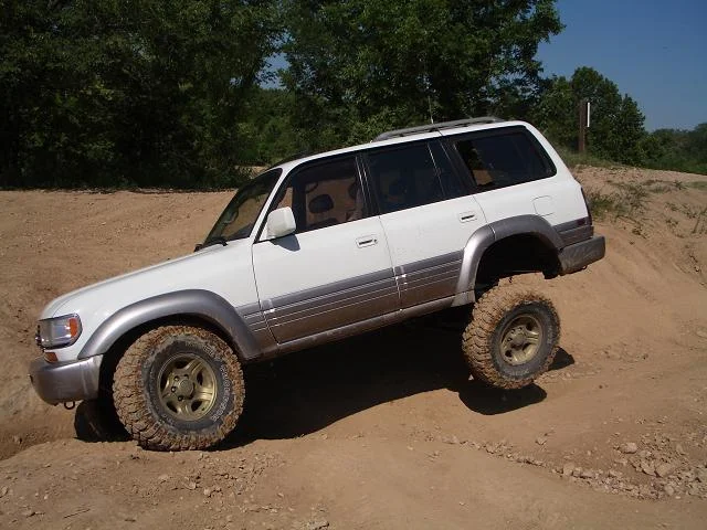

Mickey Thompson MTZ 315/75 R16’s - I painted the stock rims gold, much to my wife’s displeasure. Guess I still have a soft spot for those gold BBS’s on Porsche’s back in the day, and on the Cherokees. Yes, the white letters face out. I caught a bunch of crap for that on this forum. I figure if you’re ashamed of your tires, you hide the name. I was accused of making the first “White Trash Edition Lexus”. So, now that’s why it’s called, “The white trash Lexus”. The gold rims will probably go away some day.

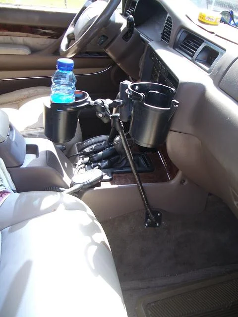

Funky cup holders – They’re RAM Mount drink holders. I did it cause as we all know the stock drink holders are worthless, and I didn’t want to pay a small fortune for a cup holder that covers my radio. The gimbles really do work to keep you from spilling your coke all over.
RAM GPS mount – pretty basic Magellin Explorist, but it does tell me the correct speed I’m going, and it does give an altitude reading.

I like the idea of the drop plates but wouldnt it be better to have a castor correction kit so you didnt have the plates to get hung up on?:confused:
Better is subjective. I really like the way it drives on the street, and I'll take that one rock out of 10,000 being an issue going backwards for the trade off.

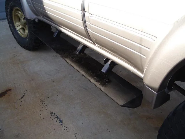

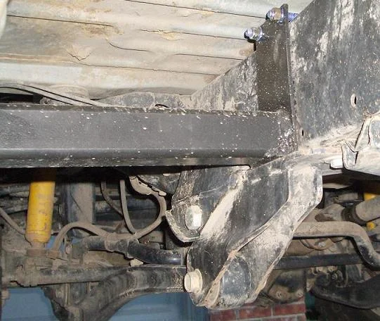

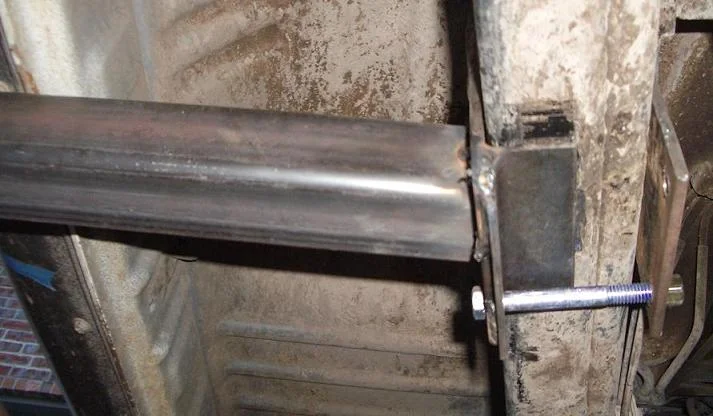

Sliders – now this is my pride and joy so far. My brother gave me a lot of crap about doing this. Said if it took me more than a weekend to build them, I was building them too complicated. I allowed myself to be goaded into doing it, and I’m happy I did. Finally got a chance to use them this weekend, and they worked great. Only problem is I don’t have the passenger side done yet! I’m 80% there, just working out the cat issues. I plan on air actuators to make them go up and down. For now, they’re just pined. One nice side benefit I found this weekend is that with the edge there rather than a tube, they work great for scrapping mud off your feet.

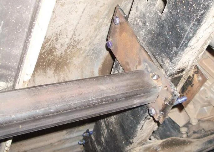

and the mounts are unique, in that I made them to go around the drop brackets and used angle to make them hug the frame tight...
edit - the mounts do have triagulated braces from the mounting plate to the outrigger, just haven't taken any pictures of them since then.

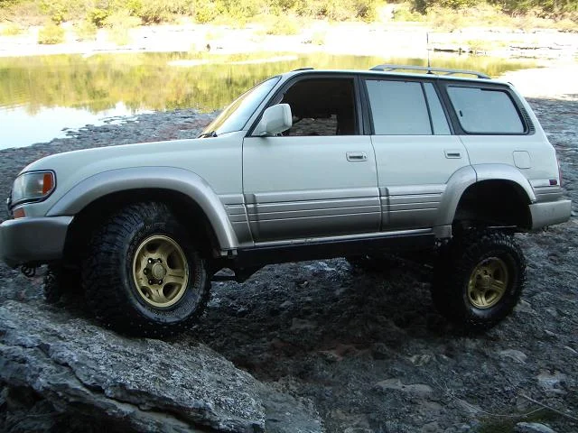

I plan on making them air powered.... which yes, will be more complex than the current pin system, but if you're going to have onboard air anyway.....

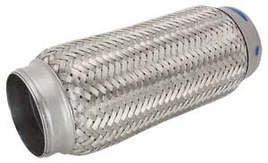

To do the passenger side and take care of the low hanging cats at the same time, I'm replacing the cats with this cat... from Magnaflow. My cats are beat to hell and leaking between them anyway. The rest of the parts came last week, I'm putting in a flex pipe too, just to keep it all from breaking loose flexing.
