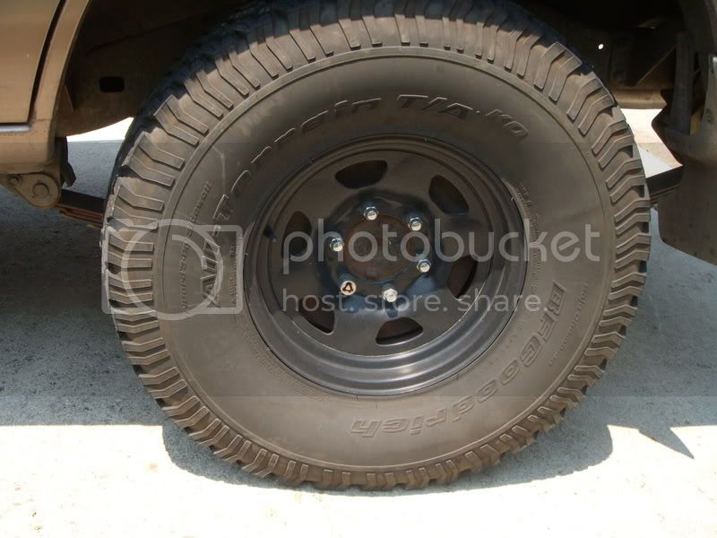

e00o-just had em blasted and then coated in semi flat black (or semi gloss if you prefer)

I left the chrome on as it was rusty in a few spots, but not too terrible. they just blasted them real well first. you could have any flaky spots filled with copper first, then coated. (It's the same process as when they chrome them, just not going the last step for chroming)

alright. finally got a pic of the powdercoating on the wheels, they're a little dirty here, but you get the idea.
