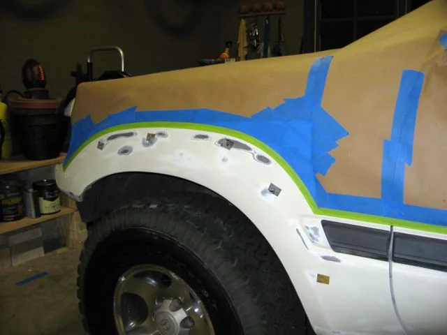

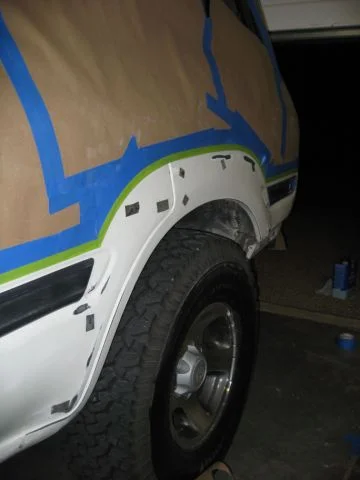

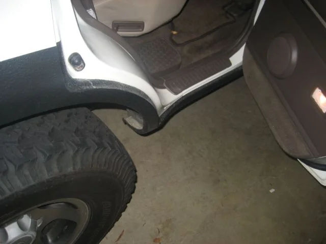

Removing the running boards is a piece of cake and I never figured just a few bolts would make such a difference in the looks of a vehicle…but, they in fact do. Removing the flares is a bit more challenging and I have attached some pictures of said process. The key really is to take your time and remove all the bolts, rivets, and screws properly and completely. I removed the rivets by almost completely drilling them out and then using a pair of extremely small needle nose pliers to twist, bend, and pull out the rest…being careful to not let them fall into the door. Removing the front flares is basically an exercise in flexibility and being small helps in this regard…as I was able to get my arms pretty much completely inside of the front fenders.
Once the flares were removed it was time to start prepping the vehicle for the bed-liner. I decided on the Herculiner product due to my friend’s application of the product on his Defender 90 and the excellent results he achieved. I visually inspected his results and was quite pleased with the product and he walked me through his application process and it seemed like it was a fairly easy product to work with.

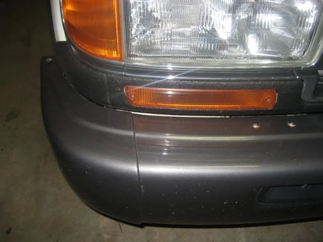

I decided that I would pretty much remove most of the parts that could get in the way. I pulled off all the lights, bumpers, turn signals, and just about everything else I felt might get in the way. I decided early on I would extend the Herculiner around both the front and rear of the vehicle. I used automotive tape for my lines and basically wrapped the remainder of the vehicle in brown “masking” paper. I decided that I would apply three layers of the Herculiner, as my friend had done the same and the results were great, thus I decided to use three tape lines. This would allow me to pull off a layer of tape after each layer of application. This takes a ton of time to accomplish; however, it is well worth it as it produces extremely defined lines. I also extended the Herculiner into the interior of the vehicle just enough to protect the interior edges and of course to reduce the appearance of any “white”.
Once my lines were laid (all three) I used my Dewalt random orbit sander and some 30 grit pads to remove and scuff up the paint. In some areas I decided to remove the paint straight down to the metal (especially close to the paint lines as I wanted to ensure that the Herculiner bonded extremely well with the surface. Once the entire vehicle was sanded I wiped it down with Xylene and then as a final precaution used compressed air to remove any dust and then one more wipe down with Xylene.

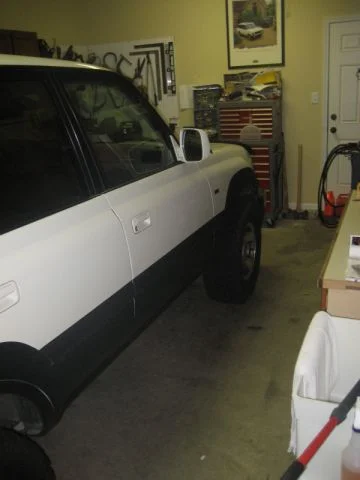

Applying the Herculiner is fairly simple and easy, I used a small 4 inch roller and sponge based applicator to roll the product on the vehicle. I had originally contemplated spraying the Herculiner on but, my friend’s Defender came out perfect with the “roll-on” approach. I took care to apply the product evenly and precisely around the vehicle and let it “set” for approximately 10 minutes before removing the first tape line. I then let the Herculiner “set” for an additional 30 minutes before applying the next coat. I followed this process for all three coats. I then let the Herculiner dry for 16 hours before removing the rest of the masking and reassembling the vehicle. The results were fantastic and I only had to clean up a few small imperfections with a tiny bit of Xylene and a micro-fiber towel.
I picked up my wife from the airport and she immediately commented that I had done an outstanding job and told me the following, “it looks much better than I thought it would and actually looks nice”. So, with the wife happy and me being extremely pleased with the result it turned out well.

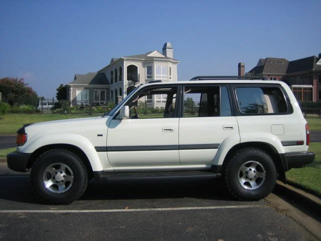

The truck after I purchased it and put on new shoes:

That picture of the herculined door jam shows great attention to detail. Very well done and nice build so far.
