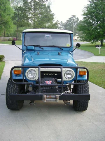

Ok enough chat, here is what it looked like when I picked it up.
Not a bad starting place at all. ;p
PO had replaced the tub with an Aqualu, installed the Tuffy, Warn, and Weber, and the PO before him had the engine rebuilt. The truck has been in NC for at least the past 10 years. I also got a pile of parts, and a soft top with the rig.

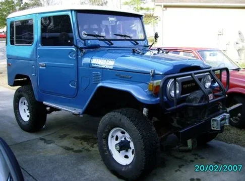

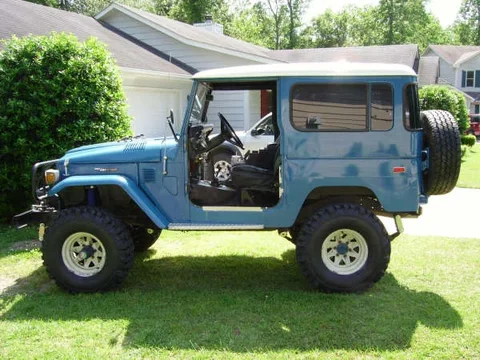

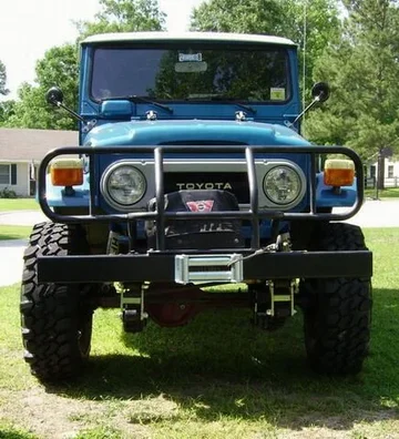

Here is what it looked like after the lift and new tires.

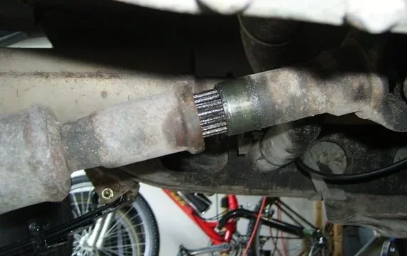

The rear driveshaft was definately the hardest thing I had to deal with after the lift. I had about an inch of spline showing.
I live in an area that is not renouned for its stellar machine shops so after three attemps with the local rednecks, I'd had enough. I decided to go with a CV and an early 60 series front shaft was the perfect fit (minus having to cut out the torque tube). Got one from another MUD member and no more issues after shimming the rear axel to get the pinion angle correct.

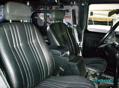

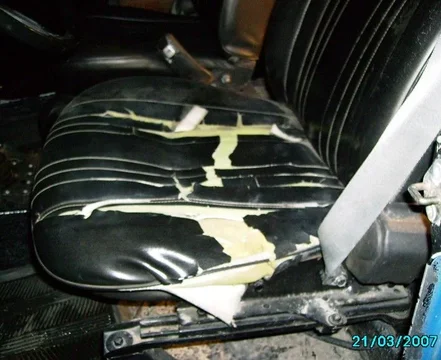

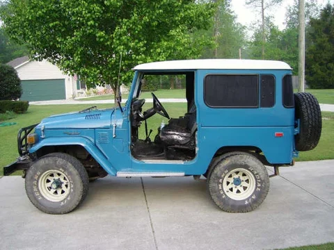

Got some new seats from DACICCI, and wheels from TEXX. I slapped on the tires it came with back on and am waiting to do a power steering conversion before I go to a bigger set, probably 35x10.5 so I don't have to get different wheels (I like the later stock wheel look).
Here is what it looks like now.

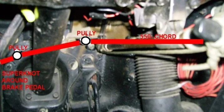

In case anyone is wondering what a superghettofab ebrake set up is, here's a photo. I used this to pass inspection, and it worked like a charm. Don't freak out people, I use this when I run into the store and when I get gas so I don't have to shut my rig off. Not to hold on steep inclines but I do believe it would work, 550 chord is strong stuff.:flipoff2: I think its awesome.

Those seats are awesome. Are they original or repros?
Check out TSL 34x10.5s. They're tall & skinny. You should be able to run them without PS. They'll look perfect with that lift and those rims.
funny you should say that, I have some 34x10.5 LTB's sitting in my garage (seen in post #2). They are bias ply and I plan on using them for my wheeling tires. They ride like crap so I was planning on getting some radials that will ride better on the street.
I got those seats from DACICCI, I believe they are originals out of his 78. There is one minor seam tear on the pass side, hard to notice though.

You know, re-building the stock t-case mounted e-brake assembly is *not* that big a deal nor that expensive! Properly adjusted it will hold the rig just fine.
