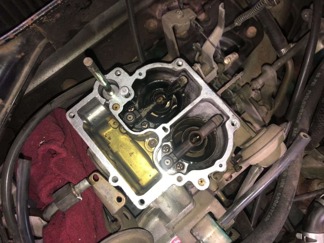

Well I was enjoying driving this thing. Took it to work last Thursday. Went to a little meet. Drove it back to work on Friday. Took it to lunch. Then after work it would not start. Caught a few times. Started smelling gas. Then I started seeing gas on the ground under the engine!
Figured it must be a float issue. Had to leave it at work. Then on Saturday it was warmer outside. I got it started. Just puttering and blowing black smoke out of the tailpipe. Moved it into the the shop for the weekend. Started it this morning and it ran great for 3 seconds. Started with no choke. Then back to sputtering.
Tore into it after work today. Brought a spare carburetor with me which had a new accelerator pump and boot. Figured it must be okay. My AP boot was torn so I knew I needed that.
Got my carb taken apart with it on the rig. Didn’t want to have to remove the whole thing. 7 screws, a 10mm, solenoid connector, and one tiny clip and you can remove the air horn with it on the engine.
Pulled my float off. Felt heavy. Shook it. SLOSH SLOSH. Squeezed it lightly and saw a tiny stream of gas coming out from the seam.
Replaced the float with the spare. Set the float height, and slammed it back together. Fired right up. Running smoothly. Drove it home. Idle is lower than before. Need to lean drop again.
Just wanted to share this experience. I’ll post some pictures now.

This spare carb was rebuilt and never run as far as I can tell. New gasket that I scavenged for my carb. I liked my AP better so I used it again. Needle valve and seat were clean enough.
All of this just to say the carb won’t be staying after this incident. @FJ60Cam might be involved :)
Honestly shocked how clean this fuel bowl is considering it was last rebuilt in 2012, and all this thing does is sit.
