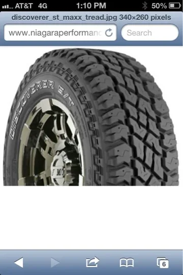

So this year I will be replacing the mismatched tires on my 1985 FJ60 with something much nicer. Truck is completely stock with no mods other than a desmog and new head unit. She has less than 200k on her and still pulls pretty strong.
The question is, I want to up to 31" tires and have narrowed it down to pretty much either the Cooper Discoverer AT3 or the Cooper Discoverer S/T Maxx (both offered in the 31x10.5x15).
The question is that the S/T Maxx is an increase of 4lbs per tire not to mention the resistance of going from the AT of the AT3 to a more "Extreme Terrain) of the S/T Maxx (not quite a MT but not an AT).
With all the said, am I going to see a huge decrease in mileage and addition wear/tear on the engine/drivetrain with the S/T Maxx? I really like both, but have fallen in love with the aesthetics of the S/T Maxx and both have gotten exceptional reviews for what I will do with them (mild off-roading, truck will be an Expedition rig at some point in its life but not a crawler).
Ok thanks guys.. that is basically what I figured but I wanted to be sure that if I did decide to go with the S/T Maxx I was not going to see a huge increase in rotational inertia and resistance which would then cause issues with the engine/drivetrain. Excited I love the look of these tires!! And so glad that they have decided to release new sizes (three different 15" sizes).
I have the ST Maxx tires in a 285/75/16. You will love them. I don't have any complaints. I haven't noticed any difference in power from my last set of tires which were Mickey Thompson's in the same size. I have had my set for about a year now and my brother has had a set on his Tacoma for about 2 years. He still is impressed with them. I let him do the testing for me before I bought my set. There are great reviews on the tires but as you mentioned one complaint was the wieght. I don't mind the extra wieght as the tire is designed to last and be very rugged in all conditions.
