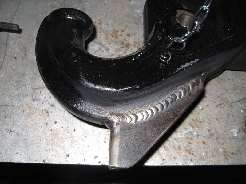

On my pintle anyway it can't go over the top because the gate is too big to fit thru the lunette very far. Under the pintle is a different story. Right now I'm thinking that a simple, robust tab welded to the underside of the pintle that would stop the lunette from being able to get it's axis of rotation forward of the "hole" that the lunette rotates thru the pintle in might prevent a next occurrence.
That sounds like a reasonable solution, and easy enough to implement. Just make sure that the lunette can't rotate so far that when you go to pull forward and straighten things out the lunette will always want to rotate back into the correct position. Also, the tab you are welding onto the pintle will end up being what pushes the trailer, so make it beefy enough to do that and you should be fine.
Got the chance before dark to hook the pintle into the lunette and rotate things around to create the arrangement that caused Volcanic all of the trouble. I verified that the lunette cannot go "over the top" due to the size of the gate, but it can go "under the bottom" and end up locked-up like the pictures above.
My idea looks like it will work. The tab would need to extend down to slightly below the point of contact with the lunette and the limiting face should be, at the closest to the vehicle, at the center of the opening in the pintle as viewed from the side. That keeps the lunette's rotational axis from ever getting directly under the center of that opening. If it can go past that point it essentially goes over-center and you'll end up with bent/broken parts.
The tab will split the pushing duty in backing up (assuming that the lunette rolls around that far) with the normal surface the the lunette is pushed by.

You would have to back the trailer straight back off a cliff before the lunette would contact my proposed tab in a simple pitch angle situation. That was one of my first concerns with the design.
I don't want to limit the rotation about the centerline, the idea is that if the trailer's going to flop that it doesn't take the tow rig with it. There have been instances of exactly that happening. One on my own family involving an Airstream and a ball coupler.
Ok. I think I understand it more now. The tab will be much lower on the pintle than I was thinking.Enough so it can't go past a point of no return and binds up.

I played with variations on that theme in CAD, but being an anal Engineer type I wanted something that was immediately re-usable w/o needing tools to do anything more than twist the lunette around enough that it would re-couple with the pintle (assuming that the up-righting process required uncoupling). I also didn't want to do the math to figure out how much inertia was needed to overcome such a limiter, meaning I needed a design where the "break-away" point was more easily tuned.

"Shark Fin" with the root pass weld done, need to wash-weld it and get some paint on it:

They don't look as good in person, and given the 1/2" thickness of the plate and the mass of the pintle I think a second, "wash-weld" pass is called for. Not too happy about how low it had to go to be effective. I'm sure that it will mark my passing when I'd rather that it did not.
