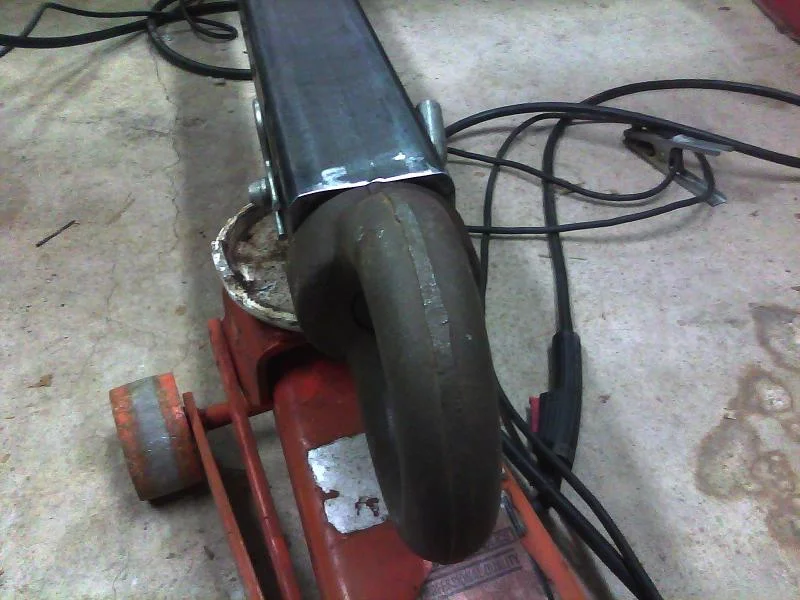

As part of my experiment with a pintle and lunette I tried to buy a rotating lunette and couldn't find one. The M416 tongue castings are seemingly pretty rare, and the lunettes are in high demand. So I decided to build a rotating lunette.
I found the ring on Amazon and those are 1-1/2" threads, something that's not clear on the amazon page. The two washers closest to the plate are thrust washers from mcmaster.com. The 'washer' closest to the ring itself is actually a Belleville Spring Washer, also from mcmaster, which allows me to set the pre-load on the thrust washers to change how easily the lunette can be rotated. I would rather that the trailer be able to roll and not take the truck with it, but I also don't want it to flop over easily. The pre-loading makes a nice friction brake for the rotation.
I know that others have pondered this and I thought seeing how I did it might spark some ideas.

At over $350 for the 416 parts and then I have to figure out how to integrate them into an existing tongue I figured that I'd have the same amount of time and be money ahead to build it. If I could have found someone selling a housing off their trailer for a reasonable price I might have gone down that road. This design allows me to pin it to any 2" square tongue.
I've not kept all of the receipts, but I'll guess that I'm about $125-$150 into this when the mcmaster parts are included (as they should be). Time-wise I have about 4.5 hours into building it. I have a little more work to do, and I see in the pic that I have a little more painting to do too. Plan is to drill the ends of the four 9/16 G8's and add a safety wire keeper so that even if the prevailing torque nuts do back off that they can't get away.

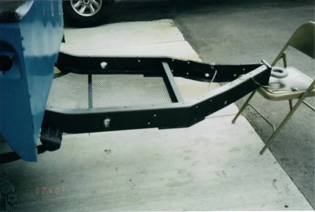

I made one as well. Not quite as ellegant as yours but rotating non the less. I just squared off and welded the giant bolt iinside the reciever stock. I run it unscrewed 180 deg. so that I have full rotation either way. Be carefull, I found out the hard way that when they rotate, they can bind up with the pintle and damage your hitch if you are backing up a hill at an angle.

I was luck enough to have built my trailer tongue from scratch. my lunette has the bolt attached to it and bolts through a plate on the trailer. kind of hard to see in this pic, but it's the best I have for now. and I have had no binding issues with a regular pintle(not a combo pintle/ball) hitch.
