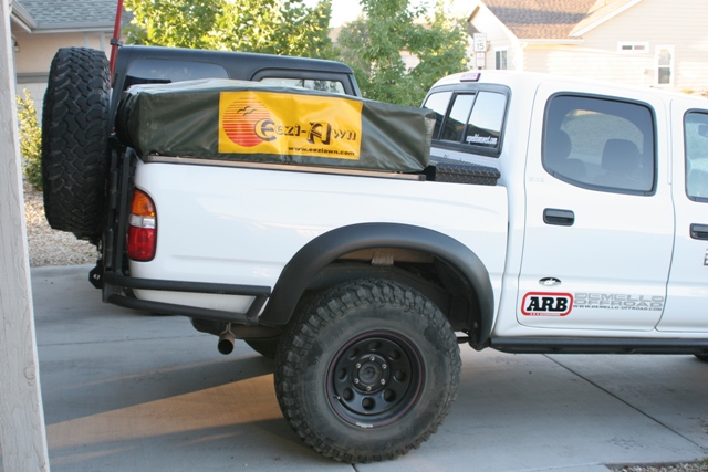

This last weekend, I installed the Eezi-Awn on the truck, on a steel rack system. It is offset to one side, which allows for a bike rack on the drivers side.
The rack system also includes a 24 gallon SS water storage tank, hot water heater, shower and rear water spout.
It is still a work in progress, but you can see the initial design.
This shows the framework and bike mount. The framework will be covered in 1/8" aluminum sheet, and Rhino Lined.

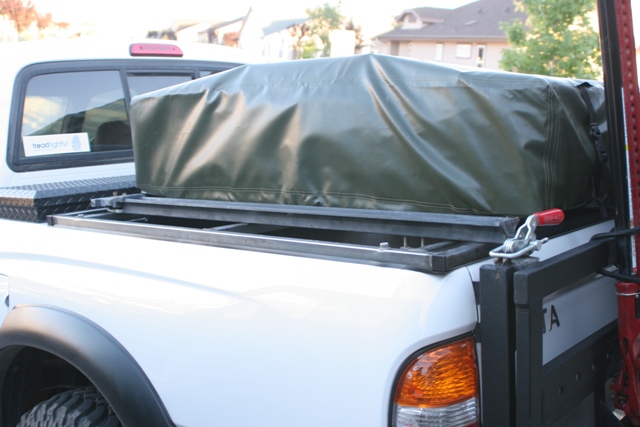

This shows the mounting from the side, and how the tent sits below the roof line to maximize CG.

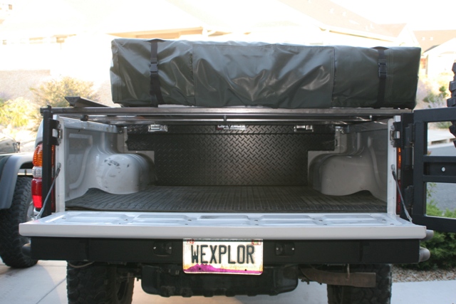

This shows the storage underneath. I am using a set of stormcases
that fit just perfect under the platform.
The Stormcase units are an iM2720 (25"l x 20"w x 12"t)

Nice beefy rack, DD. That will definitely carry the tent and a lot of other shi... er, stuff.

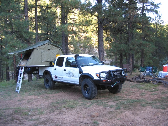

Scott - nice set-up ! looks like you don't have as far to fall as we do :D

I found a few things that stood out from the comfort department:
1. Mounting the tent lower great improves ingress/exit from the tent. It is only about 4' off the ground, which is appreciated at 2:00 in the morning after too much cerveza...
2. The Eezi-Awn uses a 3", multi-density mattress. It works like a pillow-top, with the first 2" being soft, and the last 1" much firmer. The mattress also has a high quality fitted cover/sheet that is on both sides, so you can just flip the mattress over and use it for another week or so before a washing.
3. The heavy canvas lets almost no light in with all of the windows up. This was a very pleasant surprise. At 7:00 in the morning, it seems like midnight inside still. You can leave all of the windows closed, as the tent has two small chimneys on the sides to allow air exchange.

Your tent and rack are sweet. :bounce: Have you considered having a heavy canvas made to go over the frame? To help keep equipment cleaner and out sight of others.
