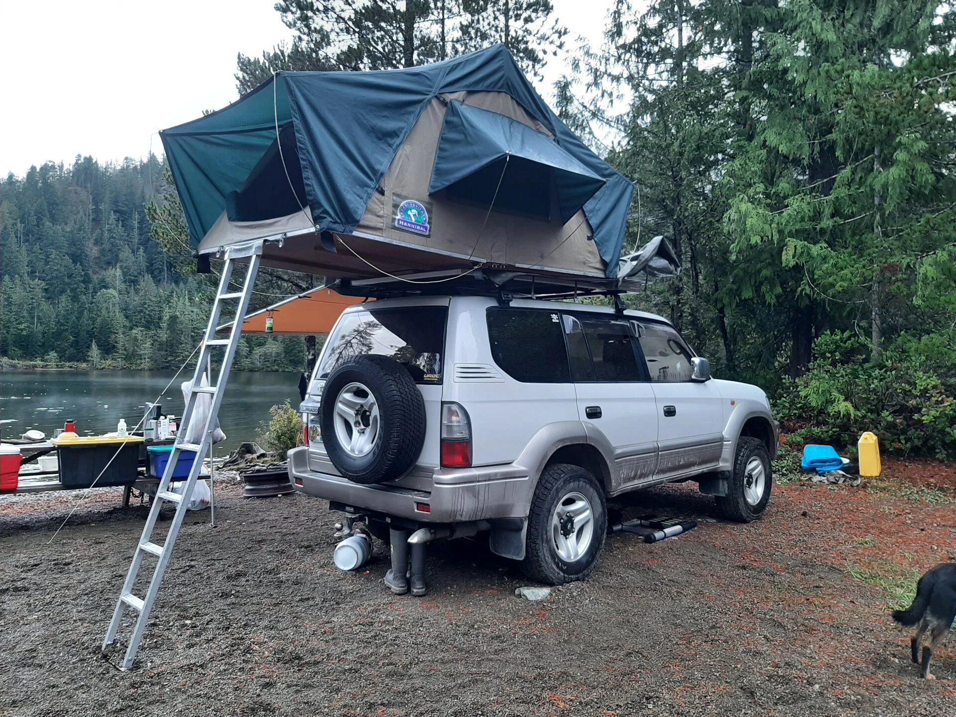

Hey wvalle
I'm chiming in here kinda late but have a look at my tent setup. Call me crazy but I've had this same tent on three KZJ's with just two Frontrunner gutter mount tower/crossbars with no issues at all.
(Active tests carried out..lol;))
