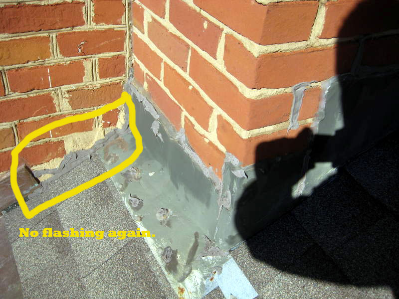

the cracked mortar is one culprit but the sealant looks old. Take a sharp gasket tool and remove the old sealant and replace it with an elastomeric sealant. Not the kind that you buy at home depot or Lowes , go find a roofing supply house and buy a good tube of sealant from them. They can even closely match the color of the brick. It will run you around 10 bux a tube but two tubes should do it. Put a little over the exposed nail heads also that are holding down the flashing through the shingles. Just fyi, the black mastic that you can buy and put on the roof will last 6 months tops and the sealant should last a good 2-3 years. It's a simple job, the flashing doesn't appear to be in bad shape so I would try the sealant first.

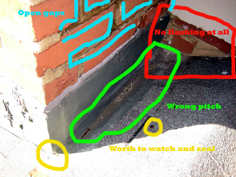

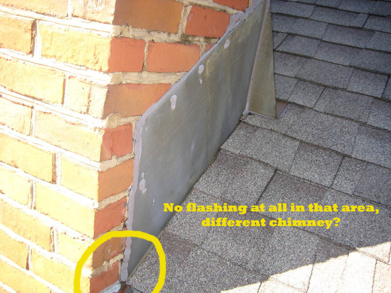

There are a lot of areas where there is no flashing at all and a wrong pitch in that valley behind the chimney. You should even have a close look at the metalparts for tiny holes or cracks at the corners/joins of the flashing.
The easiest Material for you would be a bitumen/aluminium flashband that you can heat up and put on yourself with a little hand torch.
Another obvious thing is that some of the cement on the rear of that chimney seems to be permanently wet and has some cracks. You may seal these areas with silicone chaulk.
