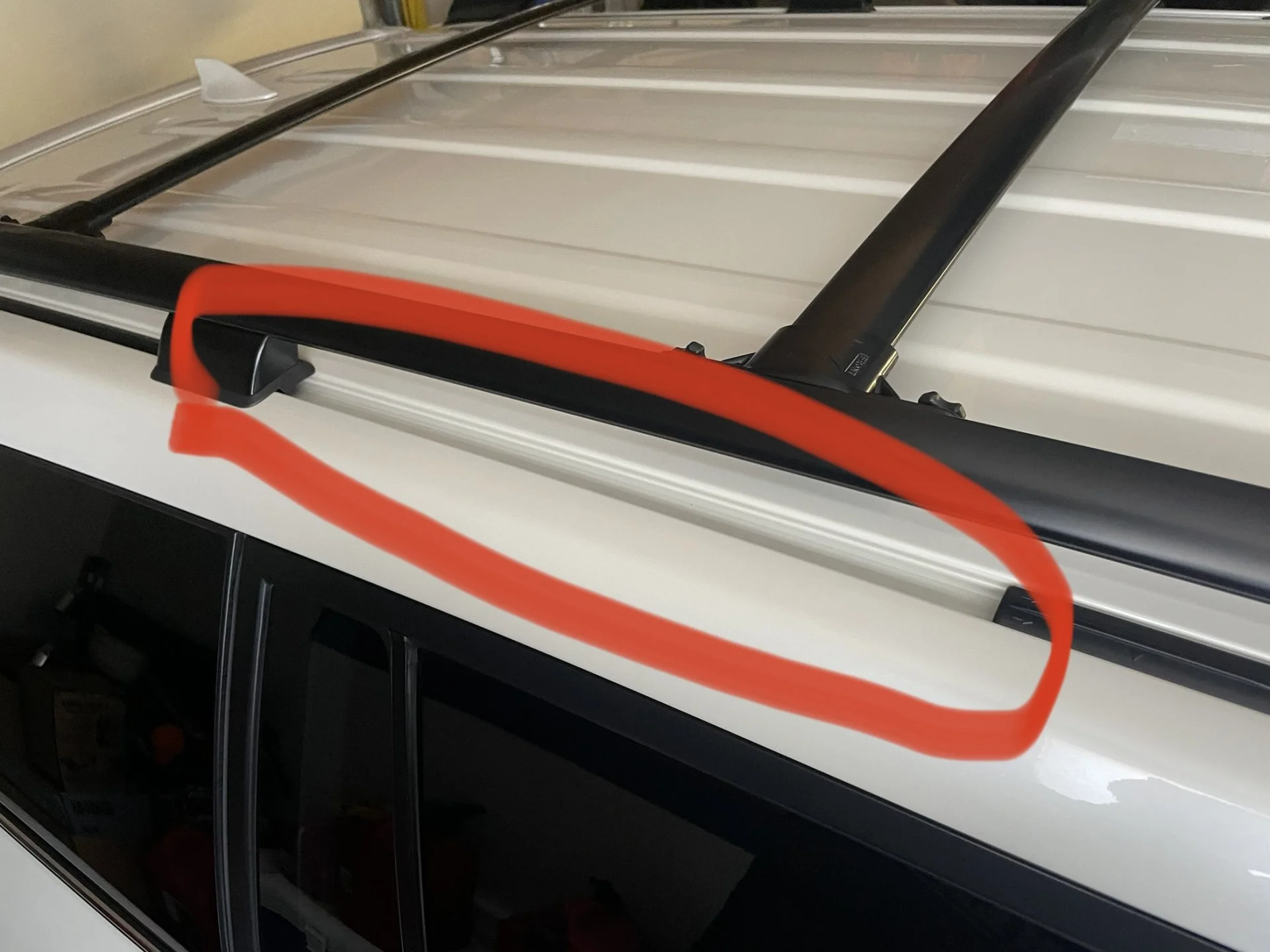

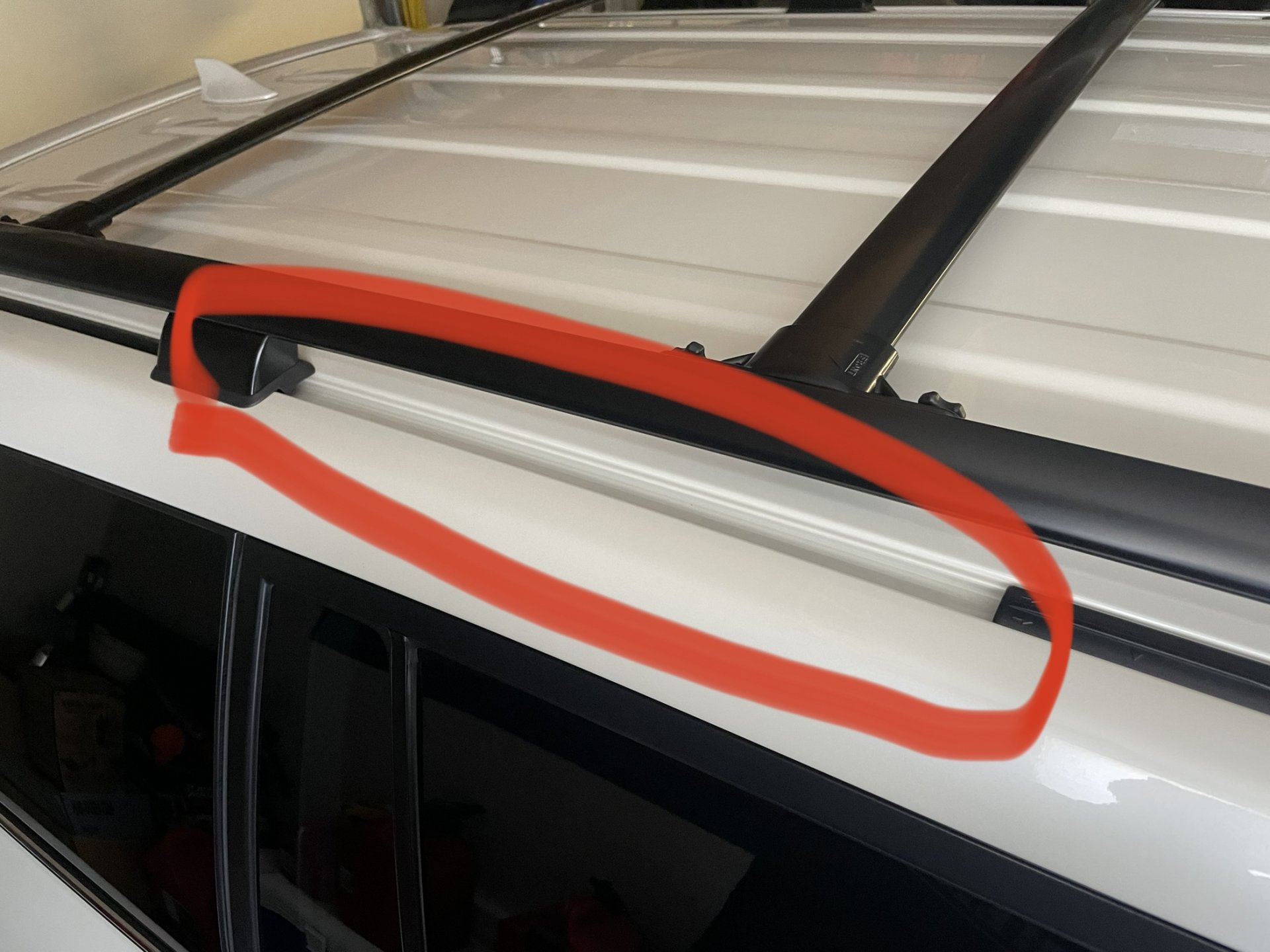

Can anyone confirm the piece missing in the pic is this part #? It is passenger side just above rear passenger door. Thanks.
Note that there is a metal strip molded into the center of it. If it is bent during shipping it will tend to pop out and get lost too.
Just work it straight before installing, then as long as the gutter it rides in is clean it should stay put. I've taken to pulling the trim strips and cleaning out the gutters once per year.. my rig lives outside but it's impressive how much crap gets stuck in there and starts to decompose.

Thanks!
I installed it this afternoon and just made a 250 mile road trip. Its still there, so hopefully good to go.
