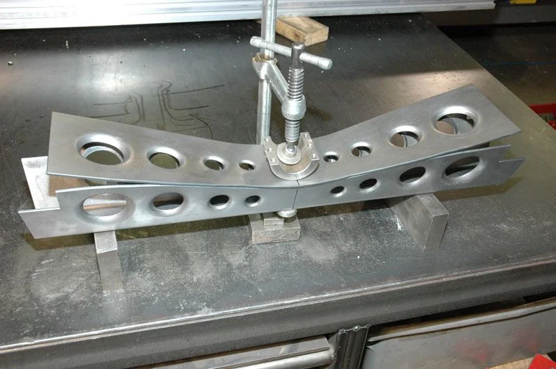

This jig makes me feel better for some reason.
C clamp, part of a tube connector and away you go :D
I was figuring you would have something laser powered for small bends like this ;)
F'n awesome radiator mount..
