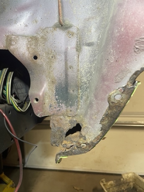

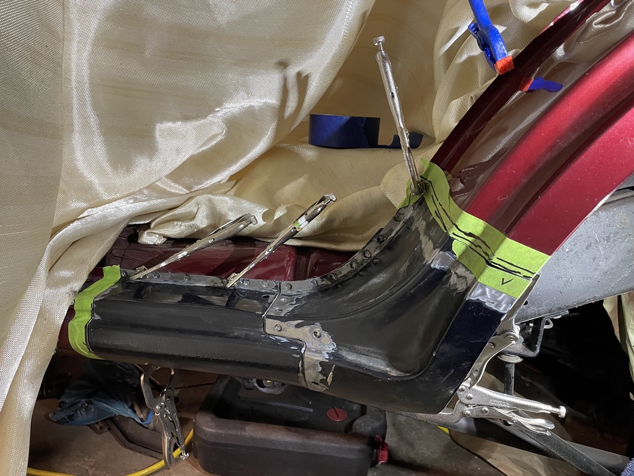

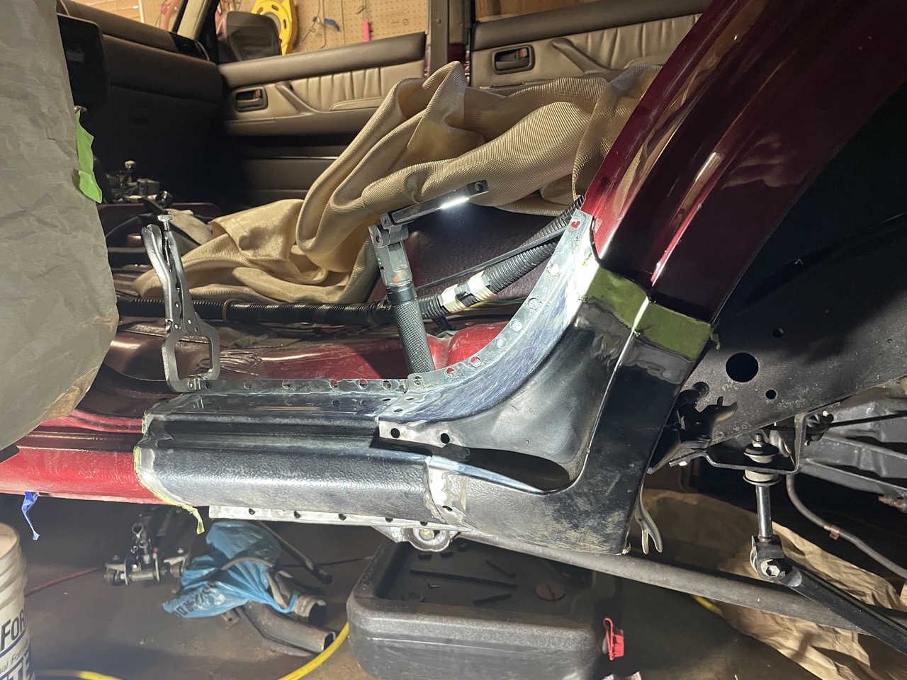

I was finally able to get some time with the project. I got all the rotten structure out carefully so that I can start putting the new ones in.

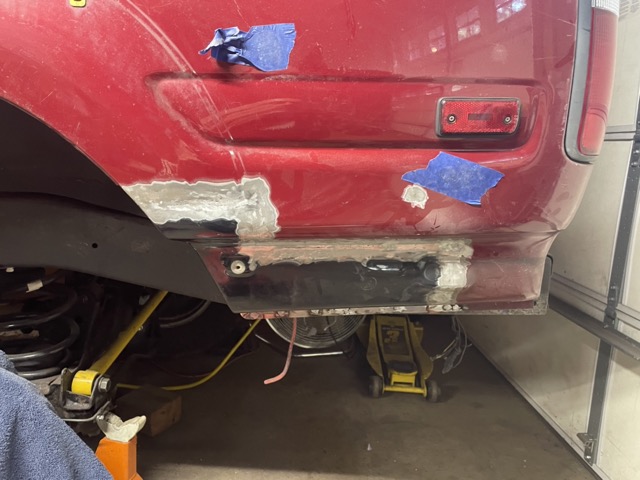

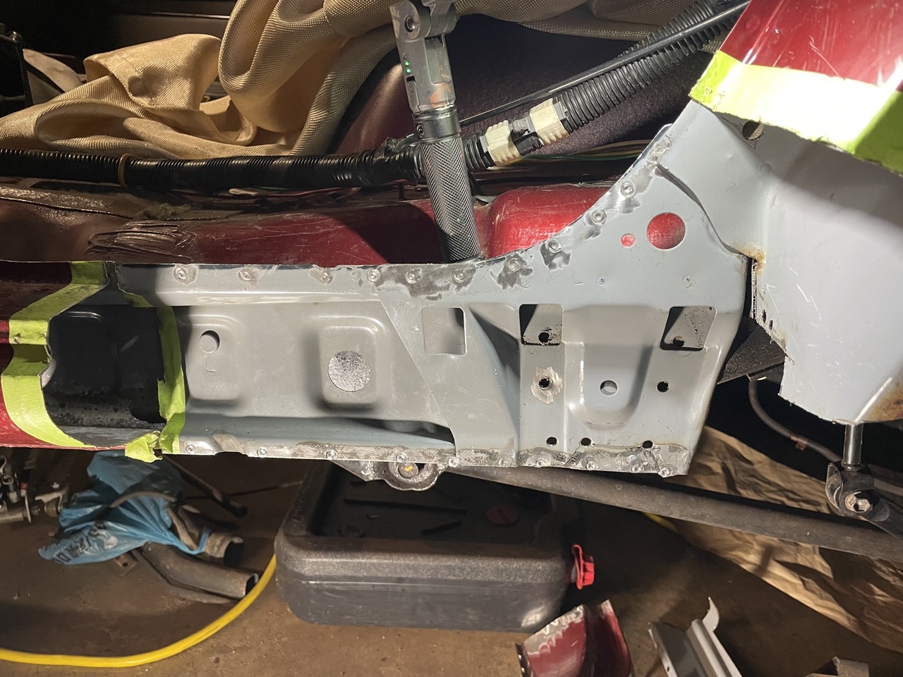

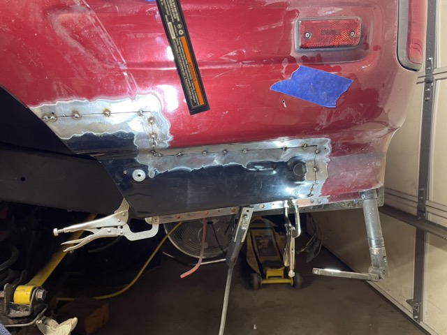

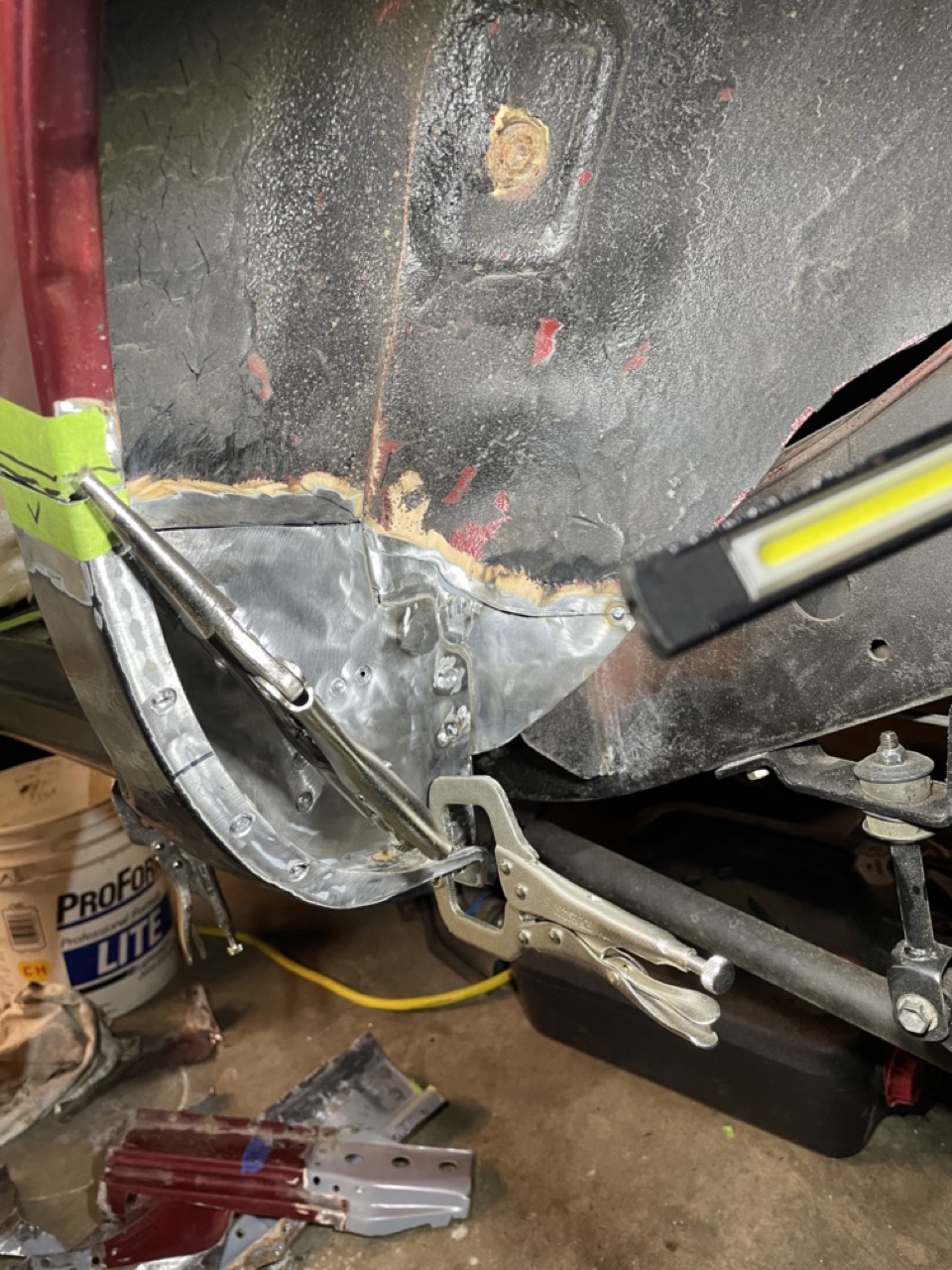

See below for mocking up (clamping) the new panels in. Looks much better.

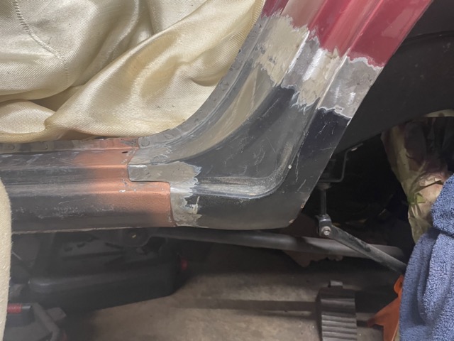

What is the yellow stuff that Toyota used to seal all the seams and panels? Also seem to use it for a thick barrier. In places it looks like some kind of seam sealer and in other places it looks like body filler. Any idea? I have even thought it could be something like liquid nails.
what kind?
SEM offers a very similar sealer, it’s even the same color. Toyota sprayed it on.

Exactly! It’s flexible after it cures. Paintable, and keeps the water out, so no rusting on the seams! Pretty sure OEMs use something similar.
OEM is automotive seam sealer.
