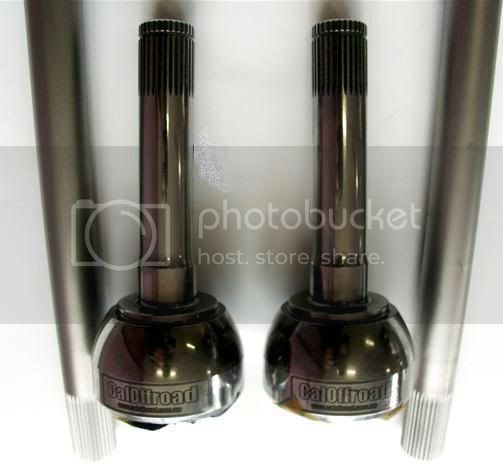

axle strength
I have stock 33 spline G,Q axle's under my 45 runing 37'' tyre's with v8 and have bounced the crap out of it on a fair few occasion's and have not yet broken one, i have spare's to put in but i'm looking at getting chromo axle's/c,v from Cal offroad there the stongest i've heard of so far.

G,Q
Yeah as said G,Q is a type of nissan, there a 33 spline on the rear and 31 spline on the front, if you look at the website cal offroad - nissan axle's and c,v's there is a bit of info, their claiming to have built tried and tested the world's toughest chromo axle's and c,v's.
I can't remember what their breaking strength was but it was a huge figure.
