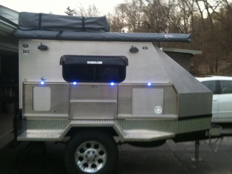

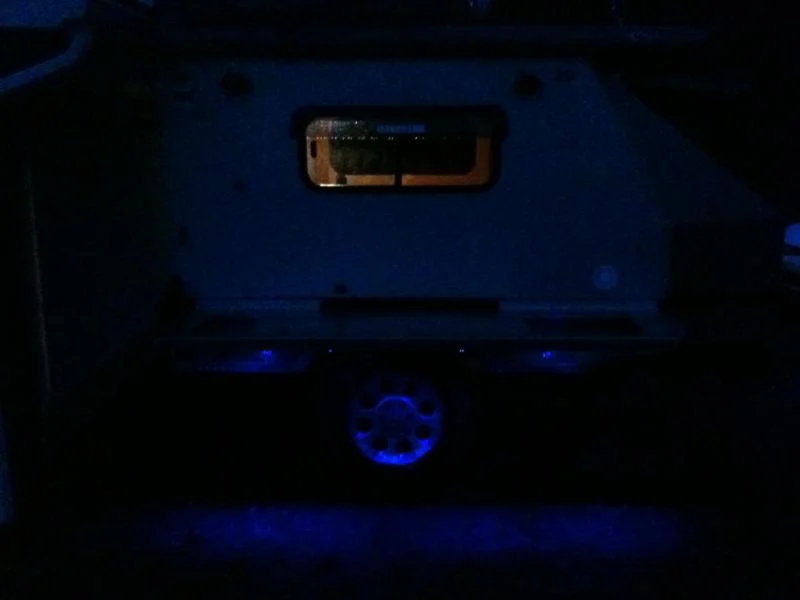

Did some more wiring, picked up the insulation, and added some lighting under the kitchen counter. The wiring is all done!
The spots work great over the counter, but when you need something from the plastic cases stored under the counter....it's flashlight time.....but not anymore!
sorry for sucky pix.....inferior cell phone quality

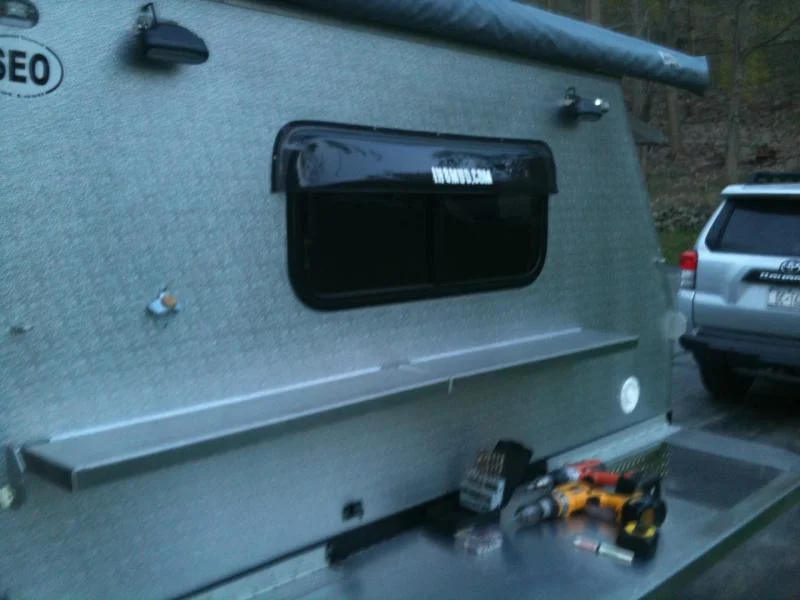

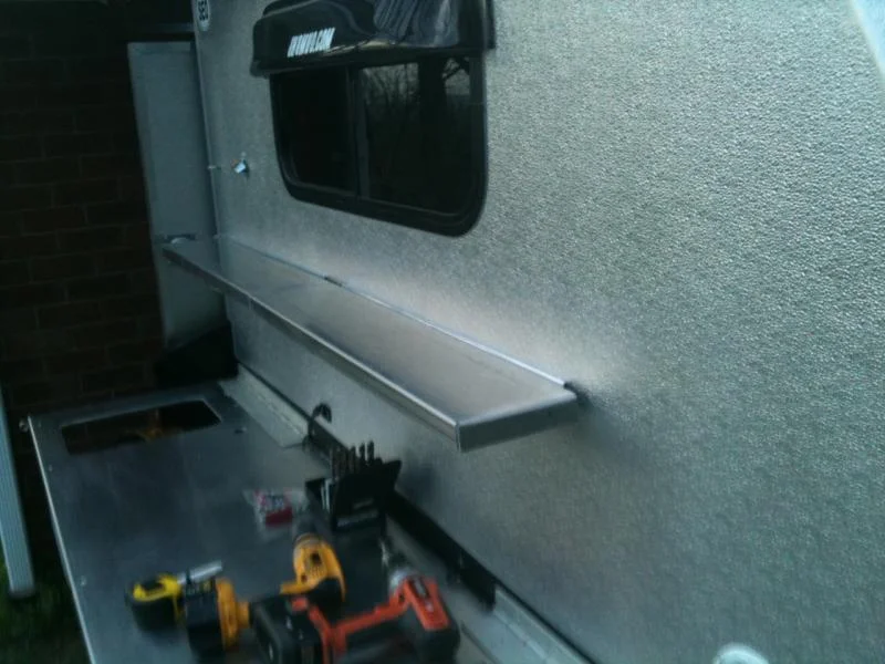

4/26/11 Also added a few aluminum shelves using those sweet brackets Jeremy posted...thanks bro!:cheers:
They sure will come in handy to clear up some counter space

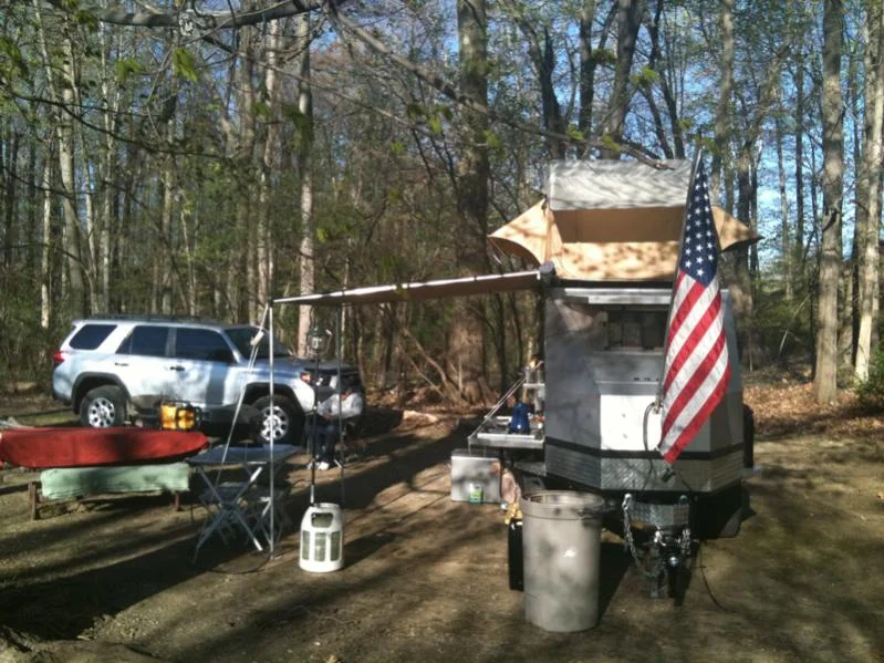

First trip of the season....still a few bugs to work out.
Bottom line.....
Had a blast!

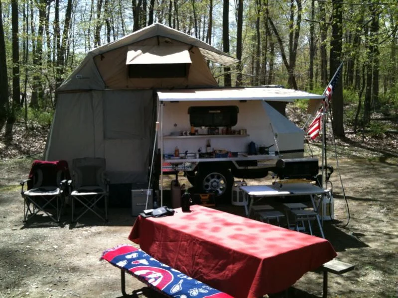

I like the exterior work/kitchen shelf and lighting!
How do you store it when you are on the move?
Thanks Jim!
In post #202 you can see the travel position....the shelves store inside, and the sink and stove top fit in a container, and just pop in. I did add an extension to the sink drain, that fits into my 5 gal. grey water tank, so no more "splash" from the sink.
The new shelves helped to free up some food prep area. I also scored a nice "fold up in a bag" aluminum table(under the grill). The aluminum seats were cut off one of those folding picnic table units, I bought bent at a garage sale. Cut the 4 seats, that were flawless, and chucked the bent table. The seats also double as end tables while around the fire.

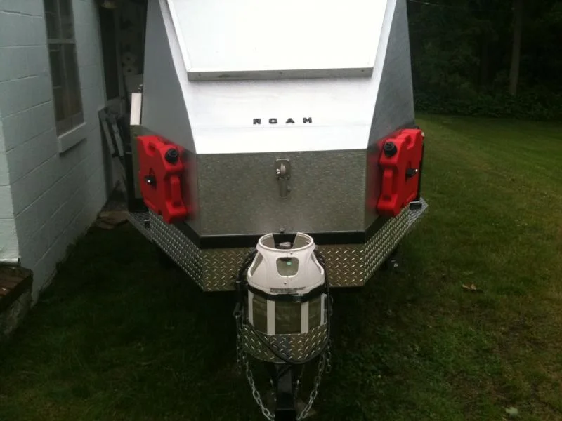

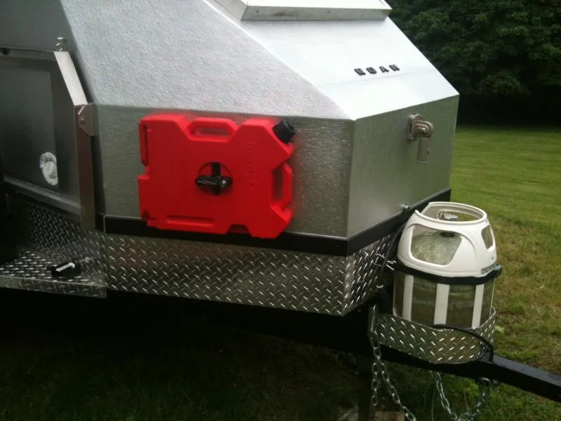

got me some of them thar' new fangled Rotopax w/locking handles for the nose of the ROAM....the 2 gallon models from TRDParts4U...great price, and the fastest shipping in the west. Jacque Rocks!
