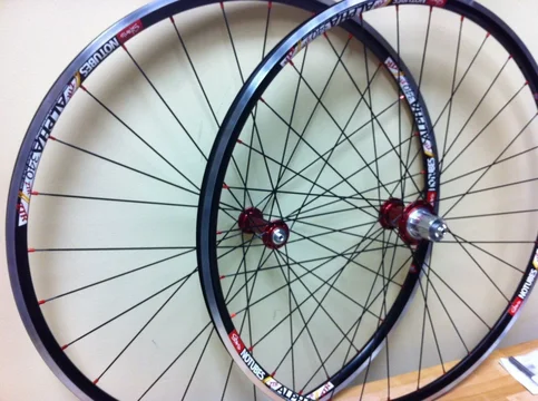

Jon, I'm a pretty avid cyclist. I run a set of tubeless on Stan's rims and Alchemy hubs as my everyday wheelset. It's a great everyday setup. May I suggest you check out a custom built wheelset. Given your budget and parameters you'll be able to find something much better than the Zipps for the money.
Ben-
