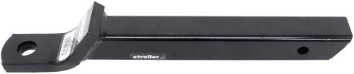

i'll re-hitch the trailer tomorrow and take some measurements with the camera at the right level. I got some info. I spoke with James (at RLC). Super nice by the way. He said the what people have done in the past is extended the tongue of the trailer. He also said if i don't mind the tire off center he could probably shorten the arm by about a foot. For that arm measurement i could base off the Slee length with @Markuson kindly sent (38"). I then spoke with Ron over at Bivouac trailers. He said all his jeep customers have this issue. For them even worse because the whole door swings out. He recommended an extra long receiver that he said adds about 10". By far the cheapest option too. So, basically leaves me with a bunch of measuring to do, but theoretically still possible. I need to see exactly how much length i'd gain with the longer receiver, then see what the max length swing arm would be while pivoting on that axis. Thanks all for the help, I'll keep you posted. Nice to have a guy like James that's up for customizing and changing things around like this.

This might also be an option if the long receiver isn’t long enough. This could add another 18” to the tongue. Not sure if this would mess the weight distribution too much. I hear is generall a longer tongue is easier to tow, and easier to backup
