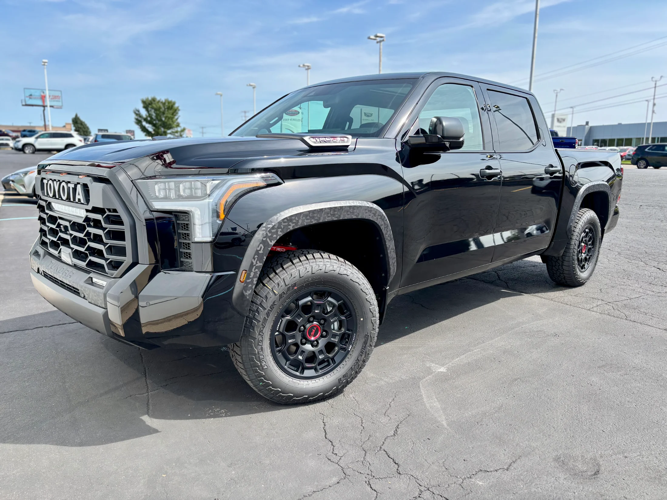

2026 TRD Pro - 4 miles on the clock (first NEW truck I've ever bought for myself)
TRD Performance Package - advertised 469 HP, no mention of increased Torque numbers beyond the 583 but I truly wonder if it's not a little higher
Opinions vary widely on the Performance Package, I understand many people don't see the point, but after driving underpowered Toyotas my whole life why wouldn't I jump at the opportunity to drive the 3rd most powerful production truck on the market right now? And the full warranty is the other bonus.
