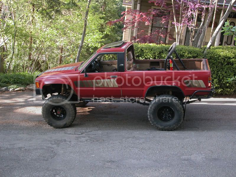

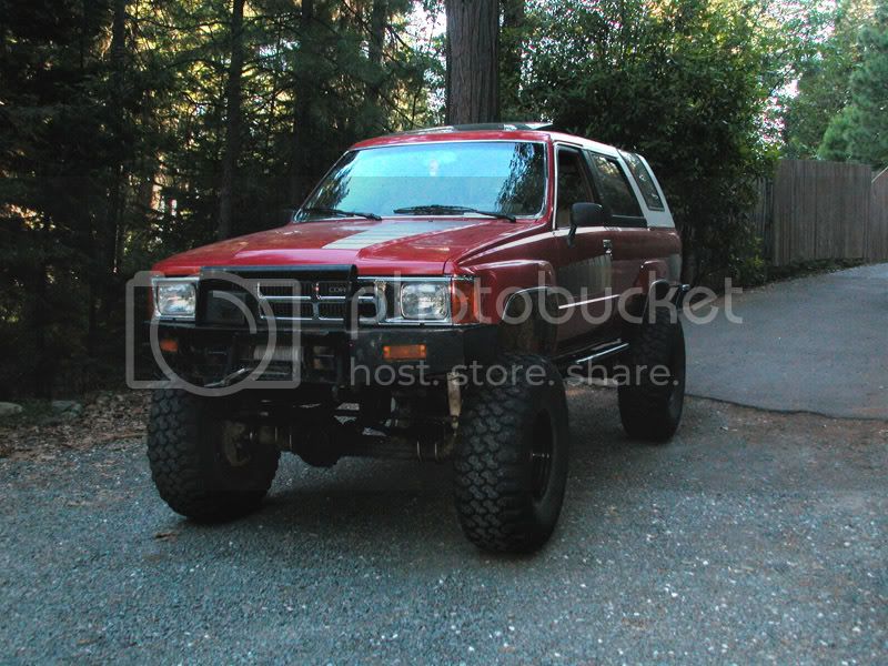

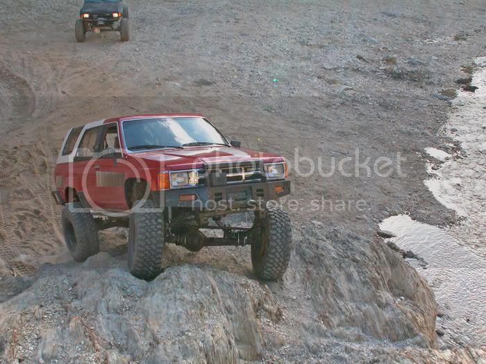

Hey everyone. This is my Rig of the Bi-Week post for my 1985 Toyota 4Runner SR5.

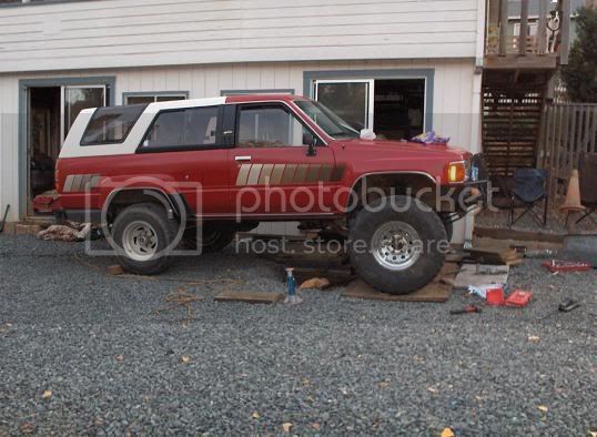

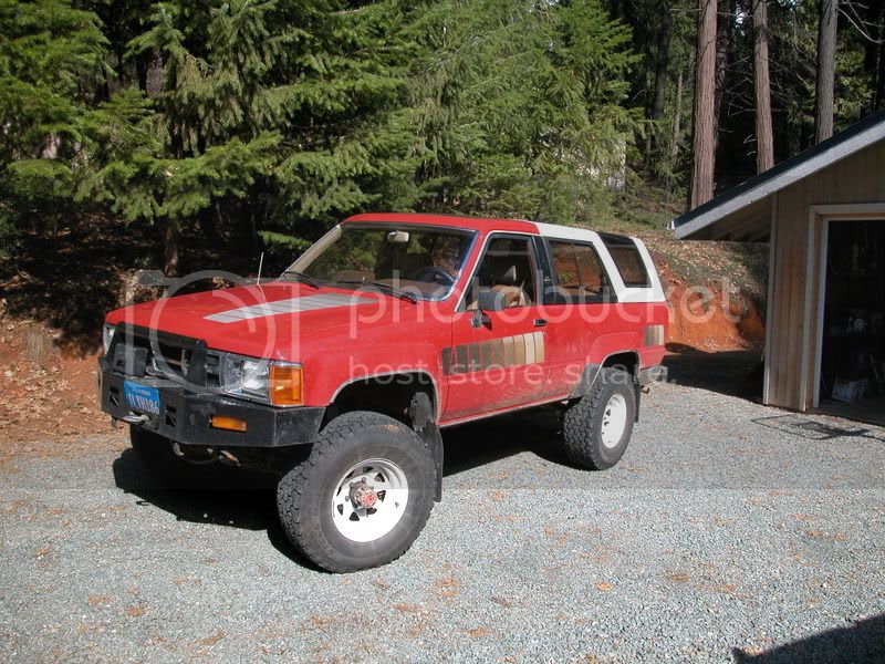

I bought the truck in January of 2005. When I got it, it already had a 2" NWOR spring lift, Marlin Crawler 4.70 case gears in the single t-case, an All Pro Tcase crossmember, an unknown rear limited slip, custom front and rear bumpers and 32" all terrains on 15x8 white steelies.
After about a year I had found my boundaries. It did excellent but the tire size was really limiting me. I had been researching for a while so I figured out how I was going to build it and started stock piling parts.
Here is the basic plan (it has been reworked and modified several times but this is what i finally came out with):

Here is my Crawl Mag blurb...they fxxxed up my axle info though :(
Thanks! It has taken what seems like forever to get the truck where I want it but I am really happy with how it has turned out. I had originally planned to keep it at 35s but I am going to go 37s when my coopers burn up. Probably going with either MTRs, or BFG (original style) mud terrains. IMO 4runners look like they were meant to have at least 35s, just looks natural :)

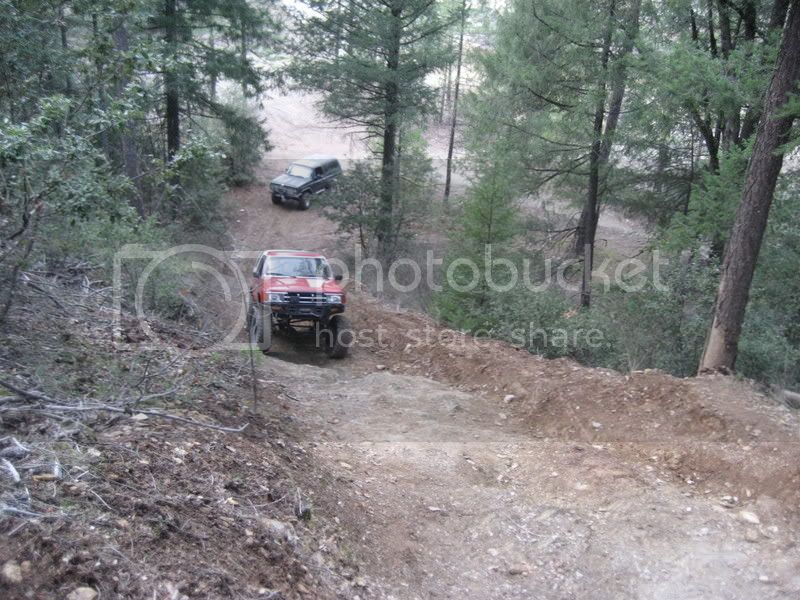

I live in Nevada City (Right next to GV). I have heard of Deer Valley but never been there. If you go on a run let me know. Always down to check out new areas. Planning on hitting Fordyce and Rubicon mostly this summer (havnt been to either yet) but anywhere I havnt been is cool with me!

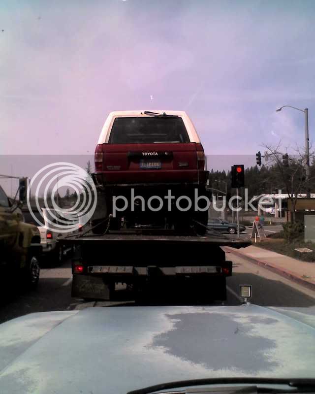

Little carnage update....on the way home the morning after a St. Patty Day party I blew a bearing in my rear transfercase. Luckily I was only going about 15 mph because when it went, all 4 wheels locked up. I had to screw with the gears in both cases to get off the road. I had just driven about 20 minutes on the freeway too doing 65 mph....REALLY glad it happened when I finally got off the freeway. I had a friend who blew one going 70 mph and its a miracle he is still with us today...locking up all 4 tires going that fast would not be fun!! :eek:
Here she is on the flatbed headed to my buddy's shop....

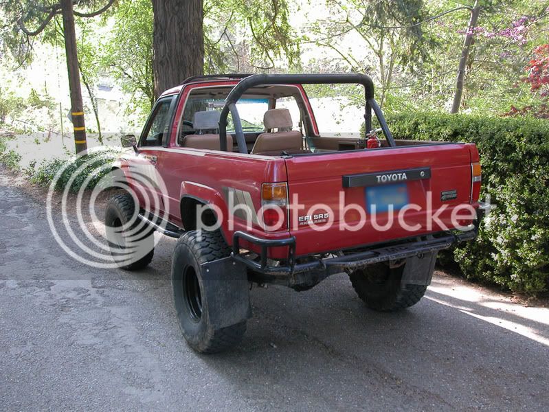

I did take the top off for the first time in 2-3 years, love cruising with it off I am just nervous about people jacking my stuff, otherwise I would leave it off all summer. Thats about it for updates, getting ready to hit Fordyce at the begining of June. :clap:
