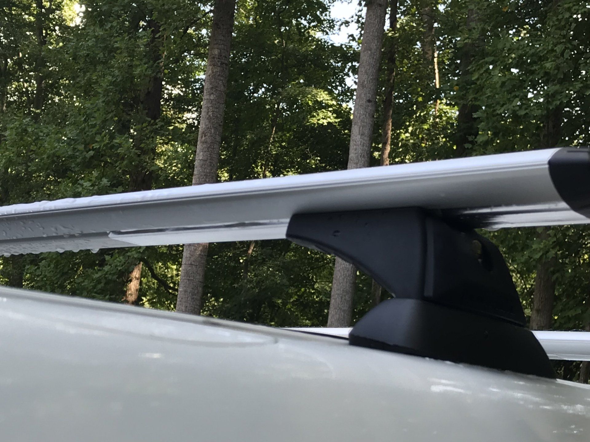

Received my Rhino Rack Vortex in Aluminum ‘Silver’. Old rack came off pretty easily, but I took time to clean the gutter and molding from 20 years of gunk build up.
One tip for installation, I sectioned the metal gutter molding (lost patience with using Dremel) and removed approx 4 inch piece where you have to open a spot for the B pillar bolts, see pic.
After mounting, I noticed whistling at 60mph. I then applied super sticky foil duct tape over the exposed underside adjustment channel on each side of leg. This solved the problem. No noise whatsoever-happy with this product. It’s very low profile and solid. Now to mount RTT!
