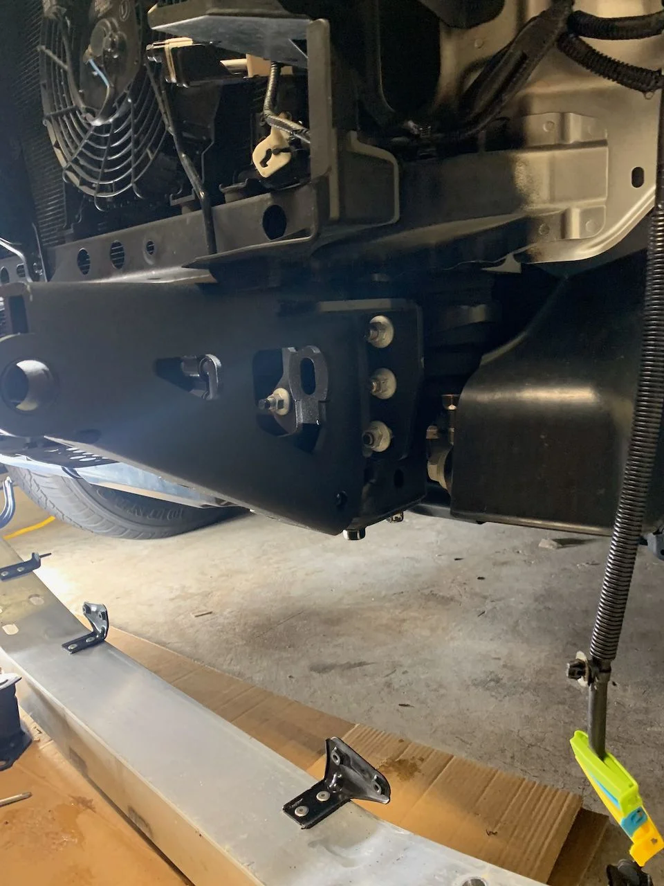

It probably took me 2-3 late evenings in my cold garage with a propane heater. I originally mounted the bumper too close and tight. Ben pointed that out after I sent him photos. So, I had to go back and loosen everything up and adjust - that's the most important step IMO. You need to fit the "meaty" portion of a finger between the bumper and the quarter panel to allow for flex.

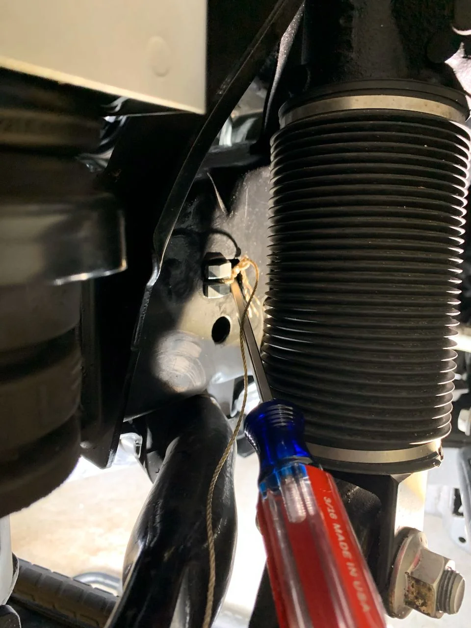

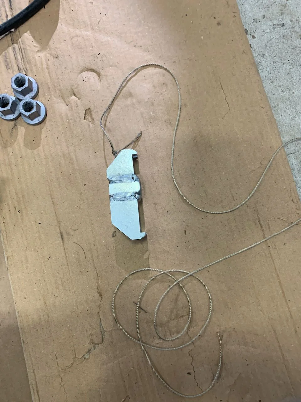

The step I got stuck on is below. The black & white install doc doesn't clearly show how these things get installed in the frame. They look like bats and you connect them with the long ~ 8 inch threaded rod. I made the mistake of dropping the wing in the frame a few times (passenger side) which is a PITA to retrieve. I can't imagine trying to retrieve out of the driver side frame because it's trickier to get to. I tied a string to it just in case. The pics show the hole in the front support bracket that connects to the frame (5 bolts plus the long rod). You need to put the rod through it and connect to the bat wing bolt inside the frame, it takes some patience.
