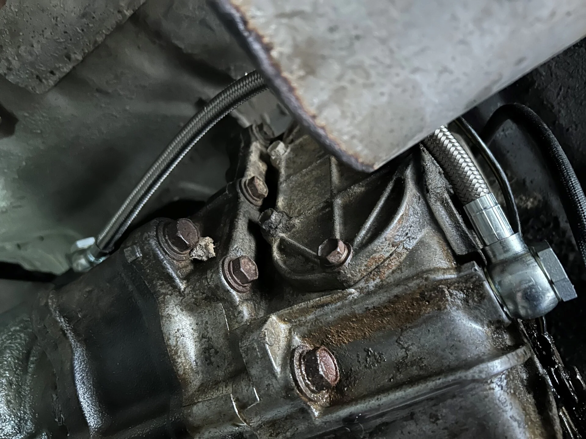

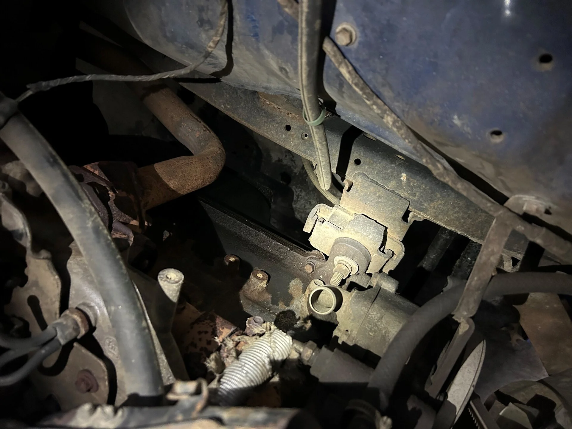

1st - My motor mounts are different in the way it is connected. I know it wouldn't hurt, but if I get new motor mounts are they different for rhd 60s in regards to engine placement?

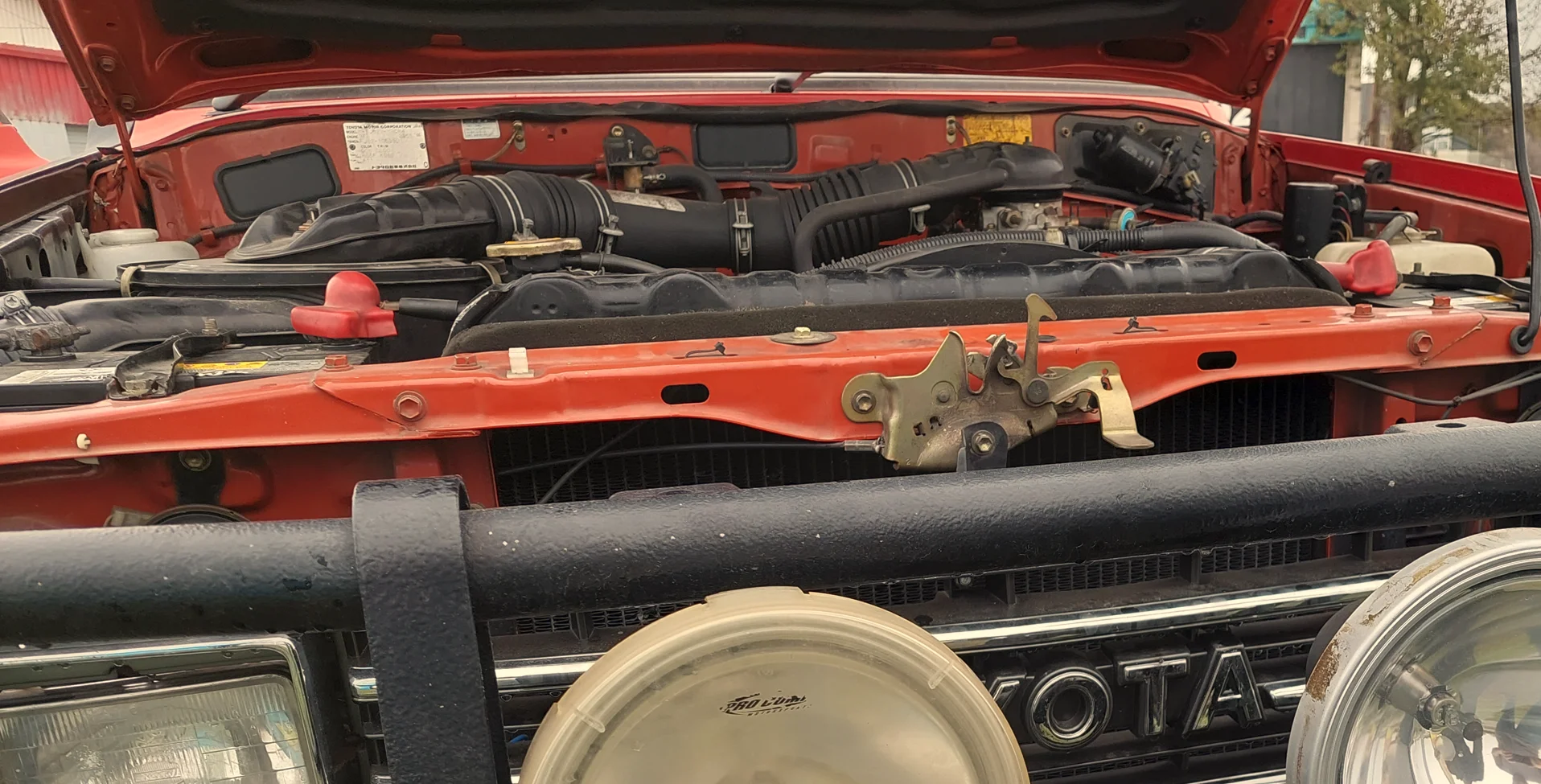

2nd - Can someone with an RHD 60 post a picture of the way their hood release cable is run? I suspect mine being run along the air intake and zip tied to my top radiator line isn't the best solution. Also, what's a good solution to fix the cable fraying at the latch part?

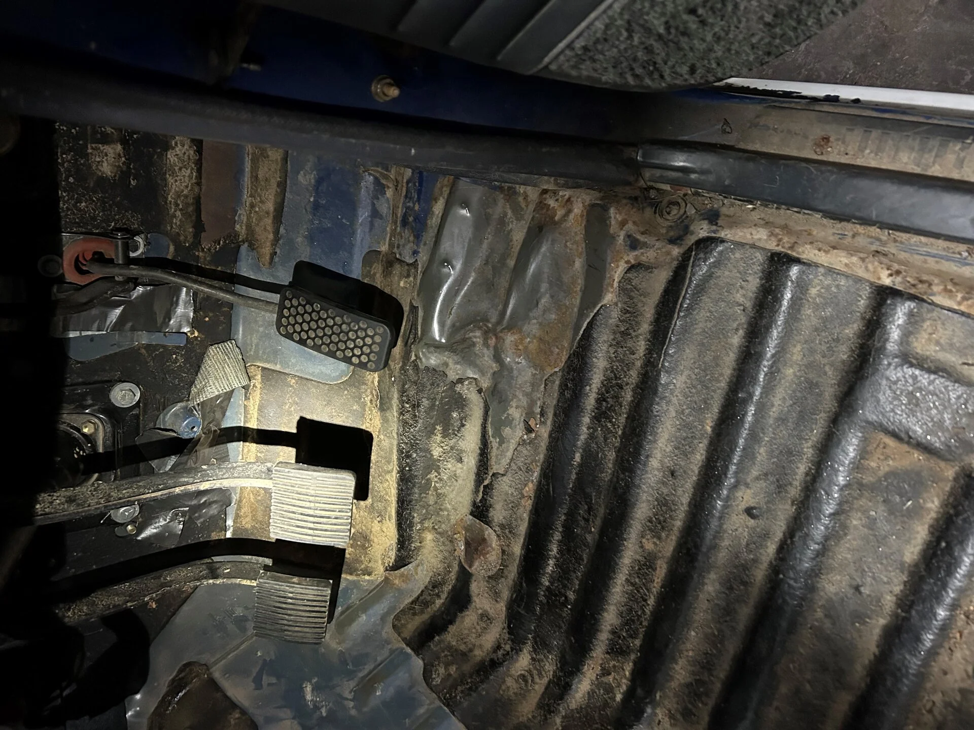

3rd - Suggestions on how to fix this massive dent in the driver's floorboard?

I'm not sure on your other questions, but this is how the cable is run on my RHD 62-Series.
It comes through the firewall, under the airbox and around the battery, snaking through between the radiator and core support.
I ordered a new cable and latch assembly from cruiserparts.net because of a damaged cable and latch tab. They are specific to RHD vs LHD.
-Rob
-Rob

@83Frostie , welcome to this asylum for the toyotaly insane, with all the mad dogs n englishmen. oh, n 1 or 2 that claim viking :grinpimp: @RivMan was able to assist with one of your queries, i may be able help with the floor. if you can some how brace up under the dash then with your jack push down till flat. i mean something pushed it up so push back.

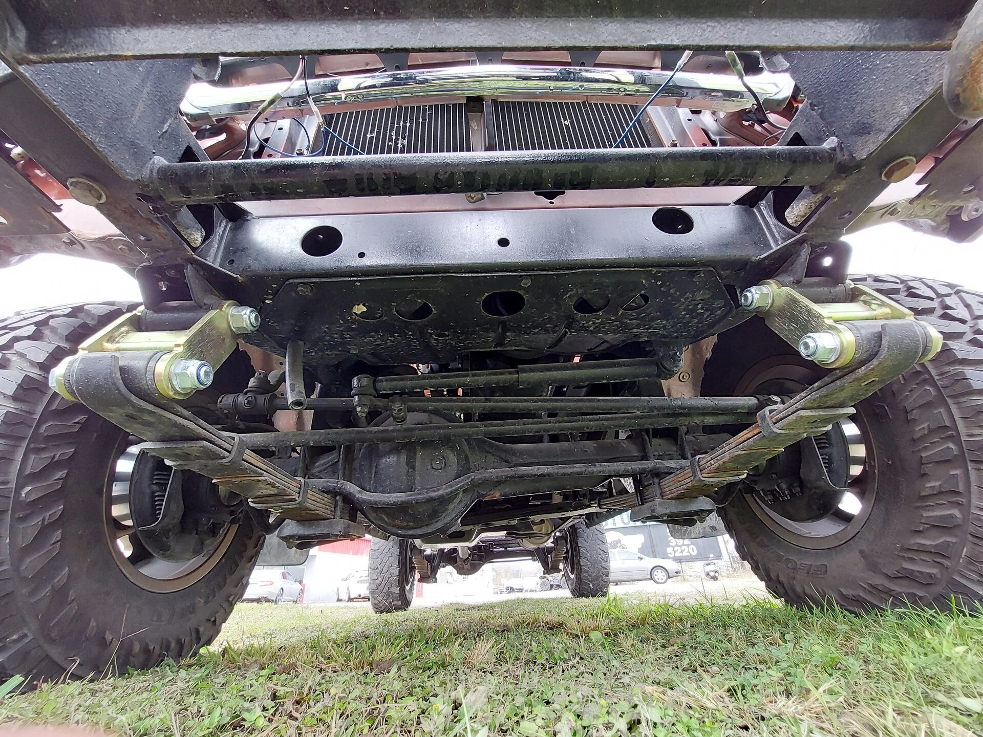

Quick question. What size wire should I run from a 12v battery to my Blue Sea fuse block? I am having a hard time finding the size of the wires to run from the positive and negative terminals to a Blue Sea fuse block.
Finally attached my bypass hose about a week ago.
