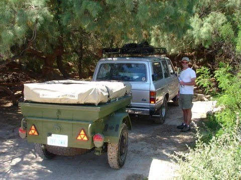

I know this is reviving an old thread, but I got back from camping at Big Bend National Park last week with my restored M101 and the Mombasa. I have to say that this tent was awesome. It made the trip easier and more enjoyable, and I slept like a baby every night. It was my first real trail run with the tent.
It was VERY windy the last night we were down there. The only thing that I would do differently would be to use the tie-downs that come with the Mombasa, as the rainfly flaps around a good bit.
Overall, this thing is a 9 out of 10 for the price. Here are some pics...

The pic with it open on the trailer, It looks a bit crooked?!? was there an issue?
Very slick, I cant wait to try ours out in better weather.
The cotter pins for mounting the tent are smaller in diameter than the holes in the brackets they go in, so there is some play which makes it lean when empty like that. It levels out when you are in the tent, though, so I wasn't too worried about it...
