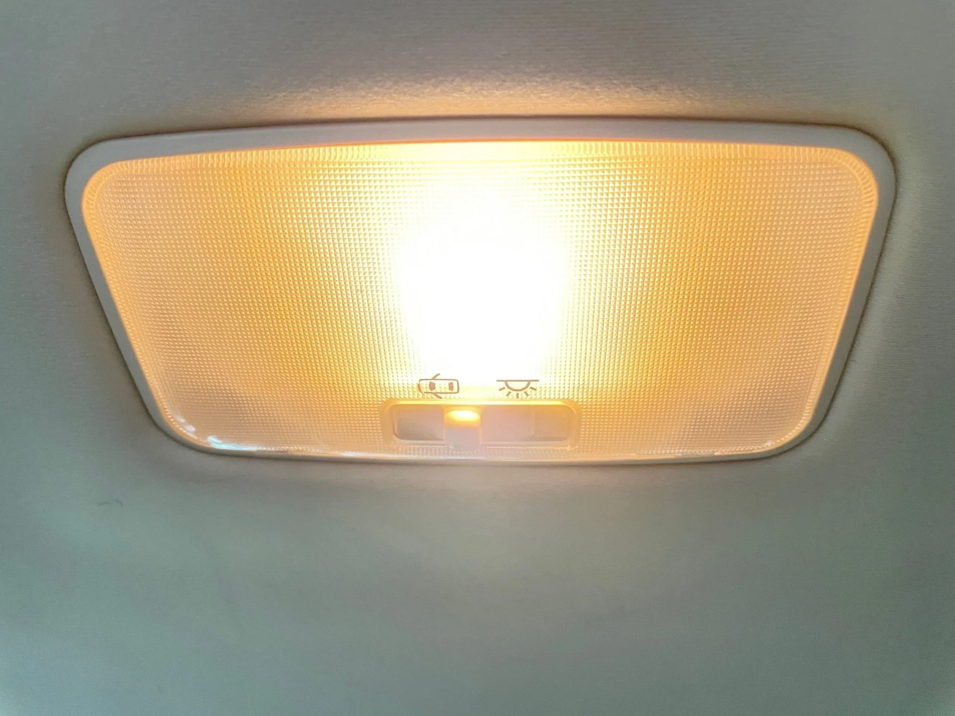

Stock Third Row/Cargo Area overhead light. Pretty dismal output.

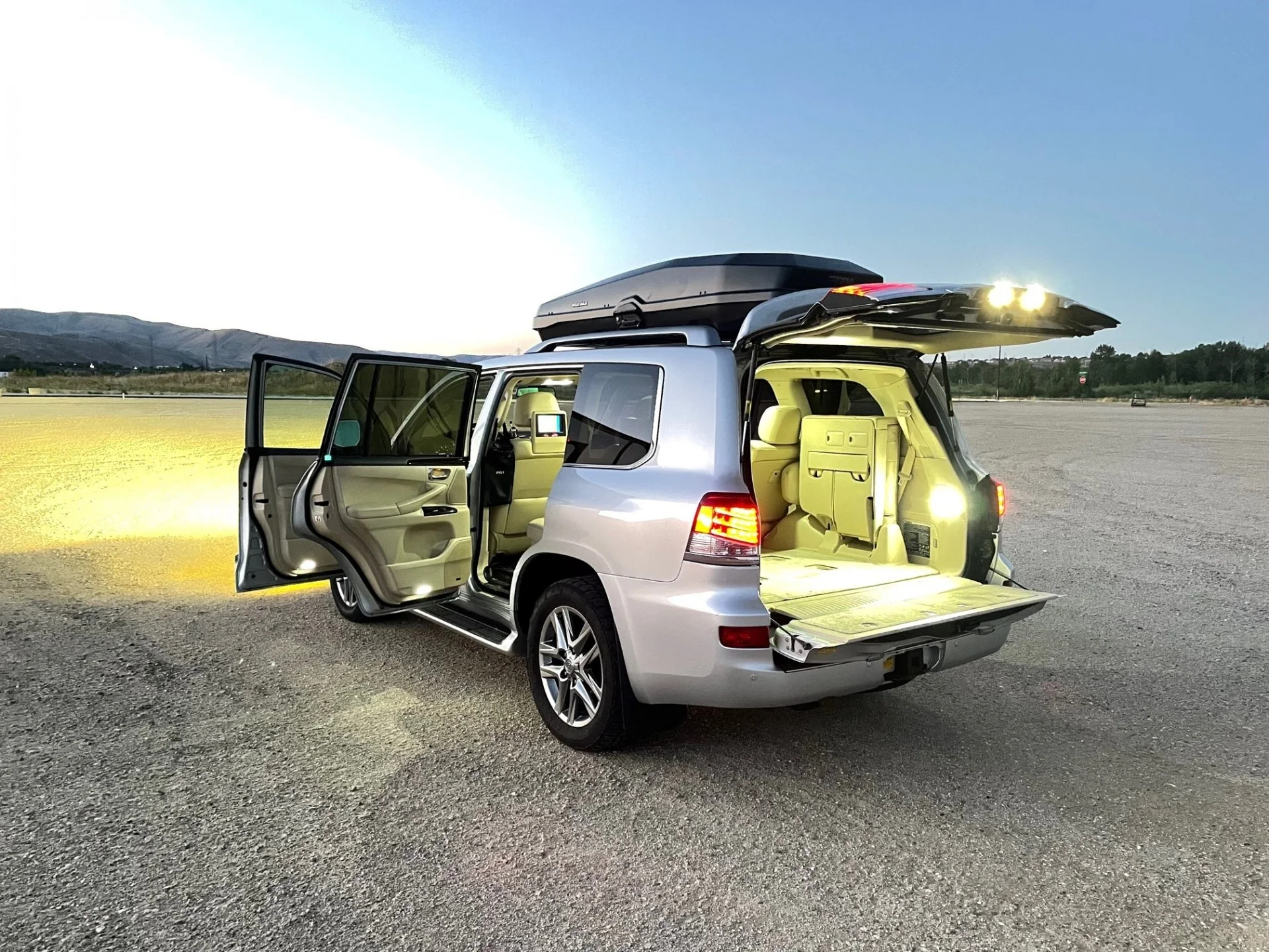

I tried to take these at dusk but the sun was up earlier than expected, but even with some pretty bright morning light you can see these things are a huge improvement over stock. The two LED panels in the cargo area are amazing.

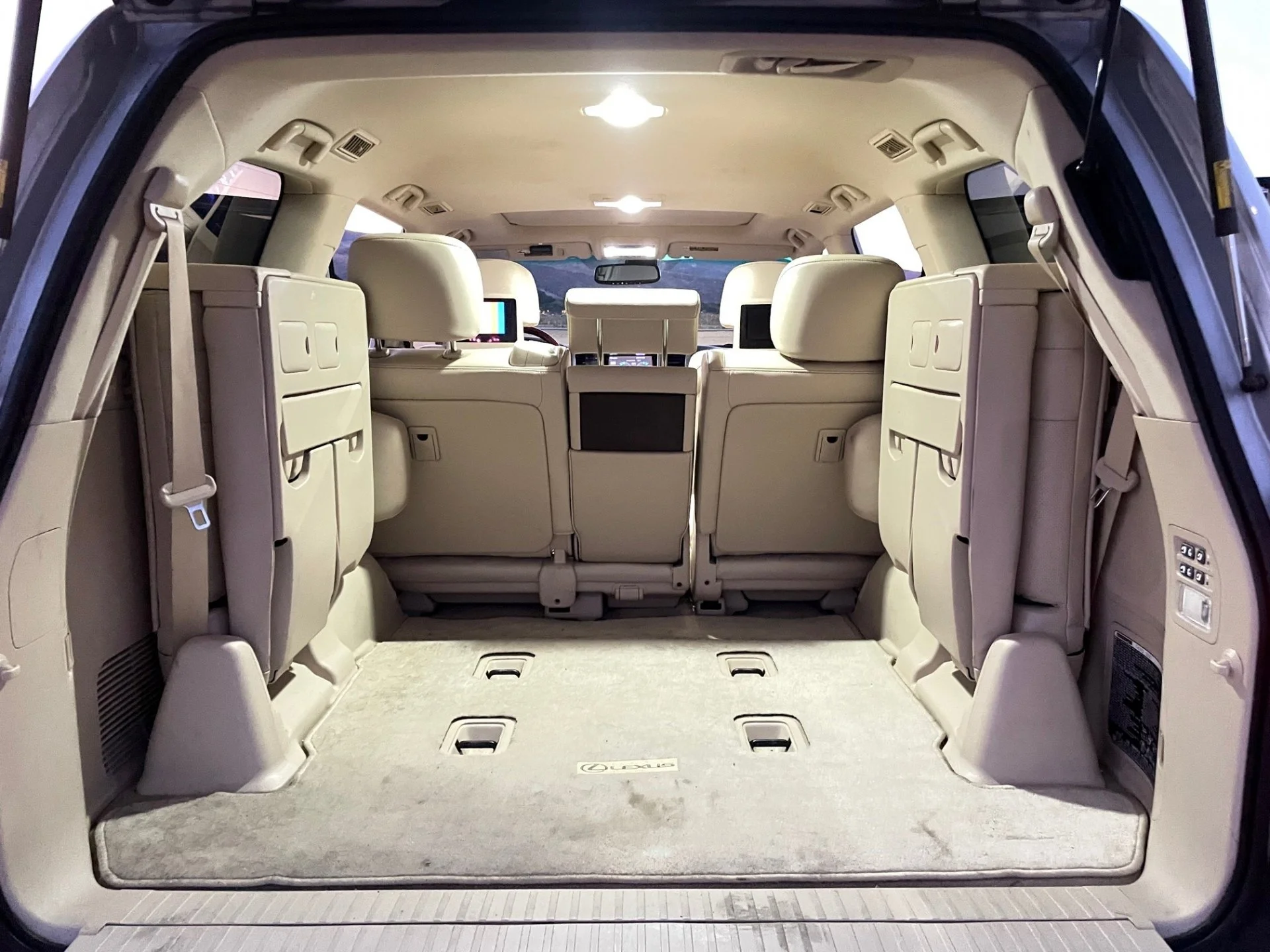

Even with the (previously completely useless) side lamp off the cargo area is MUCH brighter.

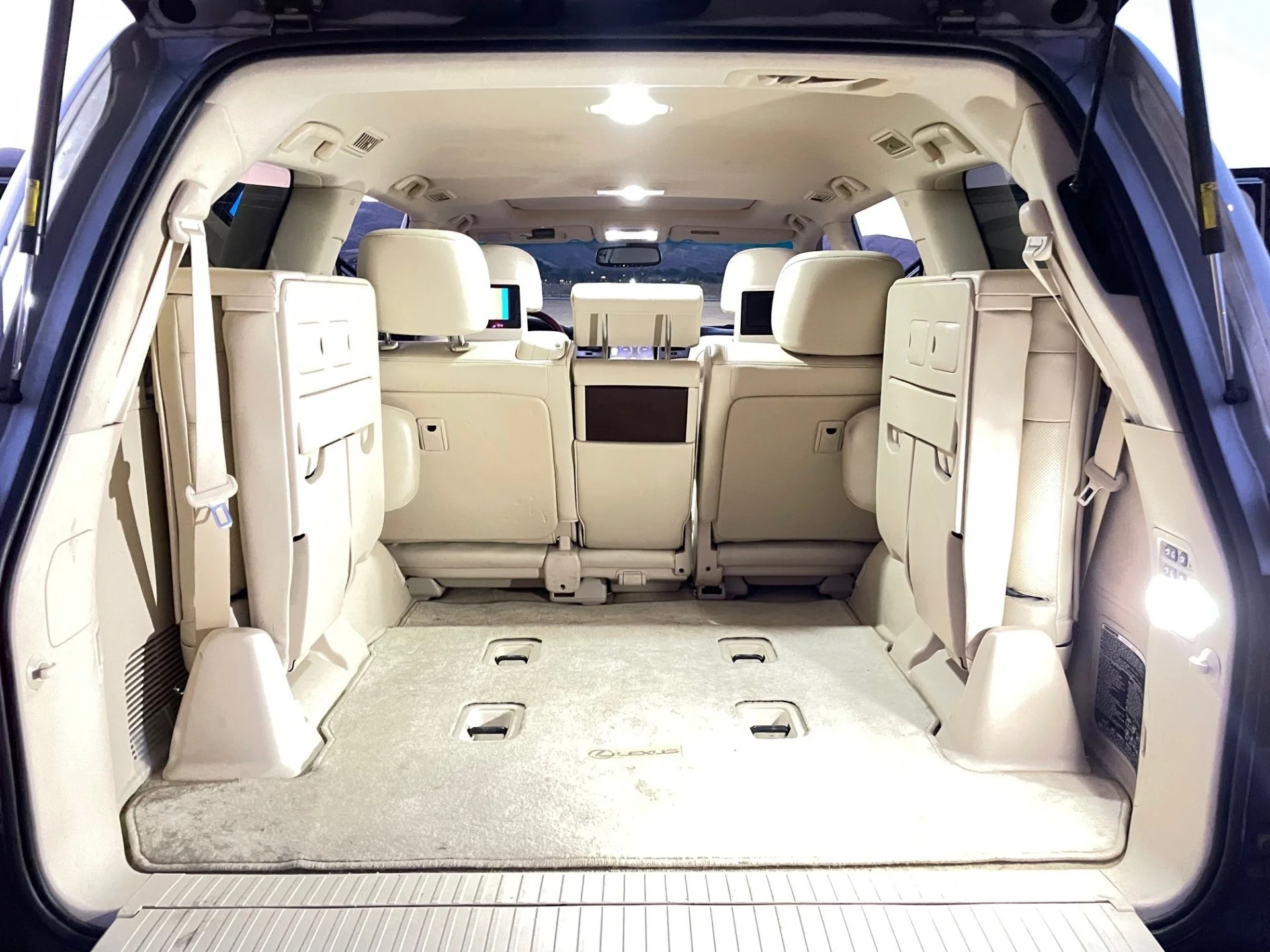

Turn the (now VERY functional) side lamp on and WOW. Massive improvement over stock. The cargo area went from being the area with the worst illumination to the brightest.

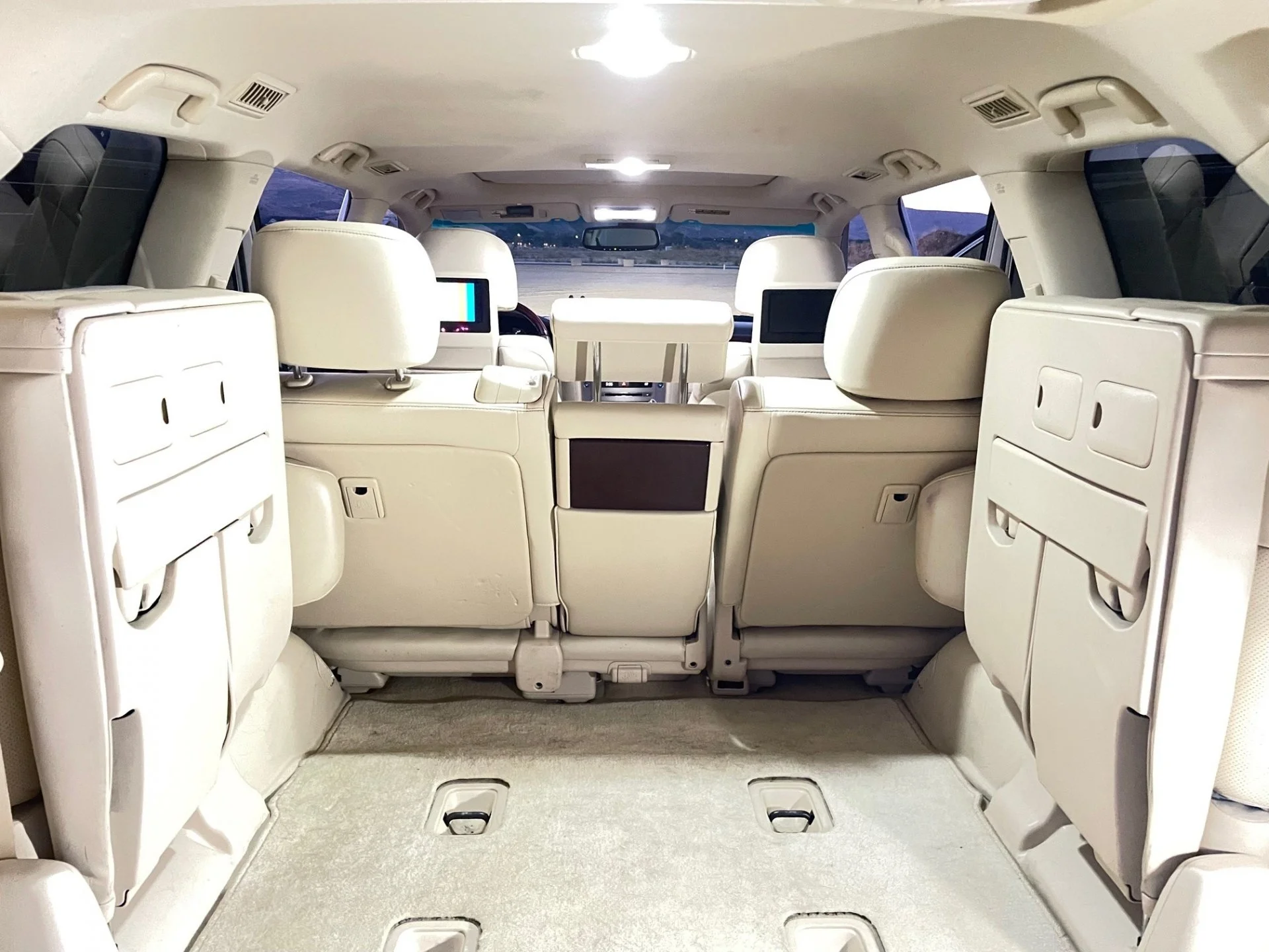

A shot from further back to show the whole vehicle lit up. This photo and the two above are the best examples of what the real world color temperature of the light output looks like.

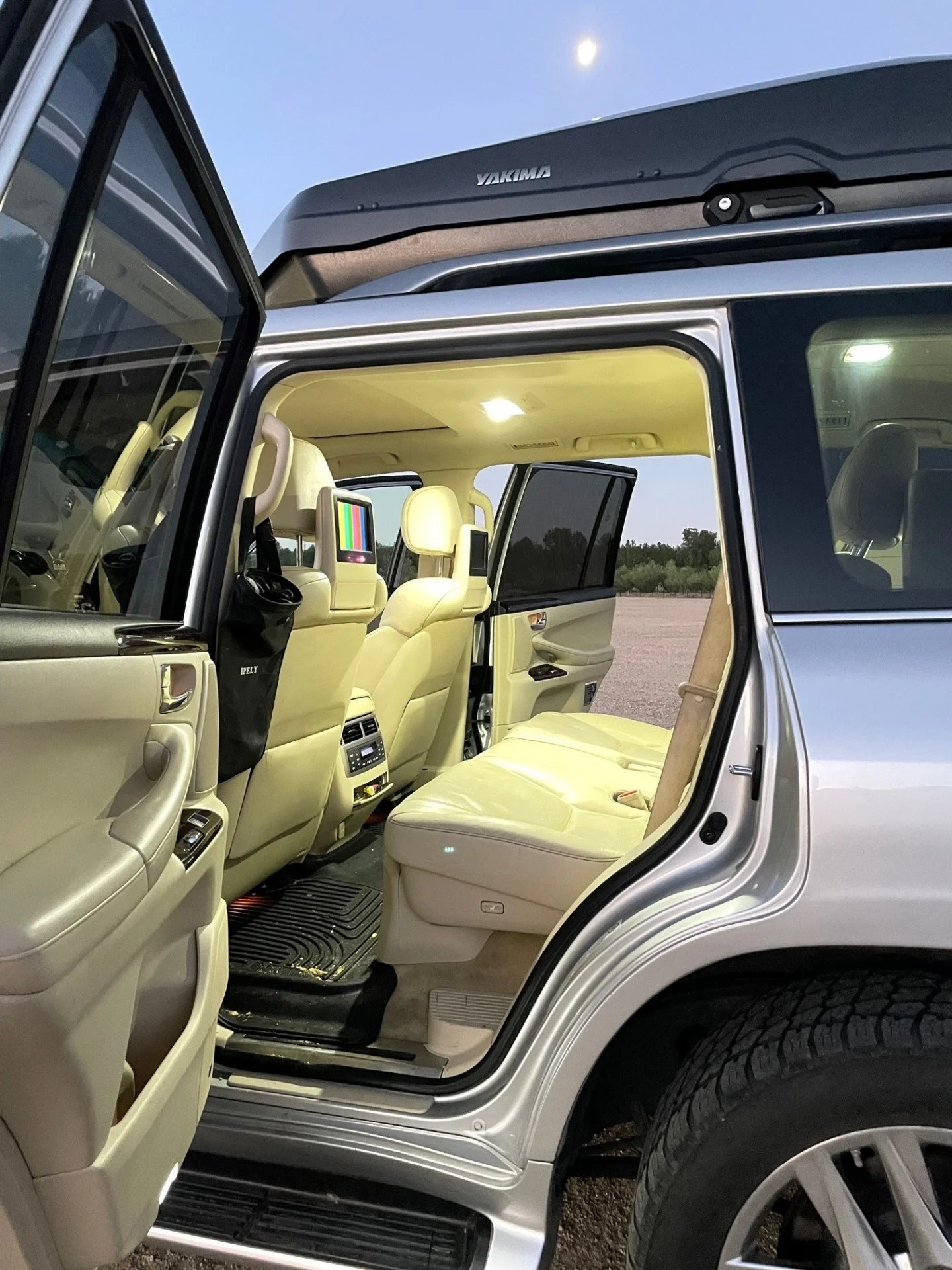

The light looks warmer in this photo than it does in person but the light output in the second row is excellent and matches the stock LED map lights perfectly. On the LX (I can't speak to the LC) the stock map light is a bulb that pokes out into a roughly 1" x 2" cavity that is about 1.5" deep. The replacement for the middle row lamp is a bulb adapter with an LED panel. There is also a plastic guide that sits between the lens and the housing that prevents light bleed between the dome and map lights. You could just let the panel sit on top of the lens but it might rattle around. I initially thought to add a block into the center cavity to attach the panel to but ended up just making a little plastic bridge across the center inset of the light guide part and using the included adhesive backing of the panel to attach to this. My light is nice and centered and won't be moving or rattling. There are probably 100 different ways to secure this panel just something of note as you prepare for the install.
